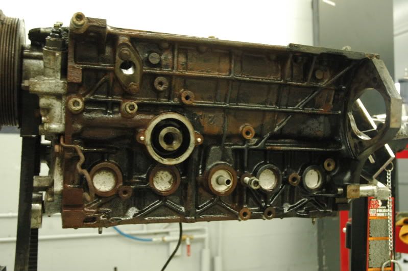

When I was 14 and looking for my first car I wanted a WRX or a 4000 turbo. Little did I know at the time the 4000 was never made in a turbo and the WRX was too much for my budget and insurance would be crazy high. I settled for a mk2 GTI which I still have and too much money and time has been dumped into. Anyway, my 4000 bug never left and I knew it was only a matter of time before I bought one. On August 3rd I bought a clean '87 4000 Quattro on Ebay. I got it for 1250 with a salvage tittle and some sweet stuff.I drove 12 hours round trip to get it with no problems. On with the photos.

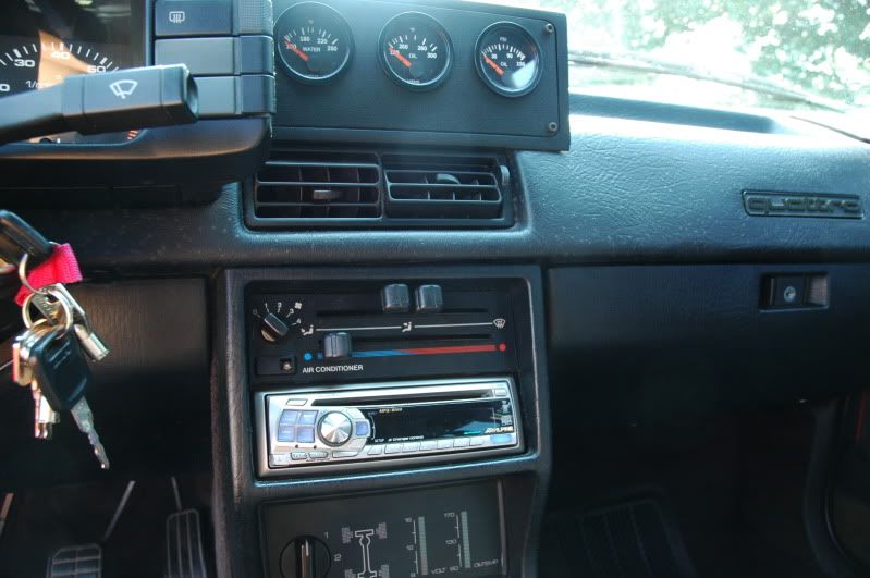

VDO Coolant temp, Oil Temp, Oil Pressure gauges in 034efi pod on dashboard
Power windows (all working)
Power door locks (all working)
Center and rear differential locks (fully functional)
Air conditioning converted to R134a and blows ICE COLD
Quattro script interior
Alpine CDA-9807 CD player

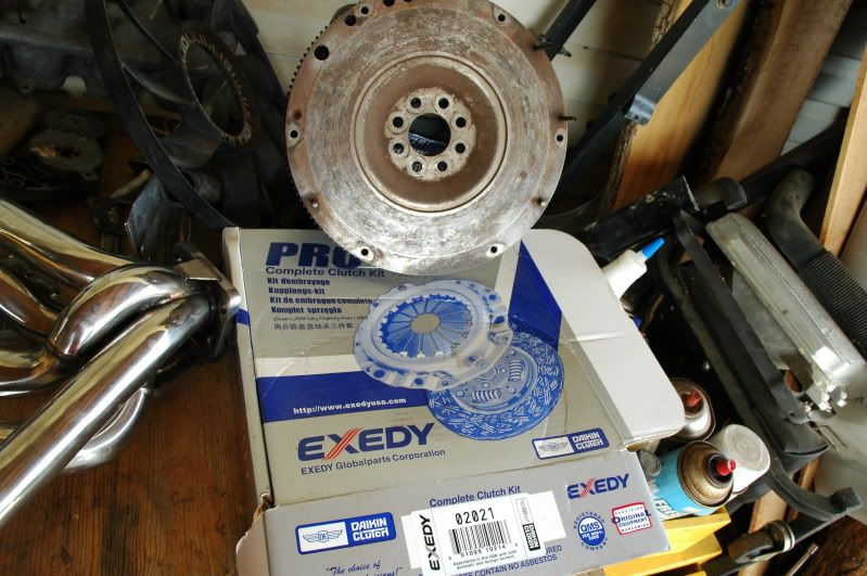

3b flywheel and clutch.
ebay manifold. Welds look good and I could not make one for the price I bought this for.

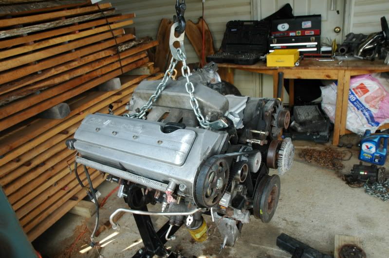

My plan for the car is Megasquirt MS1 COP. I will be using the stock transmission in the 4k. I know it will be a short ratio tranny which is not optimal for this engine but oh well...already sold the S4 tranny. I hope to have the engine in by next summer. It would be in sooner but I am 3 hours away from the car at college. I changed the timing belt, front main seal, waterpump, thermostat, and tensioner.
Need:
Powersteering adapter brackets so I can use the 4k pump.
All the MS stuff.
Shorter serpentine belt (A/C removed)
Rear coolant flange
Intercooler/piping/connectors
Downpipe (will make myself)
7A oil pan and pick up tube. (AAN pan will not work...right?)
This thread will be full of questions and ANY suggestions are greatly appreciated. I want to thank Tim, Dana, and some other guys on the board for answering all my PM questions. Thanks guys!

AAN pan wont work :D

Pick up a 7a one and you'll be good to go. Sweet project man, I will keep a close eye on this!

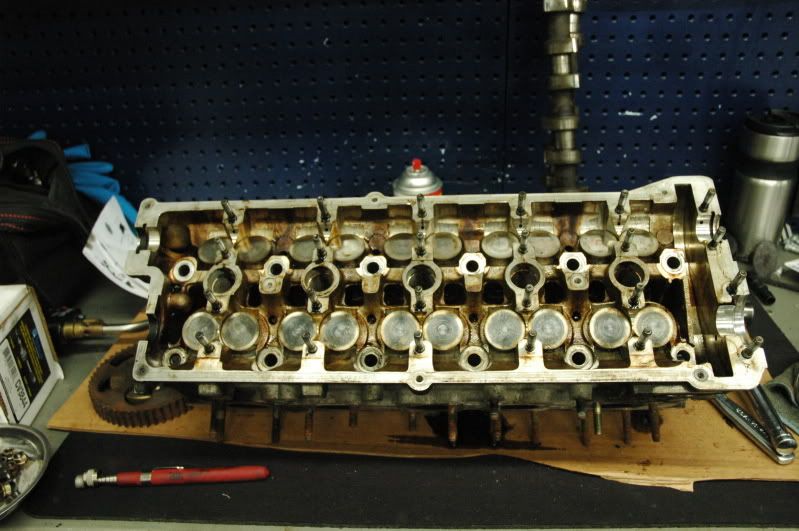

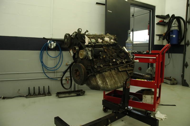

I recently bought and 034 IB controller, Hella 500 lights, Speedline wheels from a CQ, 7A cams, 60-2 trigger crank pulley, VR sensor/bracket (from Derracuda), and new exhaust manifold studs. My Dad drove the car to work one day and says it has no heat and there is standing water in the trunk. I am going to see if the heatercore lines are looped in the engine bay. If not, I guess I need a new heatercore or need to unclog it. As for the water in the trunk, I don't know. I will inspect all the seals and see if any are missing.
Over college winter break I will be cleaning up the AAN engine, do a head gasket job, install 7A cams, figure out how I will mount the 4k P/S pump while retaining the serp. belt, mount the VR sensor/bracket, install the new crank pulley, and maybe put some more Hella lights on the front. For now I am stoked on the 034 efi purchase and getting to drive the piss out of the 10v this winter. :D

Ok, so it has been a long time since I could work on the car since I am 3 hours away from my garage. Being at college has its draw backs.
European Autosports in Kingsport TN is where I am doing the work. Eddie and Allen are nice enough to let me use the extra bay at their shop to work on the engine and their tools, cleaning chemicals, and overall advice. These guys are true enthusiasts that make me proud to be apart of the Audi community.
At first I was just going to bring the engine there to clean up the engine and put the 7A cams in. That changed to taking off the head, doing the head gasket, striping the head to replace valve seals+guides, rear main seal, water manifold seals, all gaskets replaced, steam cleaning oil pan/head/valve cover/other misc parts. I figure it is best to do it right the first time and not need to come back to it multiple times. I learned my lesson on my 16v MKII swap.
The progress you see from the photos is from one full day of work. It went pret
ty smoothly...only breaking 2 bolts that held the plastic guard in the 7A oil pan.
Tomorrow I'm going to pressure test my UrS4 aluminum end tank intercooler that was in the S4 wreck. Hopefully I'll get the block painted, valve guides/seals in, 7A cams in, exhaust manifold studs in, and crank trigger pulley from Derracuda. We'll see. I love having time away from school to get this stuff done. Enough rambling. Photos.

Engine is DONE...aside from some small things to be painted/installed. This was my first engine rebuild. I am proud of the thorough and attention to detail build. Again, thanks to Eddie and Alan at European Autosports for answering all my questions.
Head back from being hot tanked
7A cams in, new valve guides/seals.
New exhaust manifold studs
Head on
While I was hand threading the new head bolts in I noticed one did not go in right. It was wobbling! Turns out VW/Audi sent us a bent bolt.
All back together. Disregard poor paint job on the coil cover. Soon to be re-done.
