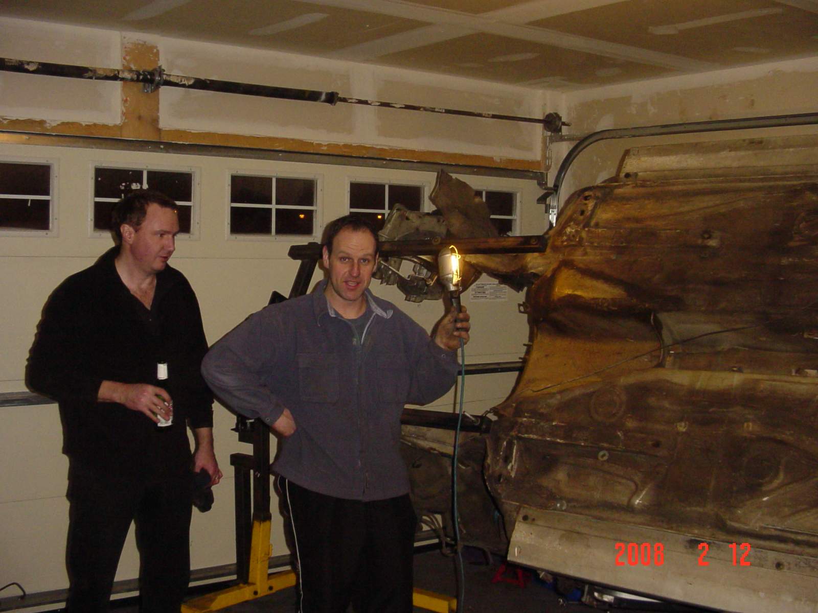

So far Matthew and I have scraped half the insulation from the inside floor.
On the weekend Martin came over with Craig Cook’s rotisserie. After watching the GP, I can’t help feeling Red Bull have blown the driver’s title, by favouring Vettel but that’s another story, we assembled the rotisserie. Craig’s rotisserie works extremely well, but due to a lack of headroom in my garage requires the car is flipped prior to attaching the chassis to the subframe supports.
First the suspension was removed
Then Martin and I lifted the car on to a crawler and Kate stopped the car from falling.
Storing them this way, it looks like I could fit three more ur-qs in my garage?
On it’s roof, attaching rotisserie
Not much room front, back or above...
Lifted up
That was the easy bit, now the hard part

Looks great Mike,
Brings back so many memories of my urq when it was up on the rotissierie.
Before you know it the car will be 320mm shorter and a wee bit wider. :cheers:

The Sunday flip went a lot smoother and easier than when we did mine two years ago... it's been that long.
Must be the the learning curve.. ;)
It doesn't take that long to stip it.. you can easily do 1/4 of the floor per night (2 hours max).
Just get a full face shield, some sort of a hat to keep the stuff out of your hair, ear plugs and nice thick leather gloves.
The grinder with 3" wire cup brush (knotted) goes through it like butter.

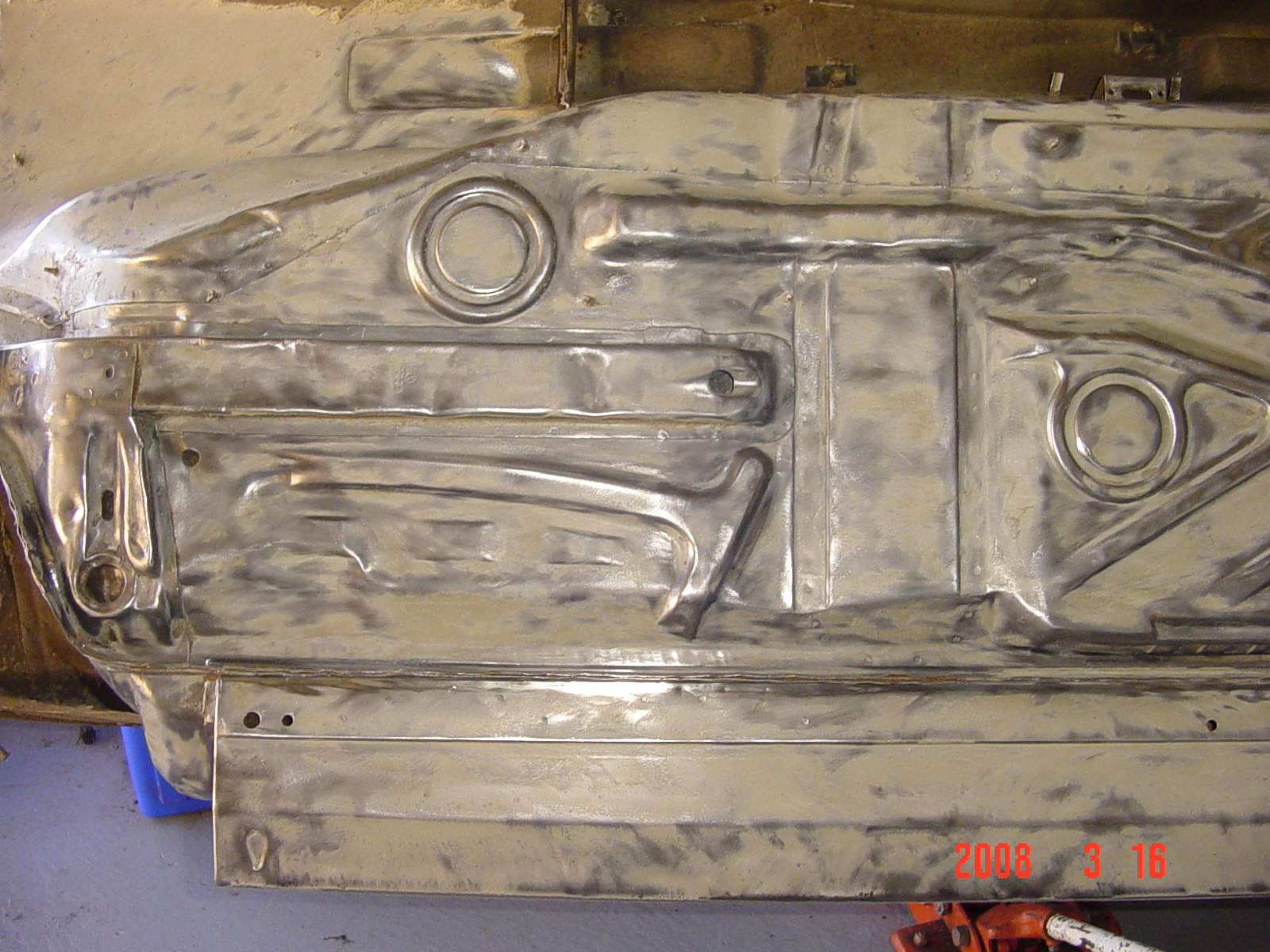

Craig's rotisserie makes working on the floor of the car much more pleasant.
If you can call grinding off underseal a pleasant way of spending time. At least
when the wire bristles come off the wheel on the angle grinder, and hit the
few inches of exposed skin, they are hot enough to coterize the wound on
impact.....
The floor is about half strpped:-
The worst piece of rust on the car is on the rear seat, now there is a bigger man made hole beside it
With the battery box out it will be easier to remove more underseal.....
At this stage I am not sure if I will relocate the battery box on the floor, as per the factory sport or move it to the boot

The floor is done.....
