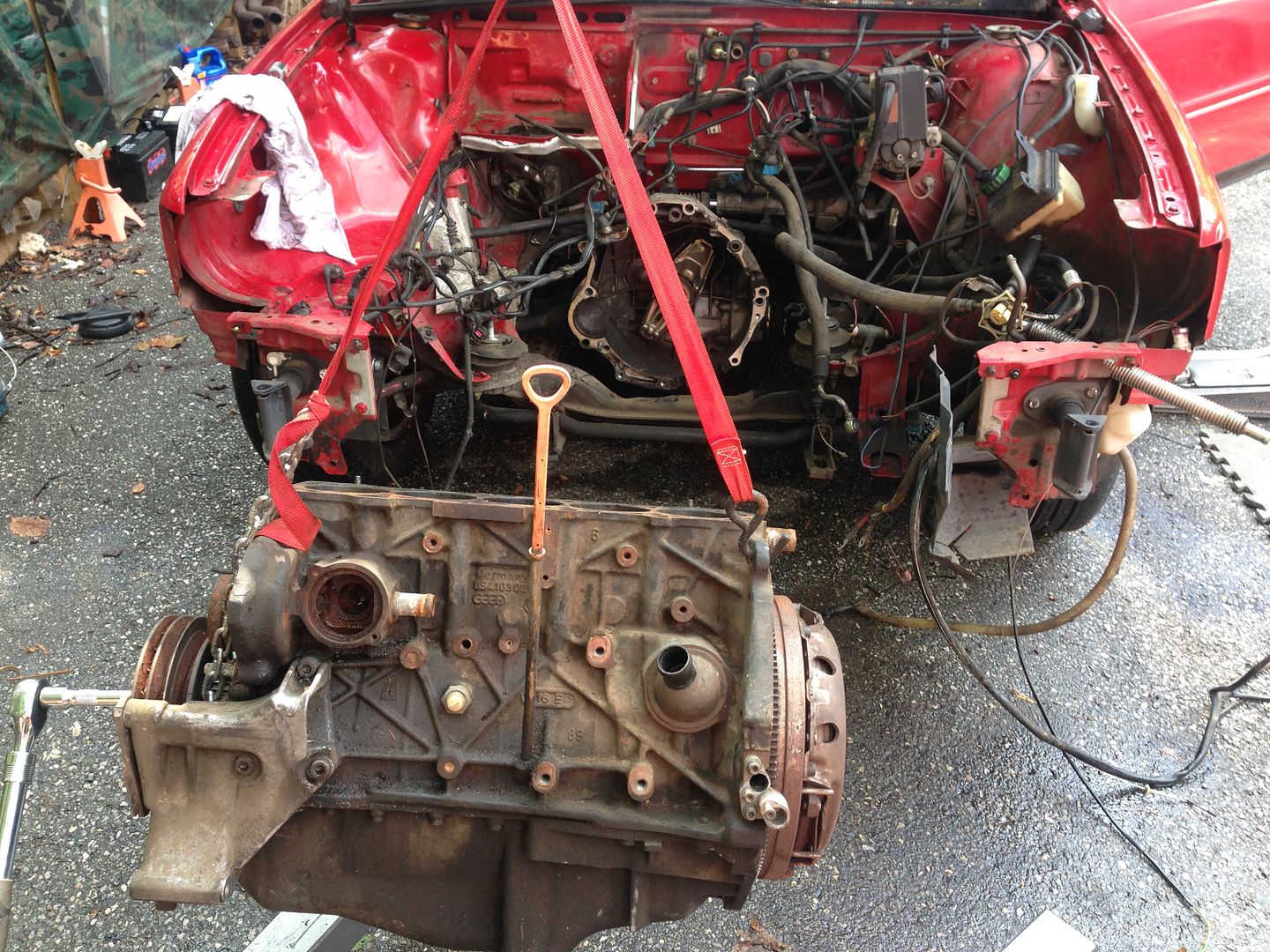

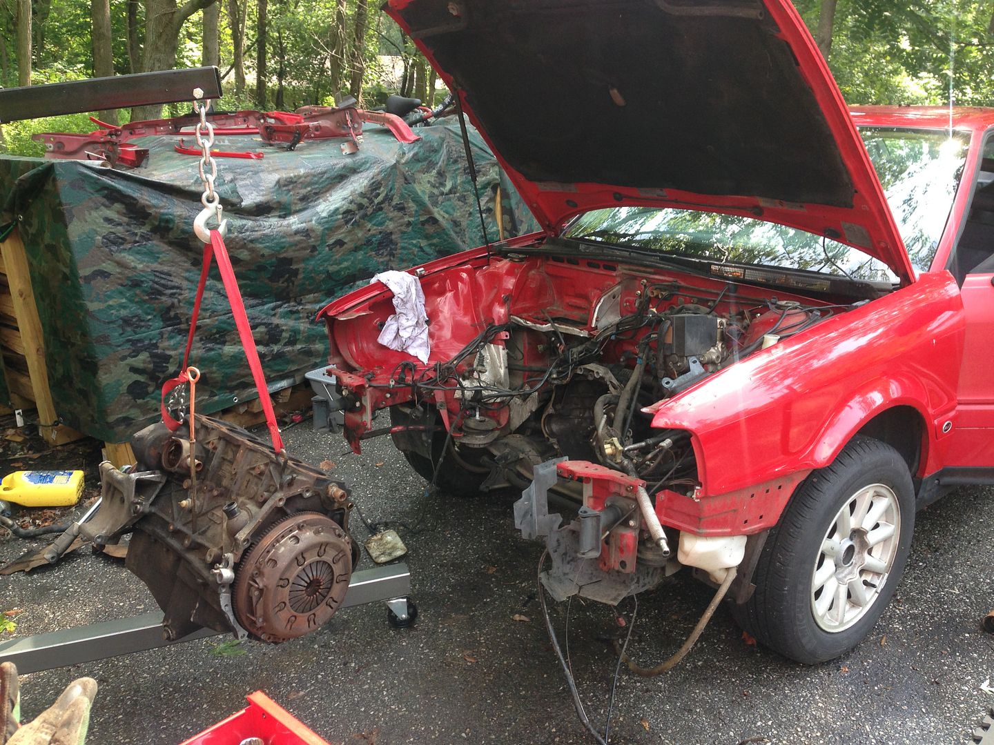

A couple of updates...
Got the old engine pulled...
Made the call on the flywheel setup - I managed to find an unused Fidanza flywheel and the 034 Spacer that I'll need.
Likely to go with a 7A Southbend Stage 2 daily clutch setup with that.
