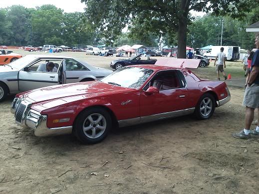

Here is one I found at a local car show
the guy argued with me that is wasnt a fiero. I dont think he like the fact that I was calling his "rare" car a fiero :lol:

that is a Zepher i think they call it and was made using Fiero Chassis and running gear from GM and where produced as there own car so it is and isn't a fiero they also have a car thats called the Meara and even though it is on a Fiero chassis it is a Meara because that is what it was sold as to the public

No this car is called a quicksilver. It was made by a costomer car company in Florida. It is a v6 fiero with a custom body. Looking over the car, it looks like gm gave this company the keys to the parts department. Pretty much everything attached to the body was a gm factory part.
