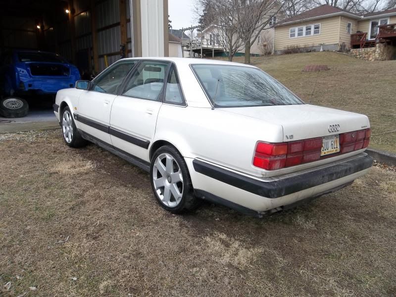

Thanks, they are 18 in Avus wheels off my S4. I had a hoarding problem but I'm better now. I had 3 pearl white V8 5 speeds but kept the one with black sport seats. One went to a kid in Council Bluffs, IA, and the other 5 speed went to Scott Nelson, in California he flew in and drove it home.

Is it on stock suspension, and is there any rubbing (even over big bumps)? I might do exactly this. Wheels on the '93 are bent and the stock S4 wheels are just sitting in the garage.

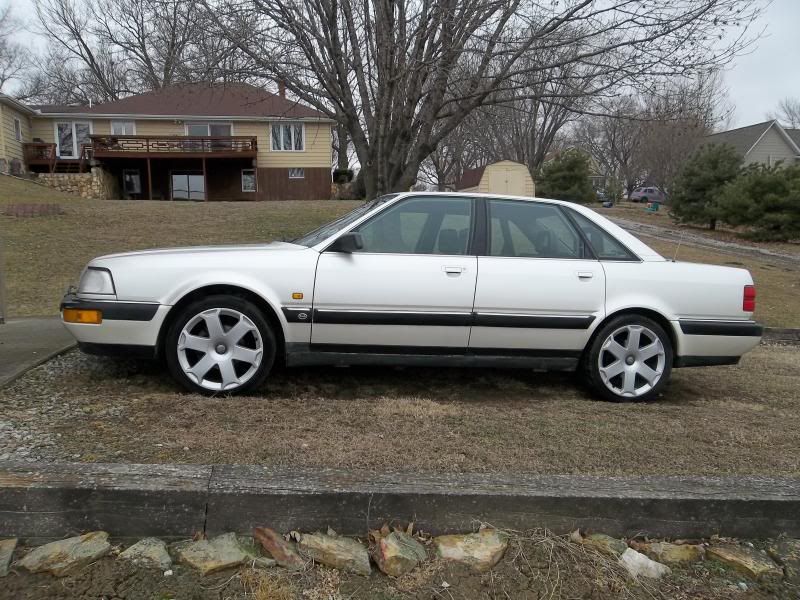

No rubbing, on stock suspension, with stock tires off a 2004 S4. They do look good, but from the front view they tuck in too much and would look much better with spacers to push them out. Still no rubbing though.
The pic shows the car lower than it actually is because I photochopped it to see what it would look like lowered.
front veiw: looks like it could use spacers, but no rubbing as is
Actual ride height, stock suspension, no rubbing:

The V8's have a pretty good amount of room, my winters are 8.0" ET10 F, 8.0" ET15 R with 235s, summers are 9.5" ET30 F, 9.5" ET35 R with 275s (slight rubbing up front)
