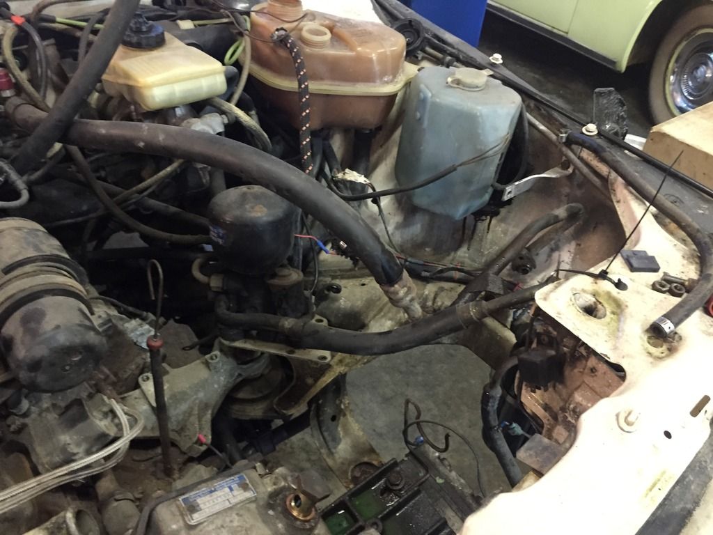

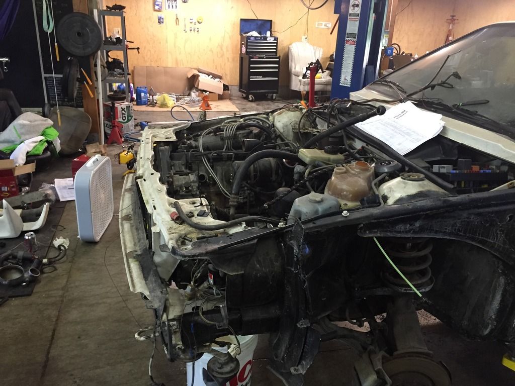

Current state of the engine bay:

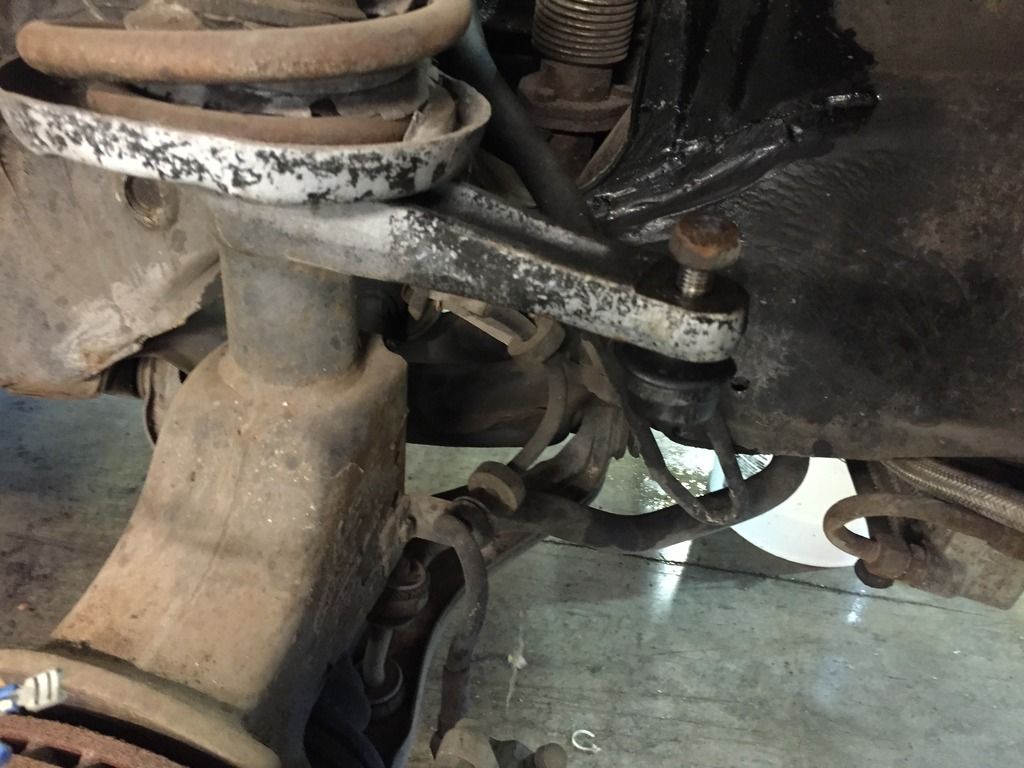

One problem area to note:

Took some time today to work on the car, no power to the windows so I used a wire and battery to roll up the drivers side window so I could push it outside to pressure wash the car...
There looks to be paint yellowish paint overspray over the whole car and windows. Everything except the front fenders since they were off. Not sure how I'm going to get that off.
Started washing until a lightning storm went directly over my house then the power went out. So I got to work pulling the 3B apart by flashlight.
The valves on#2 and #4 have a visible mark where they contacted the pistons. So I'm either going to put new Ferrea valves in this head, or use my spare AAN head with stock valves.
Looks like this plastic cover and the cam gear were the only casualties of the contact on the front pf the engine.

Well this morning I decided I'm done fiddledicking around with CIS.
It's at the point where its going to cost me more money and time to get it up and going with the WX, and my ultimate goal was 3B anyways so I'm proceeding on to that now.
Started getting the CIS out of the way, Radiator out, disconnected drive shaft. Now I'm stuck on tie rods, Seems like there is no way these are coming off. After disconnecting all the fuel lines I didn't feel like using a torch right there but I did everything short of that (with what tools I had)
Going to try and find something for the tie rod. Then get everything out of the engine bay and so some paint touch up.
What's the thought on brake booster conversion to vacuum? Is it necesary? is it a good idea?

For the tie rod connection to the rack, there are nuts below the rack on the bolts that hold the tie rods in. The rack is threaded, and the nuts below act at jam nuts to lock the bolts in place. Remove the nuts below, and then you'll be able to remove the bolts from above.

Congrats on the acquisition and best of luck on the build. If that's your workspace on your property...that's Badass!

Thank you sir. I didnt realize the top was threaded too. However which way I think I still have to get the ends off to drop the suspension out. Suppose I could try to take the inner ends off and go from there. What I think I need is a tie rod/ ball joint separator tool from the auto store. Should make quick work of that.

Thanks buddy. Got really lucky when I found my place, had an empty 3600 SQft shop on it, looked at the house and immediately put in an offer.

Just hit the arm on the strut where the tie rod goes through, try and avoid hitting the boot. A few good whacks and it will fall right out. I assume it's steel like a 4kq. I do this all the time works for ball joints too.
I will try it. But probably going to stop and get the tool anyways if I can remember.

Removed stock 10vt
Painted engine bay (started as what was going to be some "touch up" with a spray can and got out of hand)

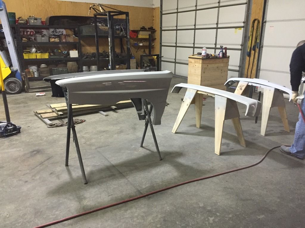

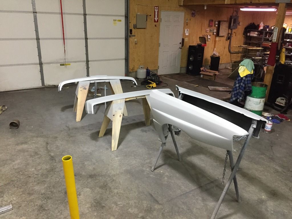

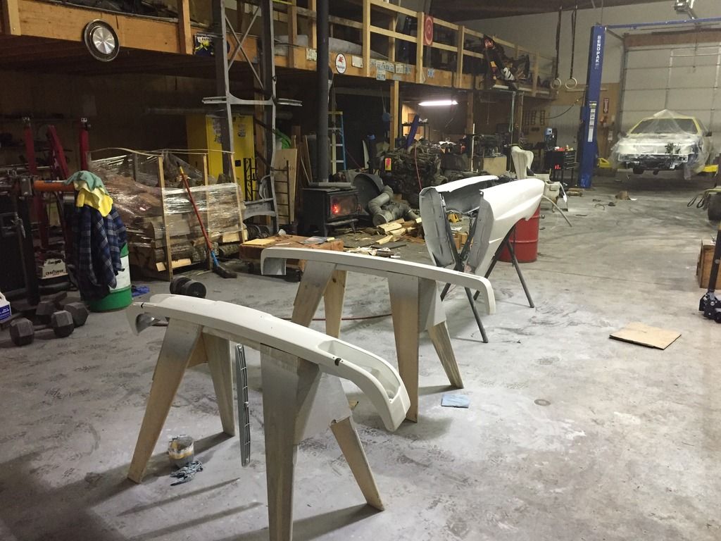

Painted front fenders and euro bumpers

Painting fenders
Painting engine Bay
This is what happens when you think "I'll find a can or aerosol paint to touch up the engine bay a bit."
The result is a complete respray of the engine bay in factory color.
Engine bay was completely sanded and prepped for days, then wiped down with dirt and grease remover, wiped dry, blown dry.
Then wiped down with a tack rag. Then sprayed in sealer.
Coated in factory paint.

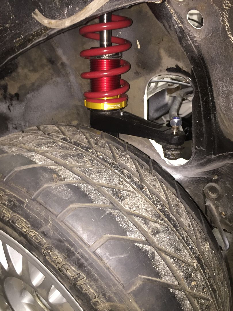

Had to get the car moved off the lift to do something to my 4000, so time to get the suspension on.
Extracting a broken bolt for the rear ball joint
Completed strut
In the car
Spherical Comp Brake mounts from Marc. These are awesome
