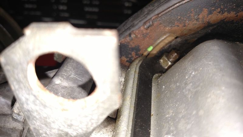

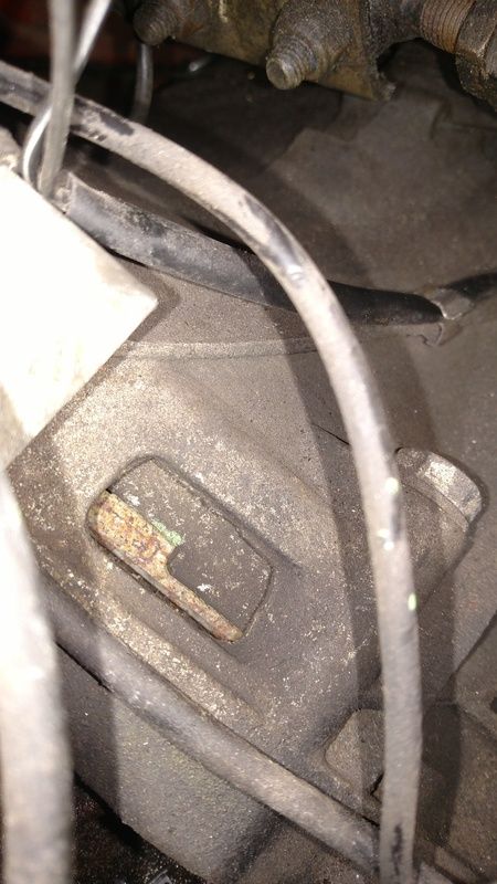

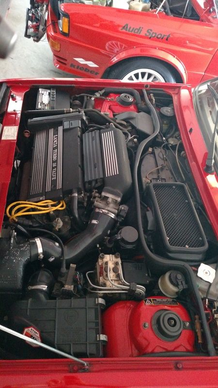

Well, it's been quite a while since my last update and have a bit to share for anyone who reads this.
First off, I picked up another one of my idol cars. It's a 1991 Lancia Delta Integrale 16v! It's in fantastic shape and couldn't be happier with it.
Also, the quattro won Best in Show and the New German Performance Speed and Style award at the 2016 VAG Fest in York, PA. Very surprised with that. To me, I put in all the time and money not to win shows, but to keep these awesome pieces of history available for people to see in person and not just on the internet. If I can convert just one person to a rally fan when I take it out, then it's all worth it.
So thats the good news. On to the Bad news.
The quattro has been dead in the water for a few months now. It will crank but not start. I'm getting the "maverick" spark. I'm in the process (slowly) of going through the wiring and sensors on the engine. Phil Payne's website is proving quite invaluable.
mechanical timing checked, all seems to be fine
RPM sensor checked, seems to be working fine
Ignition switch replaced (again) with not a cheap Chinese unit
Intake air temp checked, seems fine
TDC sensor seems to be working fine too
New distributor rotor, cap
Hall sensor plastic is broken coming out of the distributor- new hall sensor on order
I'll be replacing all the vacuum lines this weekend as well
I'm very close to saying screw it and just go full standalone ECU, EFI and ignition. This has been my plan all along. The car has been running great so it really was never in the forefront. Now that I'm having these issues, its certainly swaying me towards that. The car is not stock. It hasn't been stock for over 30 years. Does a part of me want a fully stock urQ? YES, but I also love this car and realize it will never be a stock urQ again so I don't feel bad about changing things on it (to make it more reliable.)

Congrats on the Lancia!
Japanese market car, those are the best to get.
I had a '91 for a little while, amazing cars.
Mine had too many skeletons in the closet so I let it go.
This delta may have been owned previously by a member here ;). Interestingly enough, the delta and my quattro were owned by the same person about 6 years ago! Unfortunately, he is no longer with us. :( It's a great car. I understand all the Lancia hype now.

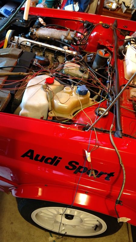

It's going to get worse before it gets better. Started working on the harness tonight. Most of it will no longer be needed.

 Post subject: Re: 81' Rally Ur Quattro
PostPosted: Wed Dec 28, 2016 5:25 pm
Joined: Tue Aug 03, 2010 7:42 am
Posts: 219
More coming out! Keeping only a few wires from the old harness.
PostPosted: Wed Dec 28, 2016 5:48 pm
Joined: Wed Jun 01, 2011 4:55 am
Posts: 307
Looks so much better already.

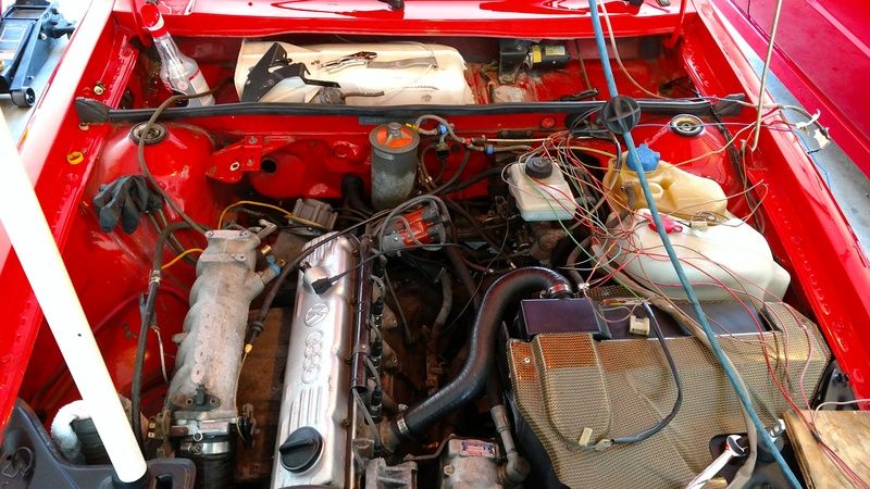

PostPosted: Wed Dec 28, 2016 5:54 pm
Posts: 3865
It's amazing how much space the CIS takes up! The next fun part will be fitting all the EFI parts.
I don't recall you having installed an intake spacer, I'm not sure on UrQ engine, but I needed one on my MC.
Yes, you are right. I haven't fitted a phenolic spacer yet. I'm thinking I might get one anyway just for a little extra clearance.
Next up,
Remove intake manifold
Remove injector seats
Figure out what new injector seats will work
Install EFI components
Done
That easy right? ;)
PostPosted: Mon Jan 09, 2017 8:10 pm
Posts: 219
Injector seats are a bit tricky. 034 doesn't sell the EFI ones for the solid lifter head anymore. The digifont ones do not fit- too small. Luckily, EFI express is helping me find a solution to this problem.
In the mean time, I've finally installed that nice rally valve cover I bought last year. Had an oil cap bung welded on. Also test fitted the fuel rail and will start building the fuel lines this week.
I will have to tweak the throttle cable mount just a bit to fit.
