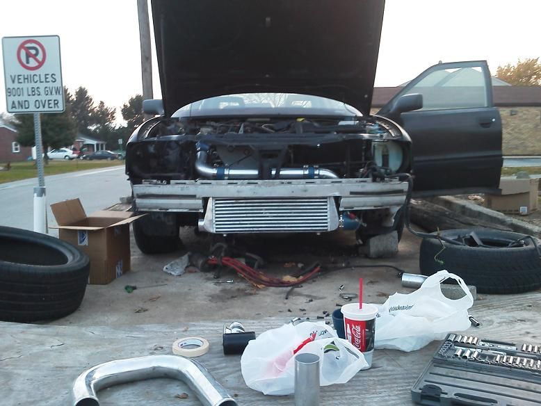

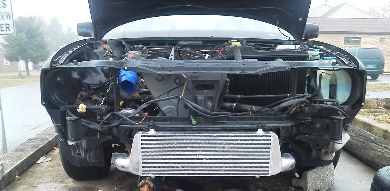

Starting to look into intercoolers and stuff , these are my two choices .

The larger intercooler looks like the one I'm running on my B3. Had to make some serious room behind the bumper to fit it in there! I also had to weld on some cast tight 90°s to clear other things. Hopefully it fits a little easier on this.
So to get the larger one to work, I'd have to at a minimum, 1) cut and modify the upper core support piece and 2) chop off the Inlet and outlet and rotate them so they face the rear

That's basically what I had to do.
For my next setup, I want to make a custom cross member with the boost piping integrated in it.
