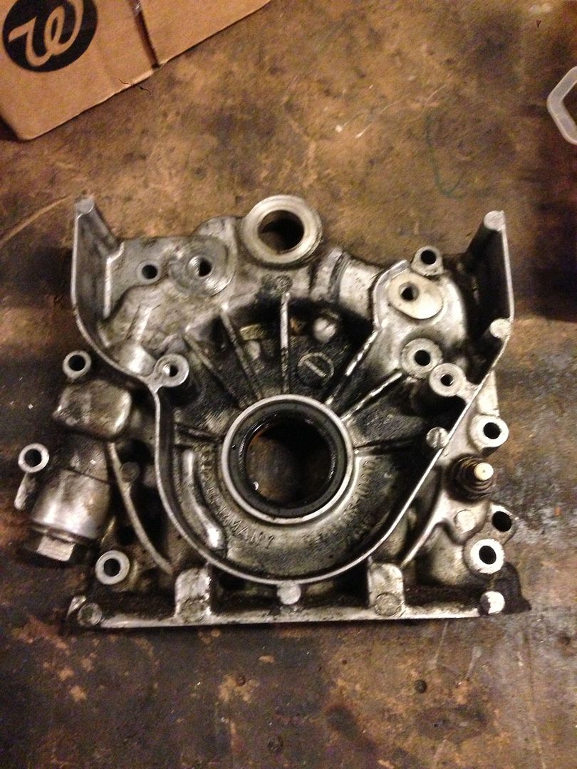

The oil pump is indeed crank driven and looks like this...
Ok, thanks for the info guys. Sounds like it might be more of a pain than it is worth......
