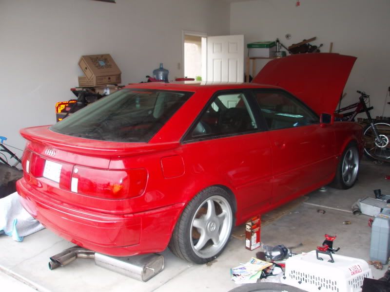

heres the car.....
since no one bought it, I am left with no other option but to hammer it our and enjoy what I had begun......now there is no more excuse for my wife, i gotta do what I got to do..... :woowoo:

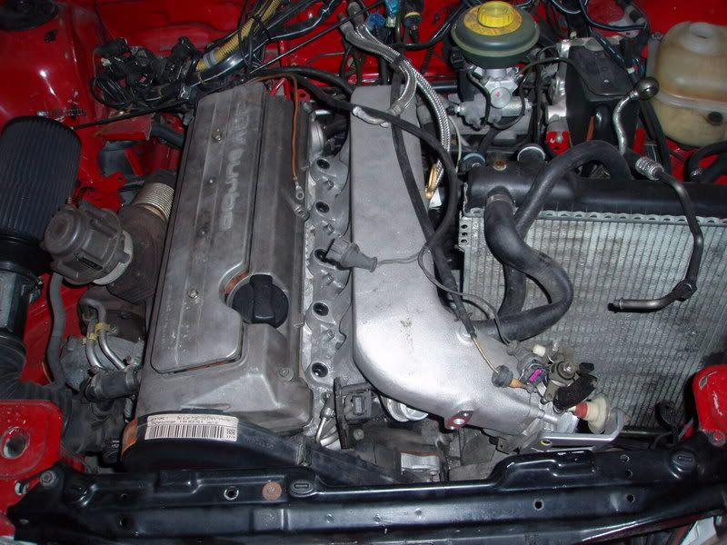

I'm awaiting the aan harness and puter,
along with a need to purchase 034 throttle body adapter for their manifold to clear the stock powersteering pump location...........so I can use the stock serp belt setup....
I would like to go electric pump to clear the clutter, but I'm just doing necessities to get it running right now.....

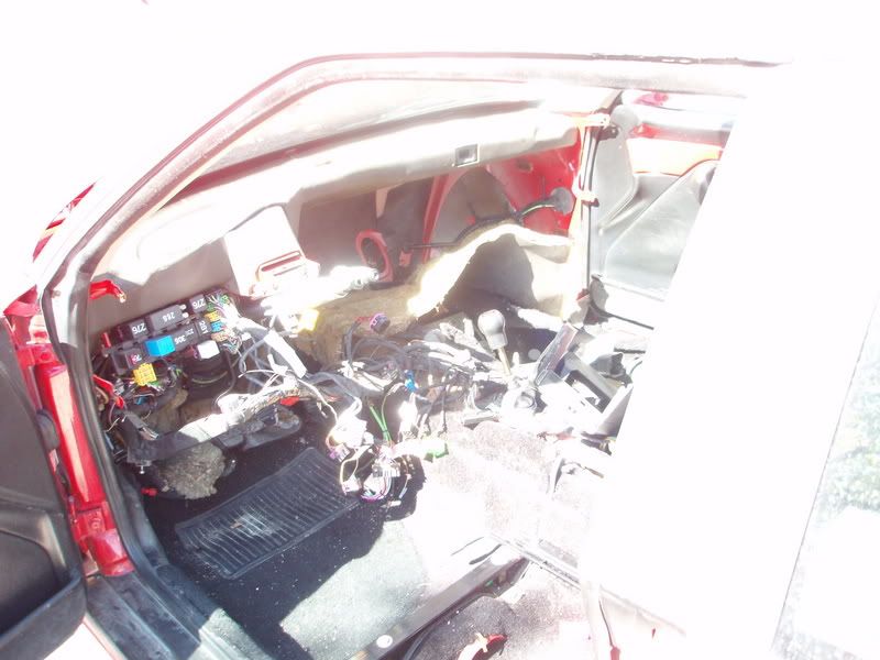

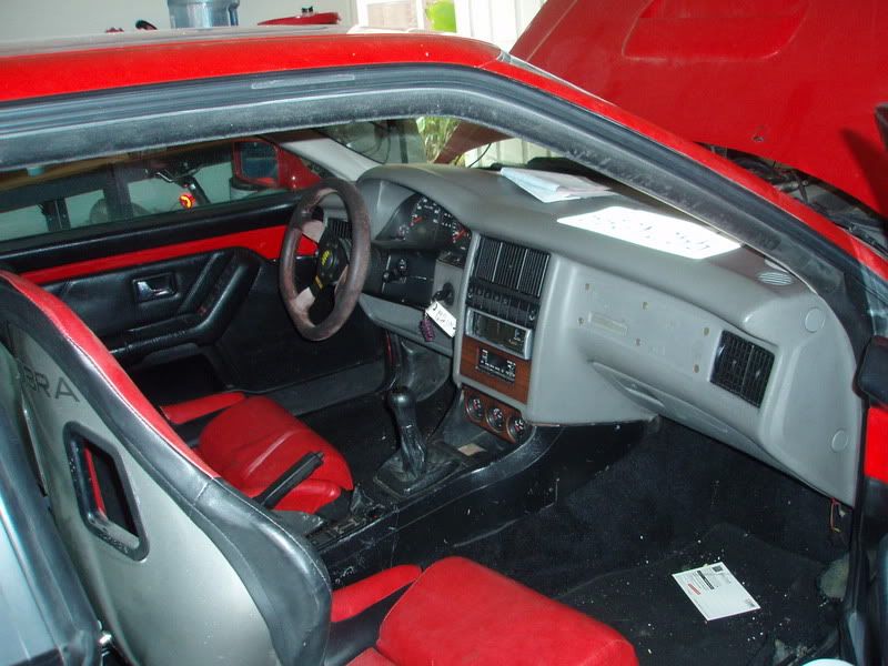

got the dash out and the climate box in the downtime awaiting the harness........
and since the dash is out i've got a black dash on its way to match the rest of the black interior....thanks RJ......

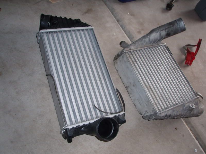

I started to work on the intercoolers to figure out which one to use and to see if I can salvage the endtanks since I'm on a budget.......

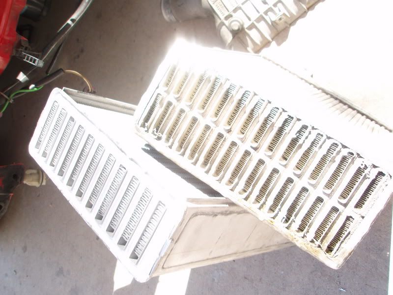

chopped off the endtanks and trying to decide which one to use....
got a bit deep on one, but didn't hurt anything.... :eek:....
the tanks off the porsche gt2 intercooler will fit on the other one,
I'd like to use it because it will fill in the bumper a bit more visually, but the gt2 core looks a lot more quality........much wider also.......
any imput? :thumbsup:

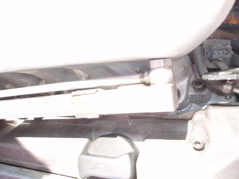

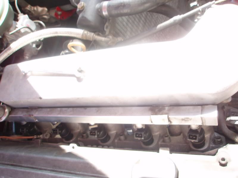

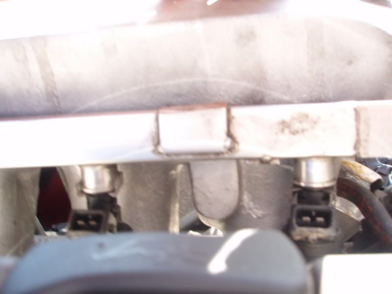

since the aan fuel rail didn't fit with the manifold, I chopped off some brackets so it fits, with the fuel line unscrewed.......... don't worry, i'm gonna clean up all the cutting later..........
so can I just chop off the end and flip it over and reweld it so the line sits on the outside of the rail? also,
do I just weld tabs to the fuel rail to tap into the manifold?

i'd use the bigger IC, got a welding shop around there that could weld it up for ya? maybe if you took off he IM and fuel rail and take it to them, they could probably make that fit with out much of a fuss.

since I already have the aan rail, i'm just going to chop it and reweld and see what happens...I think the 3b rail has the fuel line attachment on the other side compared to the aan one, which would be nice, but i'm making due with what I can....no one has redflagged me, so I'm going for it........
I don't know which intercooler is the bigger one....
they are both 8 in tall, one core is 15 in long, the other is 12,
the shorter one is 3.2 in thick and the other is 2.8....
the thicker one has many intricate cooling paths while the other has a simple cooling channel.....
which one will cool better? I'm assuming the fatter one with all the paths, but not certain....

#13 ·
s2 on the way said:
the longer one would look better...it would fill out the opening more....both will fit fine behind the bumper....

looks good.....much bigger than the intercooler that I am gonna be using.......
I was thinking to cut into the front crossmember and have the intercooler sit in it...but I guess it will fit fine in front like yours.....
