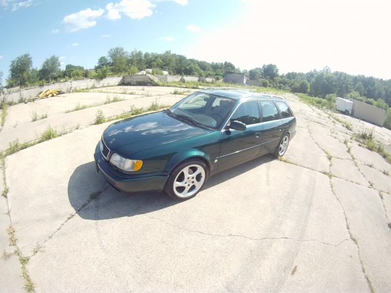

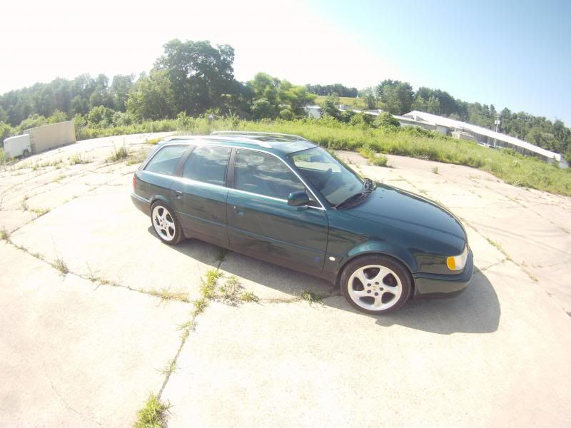

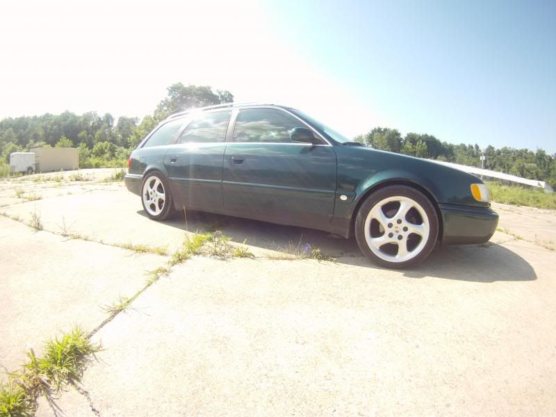

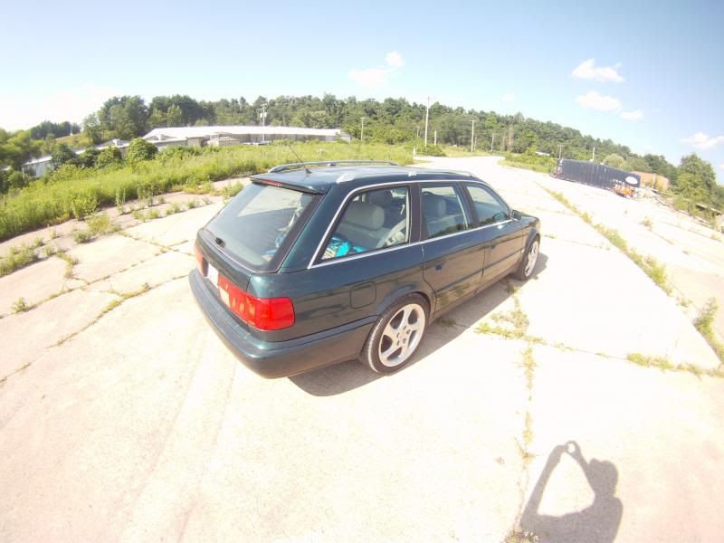

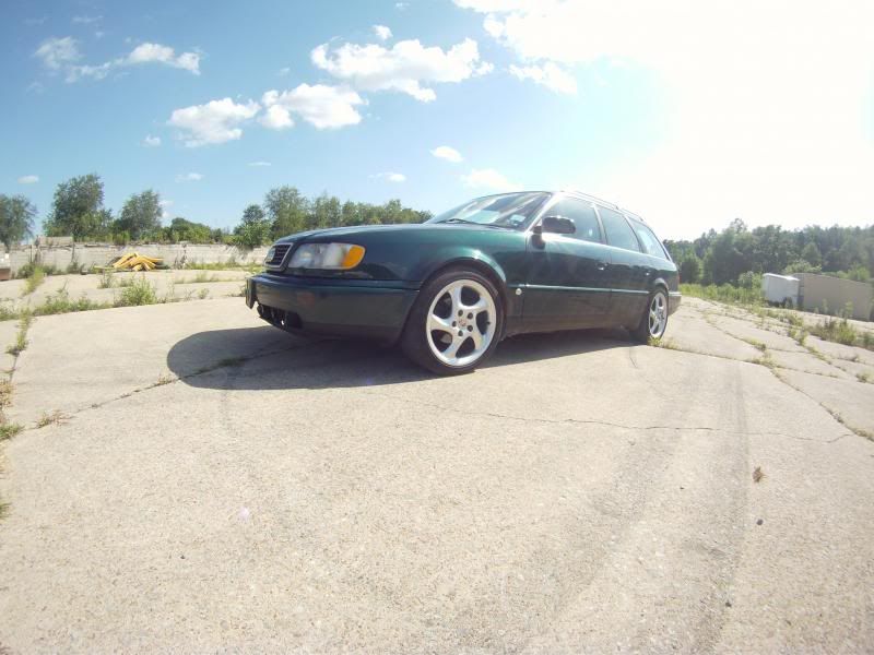

Thats what i figured too, that just makes the car cheaper for me to buy since it need a turbo and a diverter valve. my buddys are already trying to talk me into putting an RS2 kit on it lol. i just want it to drive and have working air conditioning for now. i put 18in porsche twists that i bought off some junky for dirt cheap on it today and now it looks and feels awesome. i didnt think a 245/40/18 would fit under it being lowered but they do. plus i have H&R trak + 30mm adapters in front and 40mm in the rear. everything fits perfect and absolutely zero rubbing.rogermoz said:Nice it sounds like the bad diverter valve may have caused the turbo to prematurely wear if it's been like that a while....vwnut8392 said:thats what i did pretty much. i took an old vw rabbit harness and removed all the pins i needed and replaced the bad pins in the S6's connector with the rabbit harness pins. some solder and shrink wrap for now should keep it from messing up again. the car runs again and it runs good. i also found that the spark plugs where gapped wrong, they where at like double the normal gap. also after driving the car the turbo is a bit tired and it makes humming noises so i think the compressor wheel is messed up. the diverter valve is shot as its not opening and back-spooling the turbo. i have a K24 with like 60,000 miles on it and a good forge splitr valve to fix that mess. i have the S4 aluminum cross over pipe and aluminum tanked intercooler too that i might as well toss on even though i want to put a front mount in it and just be done with it. i have a good 31X12X3 bar and plate ebay cooler but i just dont see a purpose in buying the materials to build intercooler pipes and install it yet as a big cooler like that is a bit over kill for a mostly stock AAN.
