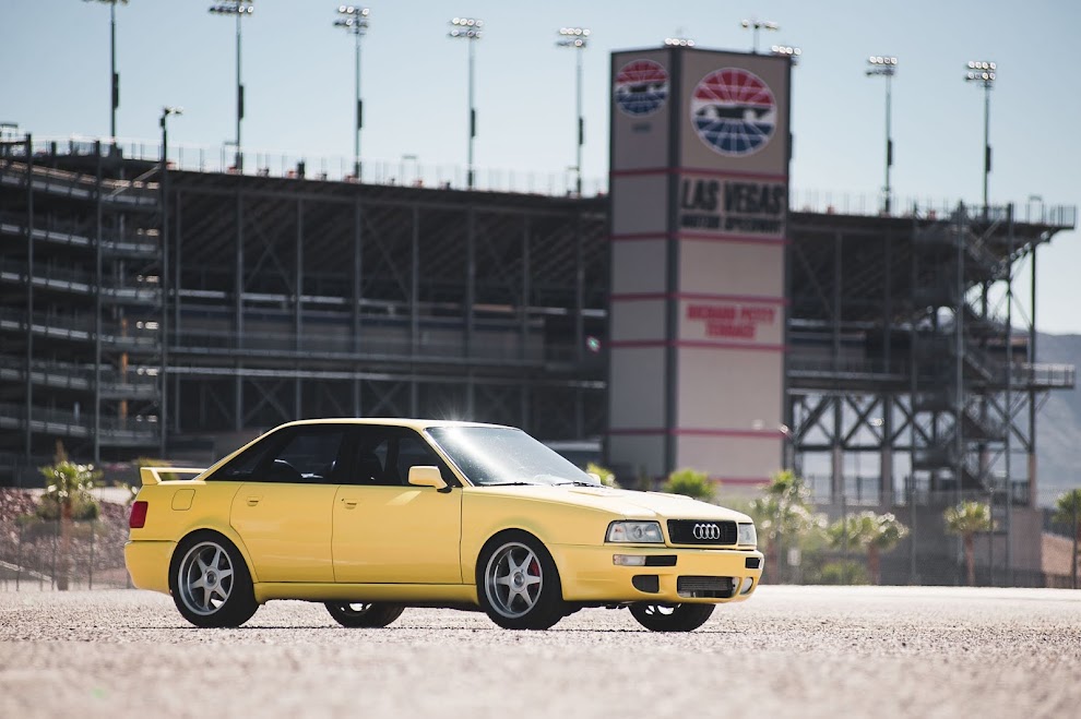

:Update: I will be slowly adding the most recent pics and links to various stages of the project on this first page:
Fender Project
B5 S4 side skirts mounting tabs shaved, stock length of 73.25" fits perfect
- http://www.motorgeek.com/viewtopic.php?f=6&t=7118&start=1663
UrS4/6 front fender flares on all 4 corners.
- http://www.motorgeek.com/viewtopic.php?f=6&t=7118&start=1884
RS2 Fiberglass front bumper
S2 Rear bumper
