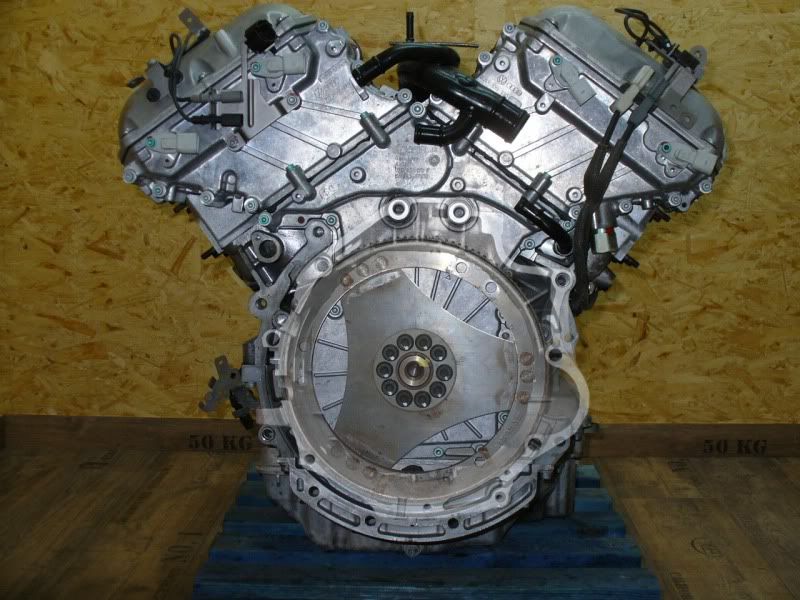

I've found this photo but can't identify the transmission yet... Anyone?

Looks like Boxster 01E.

I cant confirm the tranny, but the body looks like a Type 147 Fridolin . .there was a great build thread on this link http://www.volksforum.com with a W-12 and other great tidbits..

That box appears to be an 0A2 from a FWD diesel 2.7 or 3.0. (very similar to a Boxster S box).
The First generation of W12's had crankshaft issues, something like 70-80% of the crankshafts broke between the #7 and #8 rod journals. I'd stay away from those.
I believe the W12 to have the same bolt pattern as the V10, RS6, and Rs4 V8 engines meaning it won't bolt to an 01E, and judging by the picture above it won't bolt up to the 0A2 either. (note an B7 RS4 gearbox may work).
The W12 was also installed in the Bentley continental and continental GT, but with a pair of turbos.

I'll have a look into B7 RS4 transmissions and try to get some more photos of the flywheel end of the W12 as that's going to give me the most info.

I looked seriously into this conversion last year. There was a Phaeton W12 that came up for sale at a VW dealer. It was 100% brand new, and included all 4 downpipes with cat converters, 8 O2 sensors, both electronic throttle bodies, A/C compressor, alternator, P/S pump, coil packs, wiring harnesses, factory warranty, you name it. They were pretty anxious to sell it, and probably would have let it go for less than $5K. I was even looking to sell all of the stuff I didn't need (O2 sensors, cats, throttle bodies, etc.) and make some of that money back. Anyway, after doing a lot of research, I determined that it probably wasn't something I could pull off. For me, the deciding factor was the lack of a suitable manual transmission.
I was hoping that the W8 transmissions would bolt up, but they're typical 01Es, and wouldn't be a direct fit. Here is a pic I photo-shopped of how a 016 might bolt up to the engine:
As you can see, not enough of the bolt holes line up. There are probably other ways to make it fit, including some factory spacers that might work, but I couldn't see spending $5K on a motor, and not know FOR SURE whether or not it would work.

Looking at the photo, I can see fitting a manual transmission (along with clutch and flywheel) being one of the biggest headaches with the W12.
