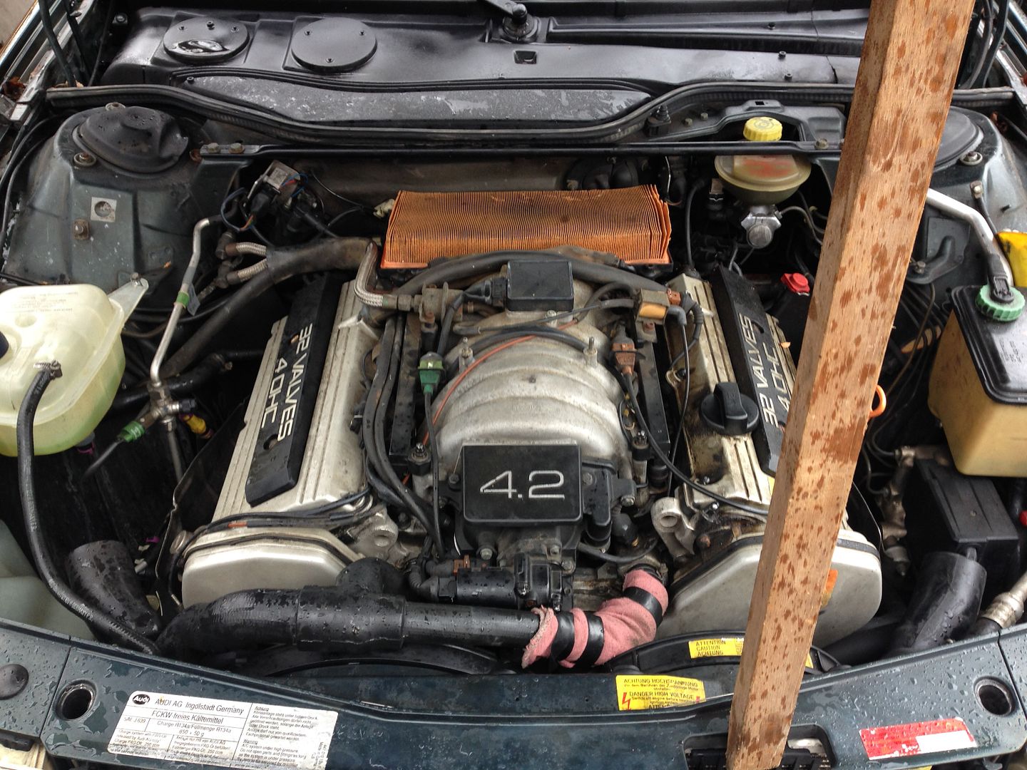

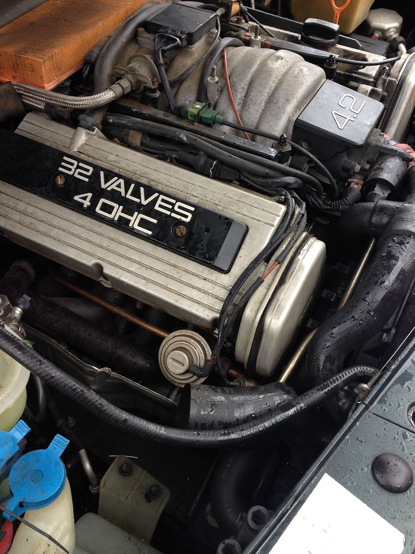

The subject...

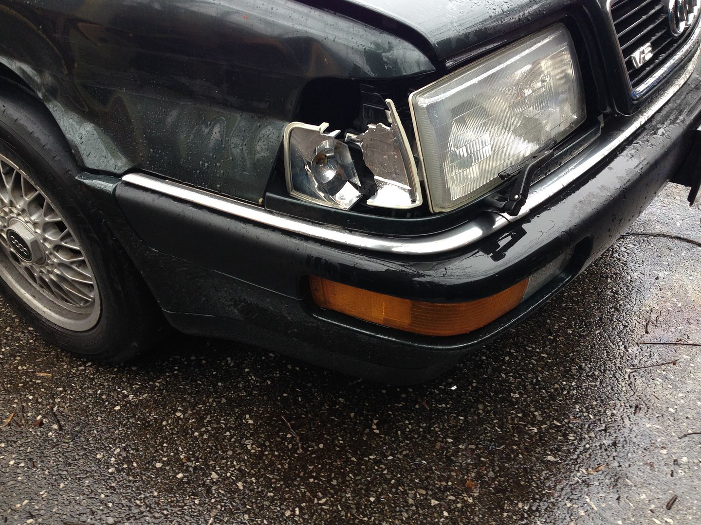

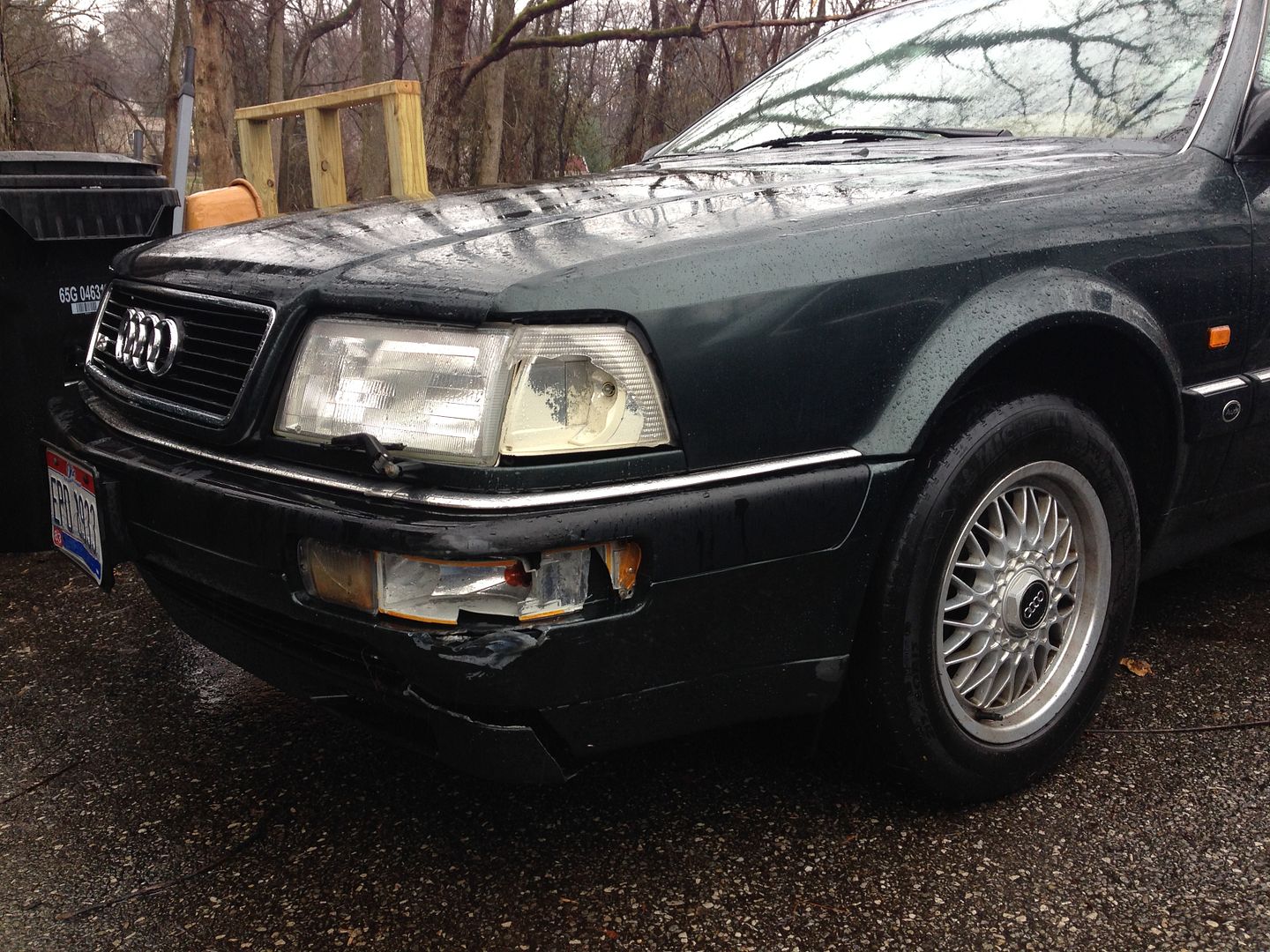

Damage to both front corners...

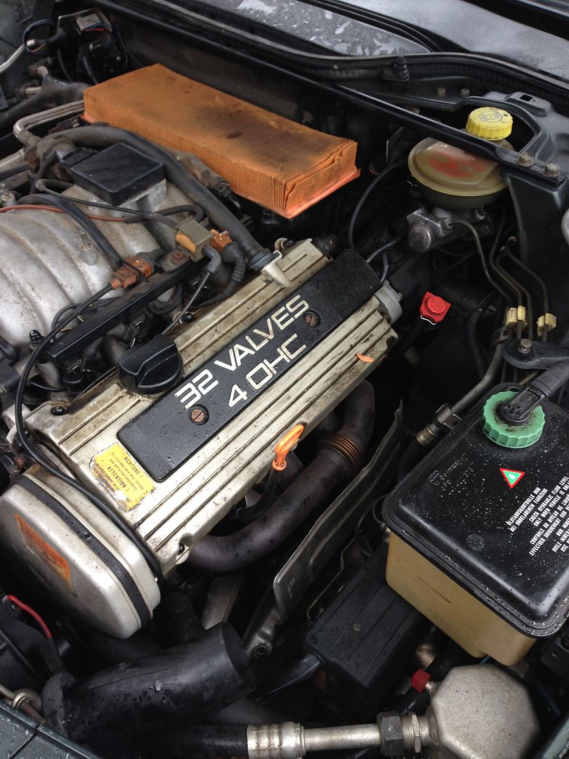

The engine needs some work for sure. Lots of oil coming from the DS head - hopefully just a valve cover issue.
PO put the rag on the radiator hose to keep it from rubbing on the fan
The goal here is to get the engine running and decide then whether to fix the rest of the stuff. The engine could end up in my cabriolet long term if all is well.
The bad with the car as it sits now is...
The interior is not great. The seats are both ripped and they smoked heavily inside the car.
The passenger side door has been taken apart and not put back together well. It doesn't open from the outside and the window doesn't work.
Battery is dead from sitting
The front end damage is a big turn off. Short of finding another PS fender there's not a lot I can do.
Hood struts and trunk struts both toast. (See wood holding hood open)
Bald front tires.
Missing the chrome "8" from "V8"
The car will not start. Cranks but no turning over.
PO said it died mid drive to work. He claims to have had someone confirm there was not spark but I have not tested myself yet.
I was thinking (as the conversation above was) that the crank position sensor was bad. I hooked up my vag-com to the car and was able to see a crank position fault when it wasn't started yet but it went away after I would crank and fail to start the car. That seems to rule this out.
What's the easiest way to test the fuel pump? Are these common failure items?

Looks like someone did a really bad job installing the air filter... lol j/k.
nice pickup, she needs some work, but not many 20+ year old audis do not.
