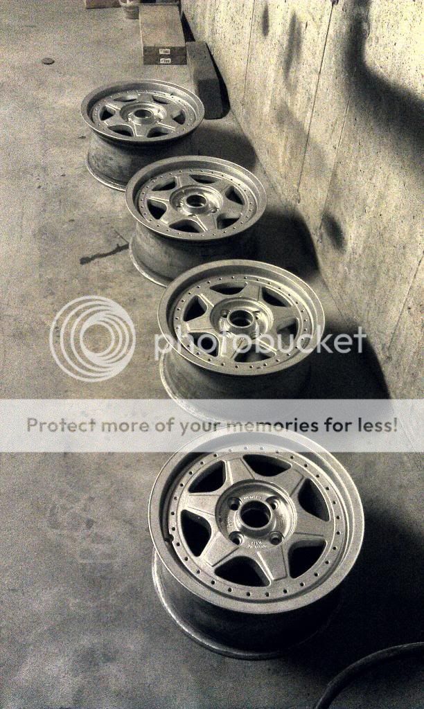

Wheels are repainted. I was going to use them in the winter, but I think they turned out half decent; so maybe summer.

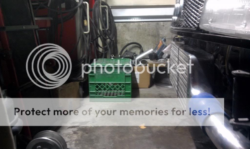

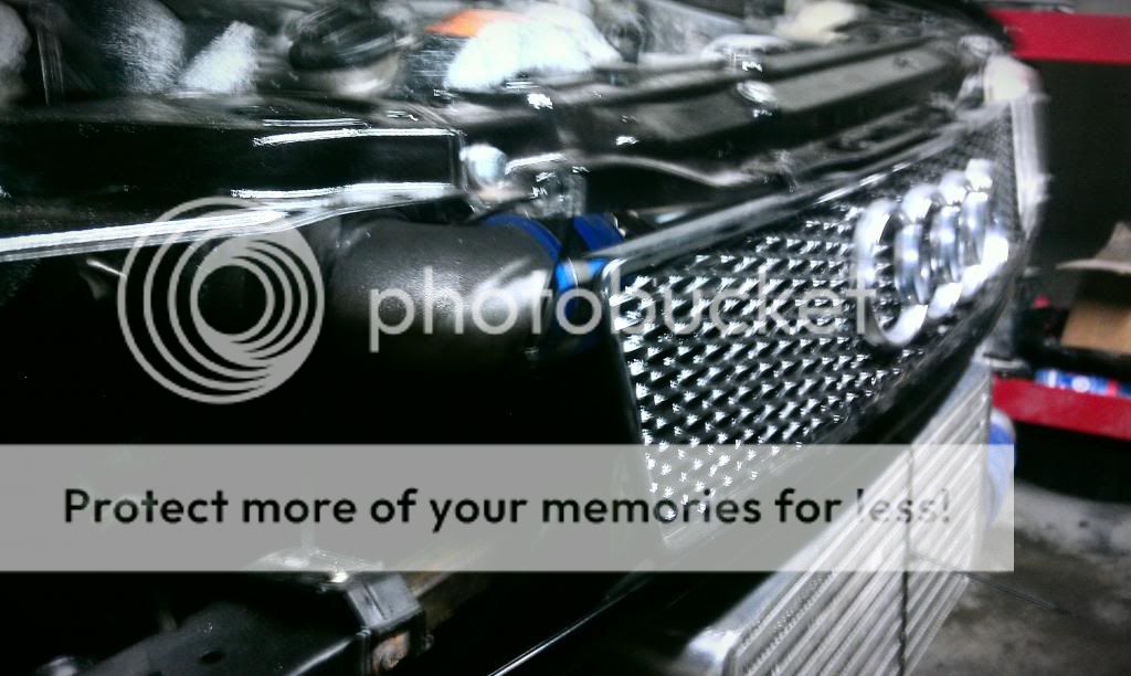

Intake plumbing is much cleaner now, while still somewhat temporary. I think I'm only going to weld a couple sections, as the fit is tight and might be easier to remove later with some chewies. Also, really happy with core support. I thought there were fitment issues, but it fits perfectly--just snug is all.
with any luck the bumper will fit, even though the bumper shocks were 'tucked' rearward. I might be able to take a little of the aluminum bumper support, but I'd rather keep it in a stock-ish state. I have a lead on a 2.5" intercooler if need be; not so sure I need a 3".

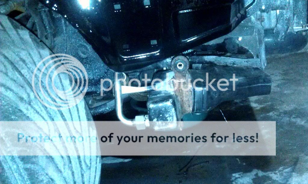

Definitely happiest about the oil cooler mounting. Still needs a small bracket on this side. The other side is mounted to the inside of the framerail from two pre-existing stud provisions.

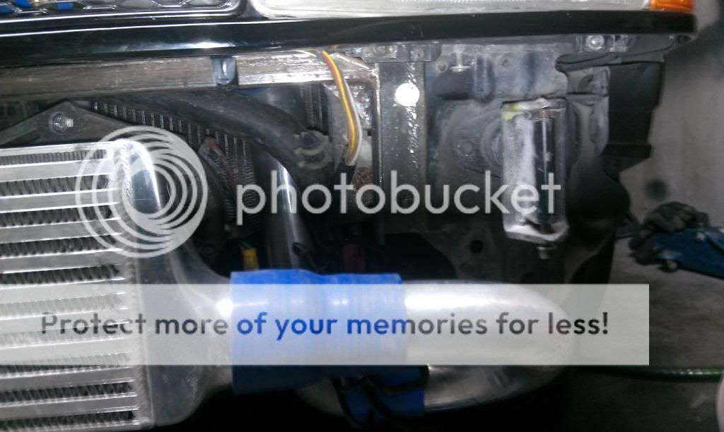

Tried welding some 1" square tube to the core support I bought from 034 and I ended up melting holes in the pieces I fabricated, when the arc was stable enough to do so. Couple of issues I recognized after doing some reading on the process: don't weld near magnets (such as the one I used to hold the small 1 3/4" piece to the support); use ceriated tungsten (rather than the thoriated and pure that I used); use high frequency on start only, not continuously. I'm going to practice a bit before I go for another try.
I had to knotch out the bumper support about 1 1/2" more and remove the sides beyond where it mounts to the bumper shocks.

My buddy came over Friday night and helped weld up the intercooler support. My initial attempt at welding was pretty discouraging, but my friend gave me some good pointers and left his autodarkening helmet for me to use too--now I can see!
The welds aren't pretty, but they work. The support is sturdy as hell, which is good because I'm thinking of using it to hold the skid plate that's still a nascent idea.
The oil cooler is mounted to the frame rail with a bracket I also got to practice my welding on. Unfortunately I didn't check its position with the bumper on, so the air ducting is positioned a bit low in relation to the side vent in the bumper.
