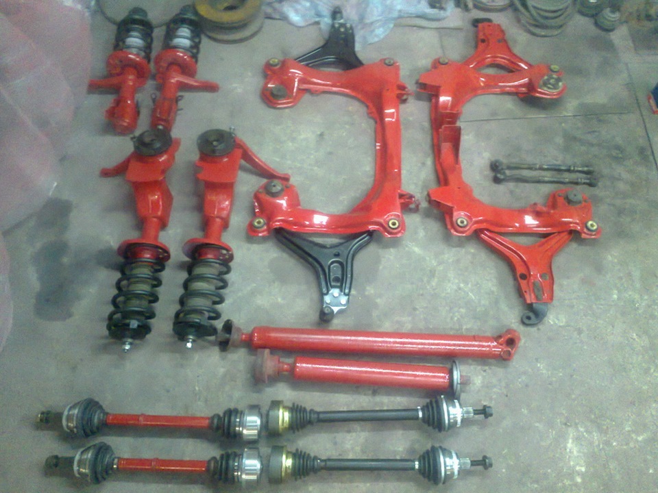

There is a body for 83 years. At the moment, it has been completely disassembled and awaiting restoration. A fast road car will be assembled, keeping the original style.

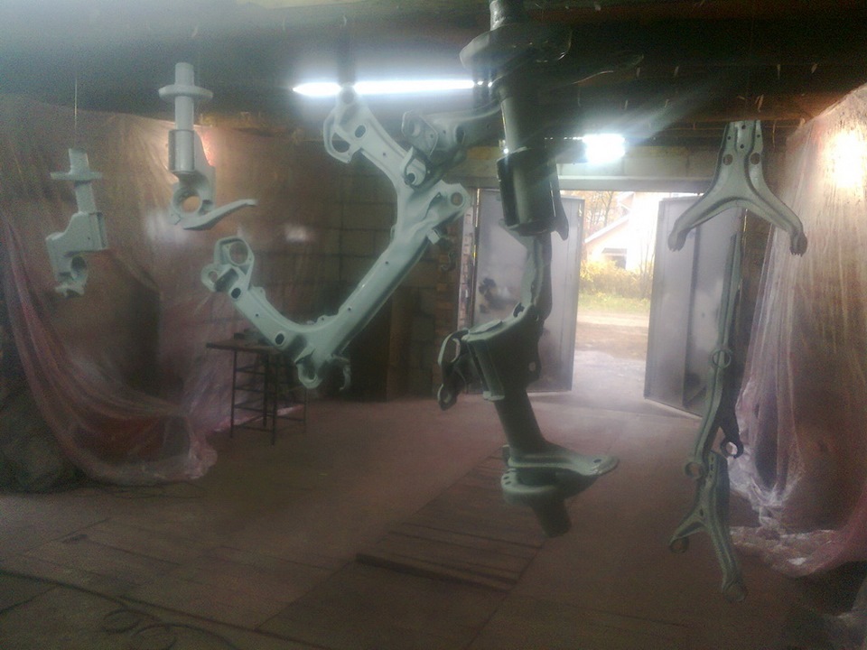

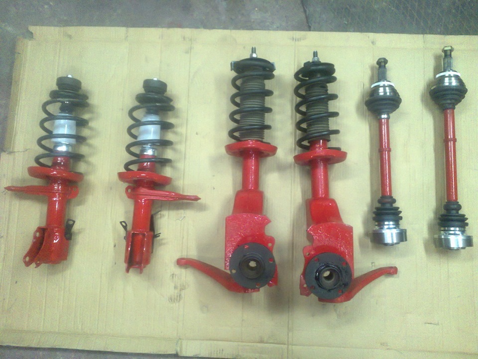

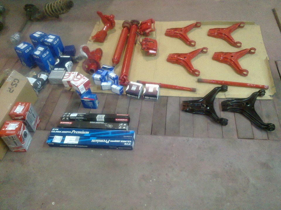

The first step was to disassemble the suspension, cleaned, painted the subframes, replaced absolutely everything, the front levers from the B4 with large brakes. Springs -30mm.

Cool project! Which springs are you using?
 Post subject: Re: Audi 80 10v turbo Quattro
PostPosted: Wed Oct 28, 2020 1:36 pm
Joined: Thu Aug 27, 2020 10:14 am
Posts: 40
to be honest, I don't remember, I did the project for a long time, I picked up the springs from another car

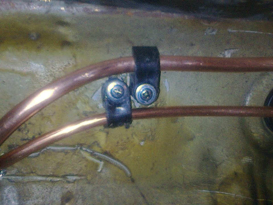

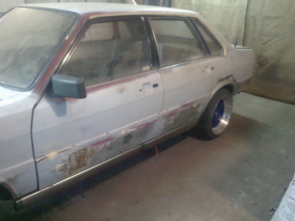

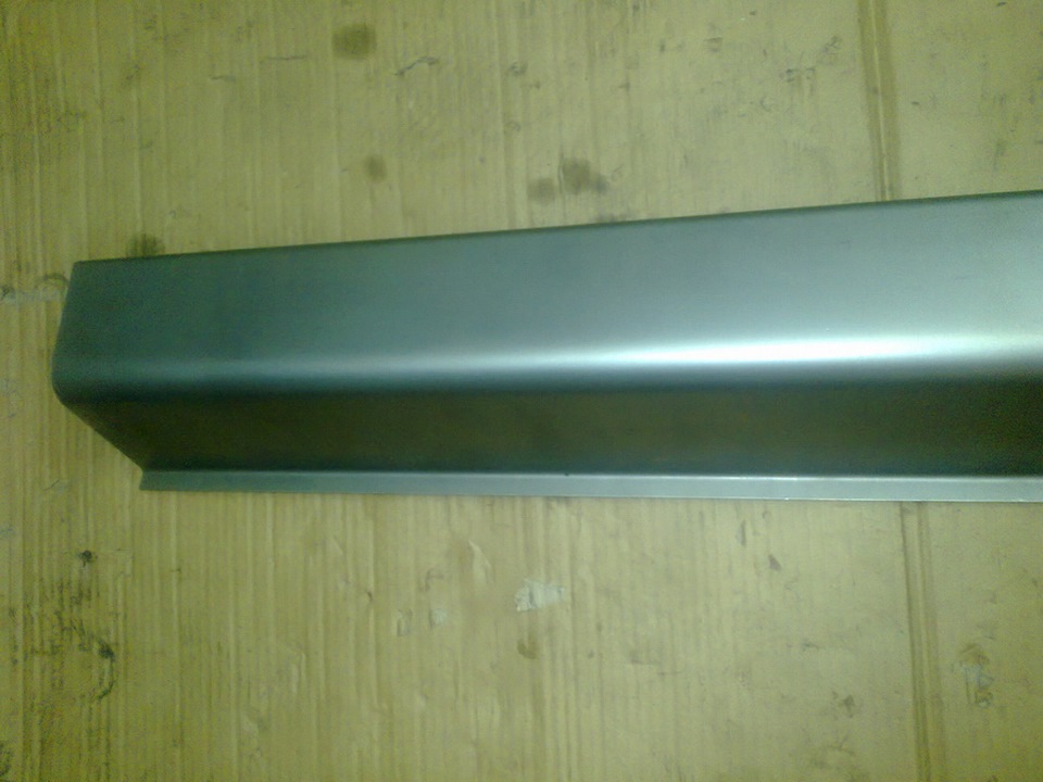

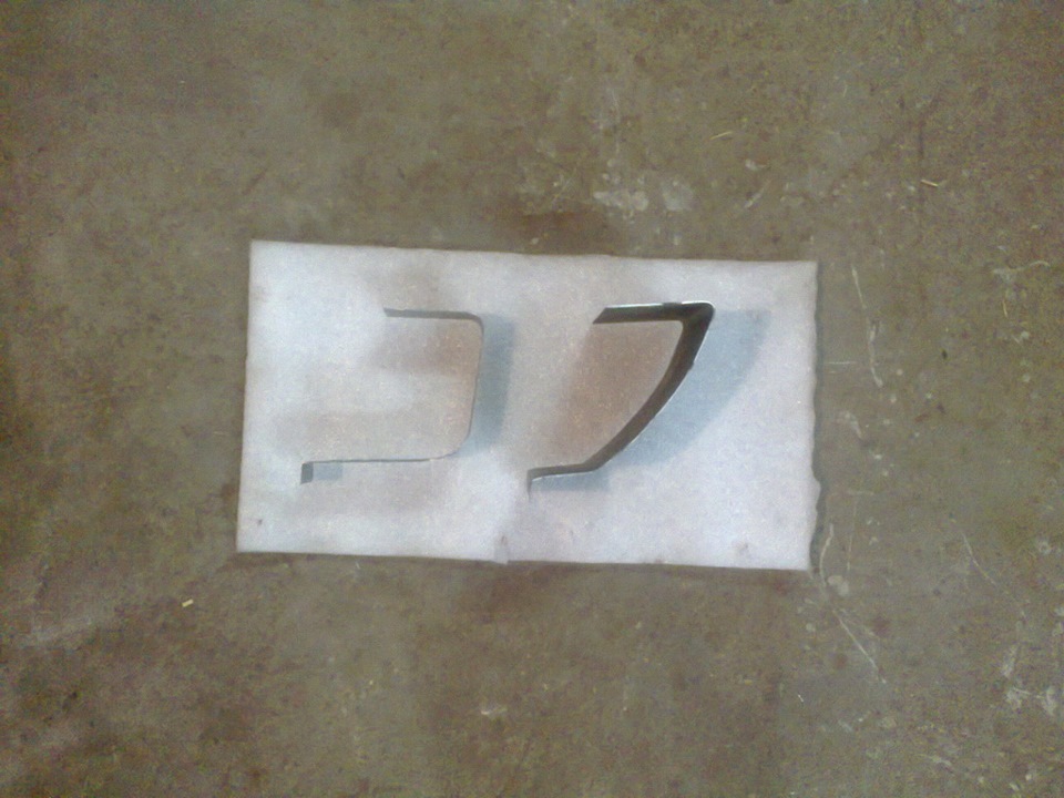

I completely disassembled the body and began to cook. All-wheel drive 80s have a skirt under the bumper in the back, which visually makes the car lower, but the thresholds in the stock are not of the same shape, so I made new ones according to my own layout. In the rapids I laid fuel pipes. He also welded all the holes in the floor, and new rear arches. There was a trunk. There you need to come up with a platform for batteries and podiums for a sub.

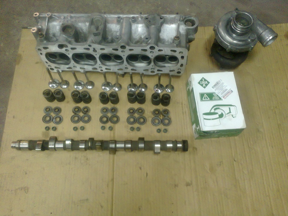

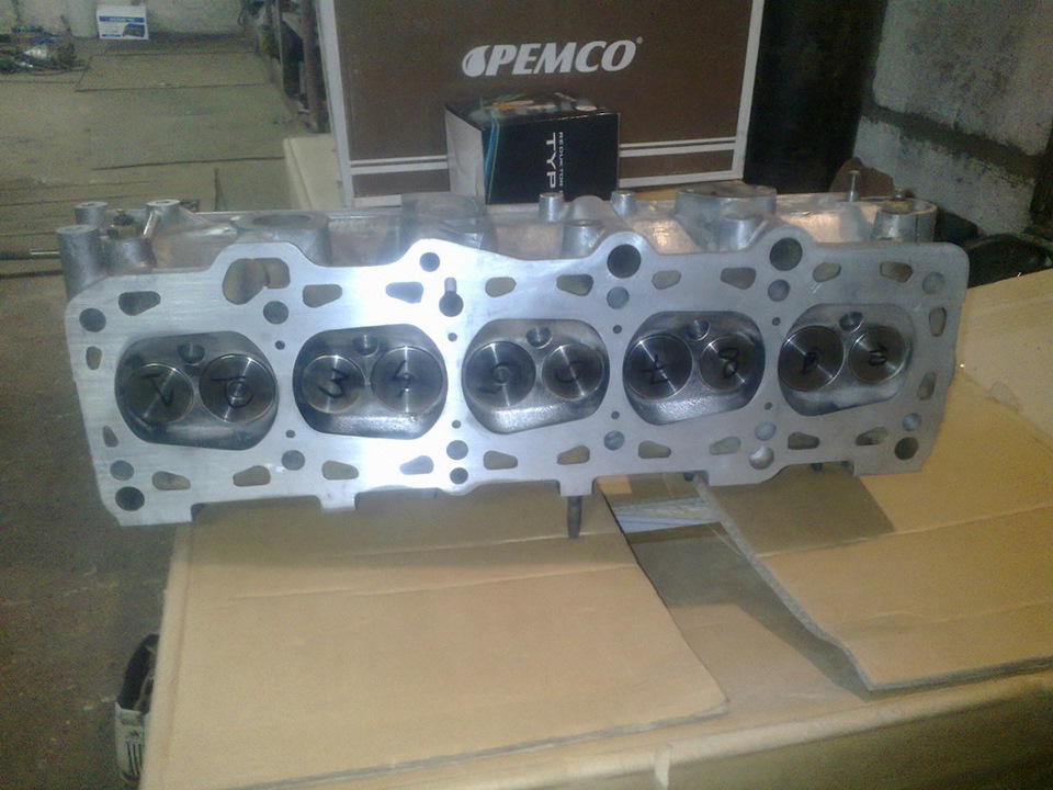

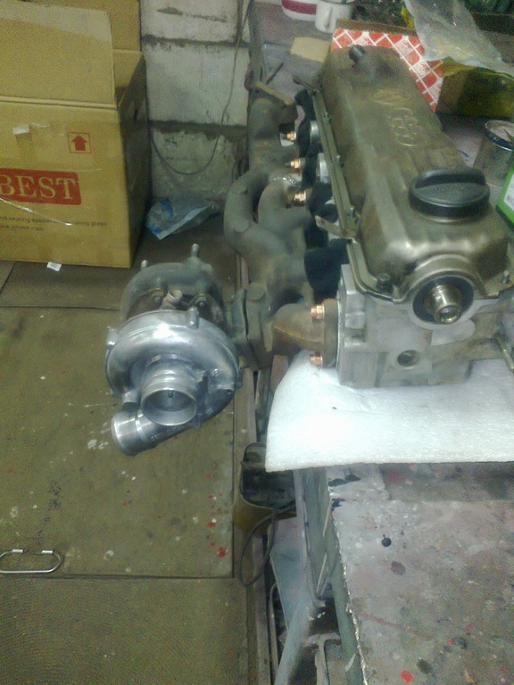

Collected the cylinder head, since the car will be for every day, the valves and channels are stock, turbo k24, metal cylinder head gasket.

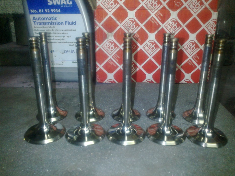

New guides, hydraulic lifters, oil scraper, valves restored flow.

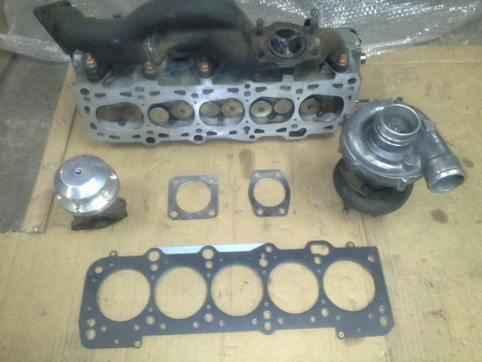

New exhaust on 60mm pipe and stock muffler at the outlet.

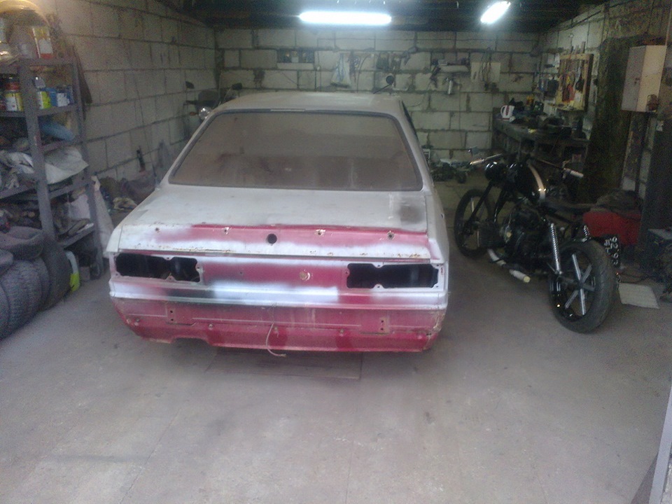

Then everything sorted out again and the bare body began to prepare for processing and painting
The places where the metal was replaced were primed with acid and anticorrosive soils, I missed the joints with a sealant and 3 layers of anti-gravel.

interesting setup. Why did you go for a smaller aftermarket waste gate instead of a factory one?
Dallastown, PA
1991 Audi Coupe Quattro (my first 20v)
2019 Chevy Cruse Hatchback RS (wife's new ride)
PostPosted: Fri Oct 30, 2020 1:48 pm
Posts: 40
Factory ones are now difficult to find, in most of the membranes are already torn

Collected the motor. New cylinders, KS rings, KS liners, victor reinz gaskets, cylinder head gasket metal from aan
Audi 2.7tt injectors, custom rake. I also welded and polished the plane of the exhaust manifold.

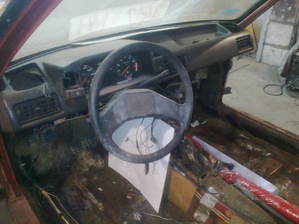

After finishing the wiring under the hood, he began to restore the rest, nothing worked in the car except the brake light.
It was also necessary to collect one of 2 devices,
I put the rear strut and the mass off button.
