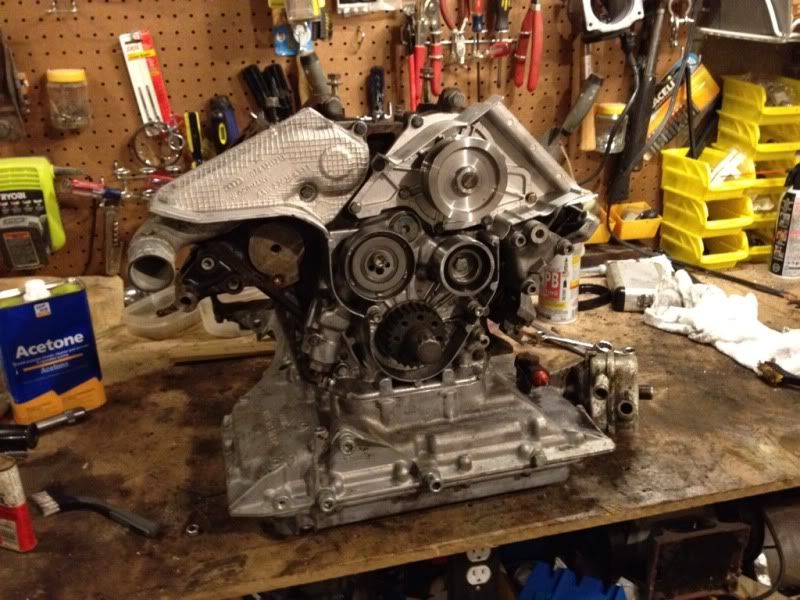

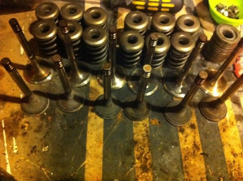

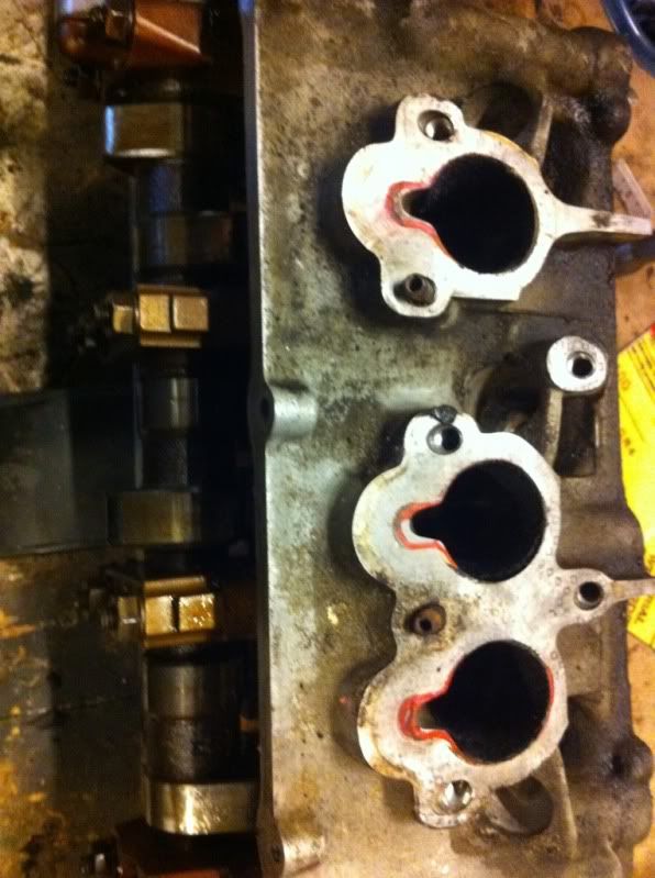

I'm in the midst of cleaning the heads in preparation for the port and polish procedure and I am looking for guidance on the lifters and valves.
How clean do these valves need to be? It seems like as long as the rim on the outside is clean and free from gunk it should seal. I had them soaking in degreaser for the last week and cleaned them up today.

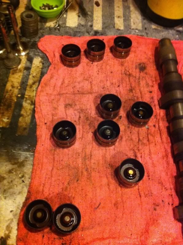

Also, while inspecting the lifters I noticed that only 3 or 4 of the 12 had any give in them. What is the best way to test them? Is it as simple as using the ones that compress when I push them? Should I soak them in Marvel Mystery Oil or something to try to free them from the gunk that has them stuck?

You want to make sure the valves are clean and there is no buildup on them before they go back in. You can clean them lightly with a wire wheel but keep on the head of the valve and away from the shaft. You just want to remove carbon buildup but you don't want deep scores in the valves. Check the manual and see how much valve movement you are allowed with the valves to see if the guides are worn at all. Now is the time to get all of these things done if you think you are going to leave the car in its current configuration for a while. As long as the guides are good you can lap the valves and put new valve seals in it and off you go. The lifters on these cars do wear over time and start to tick so you may want to change them out now to avoid the problem later. I believe these lifters are the same as the VW ones which are about $120 or something for the set so they are not too bad. I'm not sure how they should feel, the ones I have played with were all new and had no movement with finger pressure but that doesn't mean yours are bad. I typically err on the side of caution and just replace them. I rebuilt my G60 motor not too long ago and I replaced all of the lifters and I will be rebuilding the motor in the Corrado and it will also get new lifters.

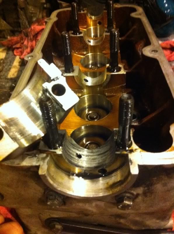

Found a weird thing when I took the rear flange off to change the gasket and rear main seal.
Where the coolant drain plug is screws in was completely clogged with green gunk. Also, it had eaten away at the flange cover.
You can see the space under this razor blade...

It has to be coolant, there isn't much else green that can east aluminum like that. Although coolant itself won't eat aluminum it can allow some chemical reactions to start which can. VW and Audi had to switch coolant to the pink stuff (G12) to stop head gaskets from being eaten so maybe this is what you are seeing.

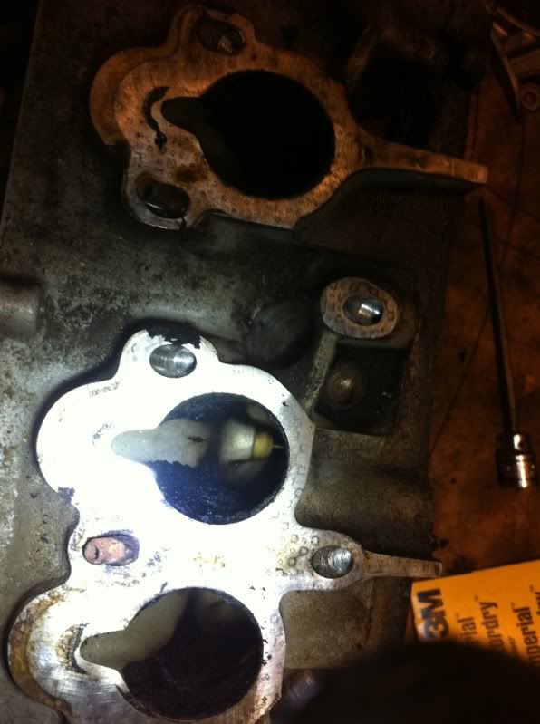

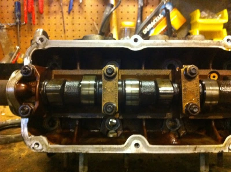

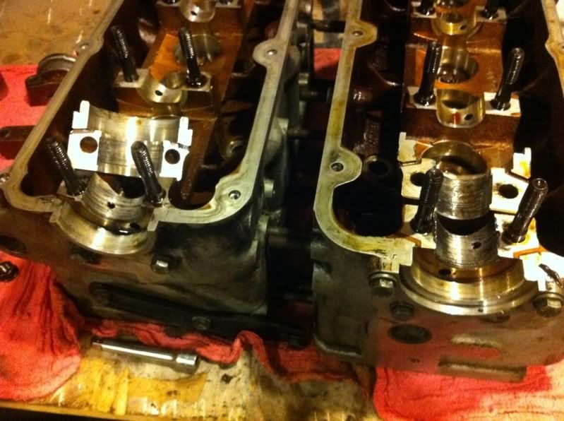

Well I got the heads off the engine that's in the car and they are in way better shape than the ones from the junkyard. No sludging and cleaner valves. I'll be using them for the rebuild
I started the gasket matching on the heads. It really is amazing how badly the audi folks engineered this connection. The amount of air is greatly reduced by the poor match of the intake manifold to the head. The red will be removed...
I still don't know what's wrong in the block but removing the heads made no difference in the difficulty of rotating the crankshaft so I am assuming the heads are okay. I'll still be taking them apart to replace the valve stem seals.

I started disassembly on the "better" heads and found the first signs of the damage from the cab's original motor.
The front camshaft bearing cap on both sides had some pretty serious damage.
The PO said he thought that engine lost the oil pump and that's what destroyed the engine. This would seem to be evidence of running with no lubrication.

I'll read any thread involving use of the 12v V6. Cool you are doing the port matching work. Are going to open the IM and clean/port that, too?
