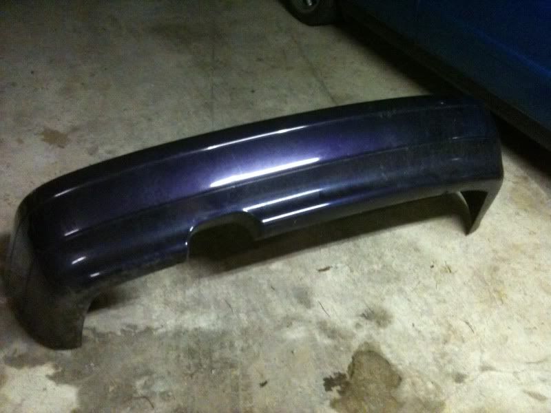

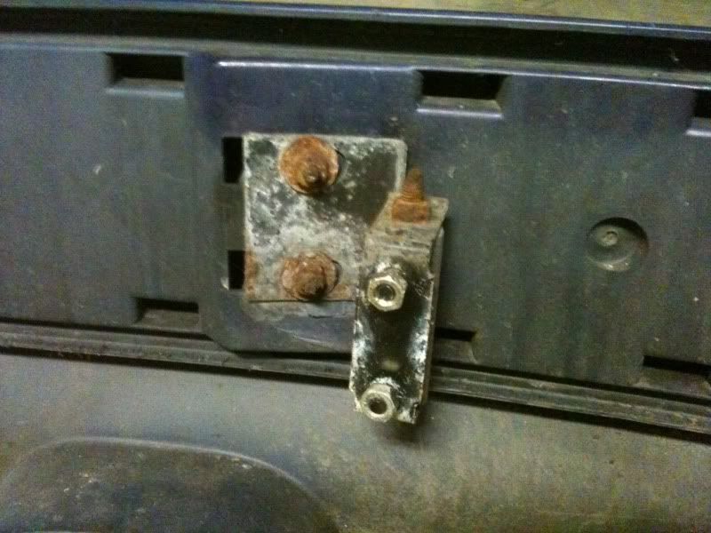

Here's an S2 rear waiting to go on. I've also got a euro coupe front with fogs and turns on its way too.
While we're on the subject...what are the chances I can get these rusty bumper bolts off without damaging them? I'd like to mount the brackets and then install the bumper on the brackets.

Rustblaster, Wurth's Release fluid or the New stuff from Loctite that freezes bolts & nuts and makes it easy to take them off.

soak them in kroil. my s2 rear bumper looked the same way. eastwood sell it. i swear by the stuff. dipenetrant might work to.

wire brush, run a die over the threads, and soak them. BTDT on stuff like that.
