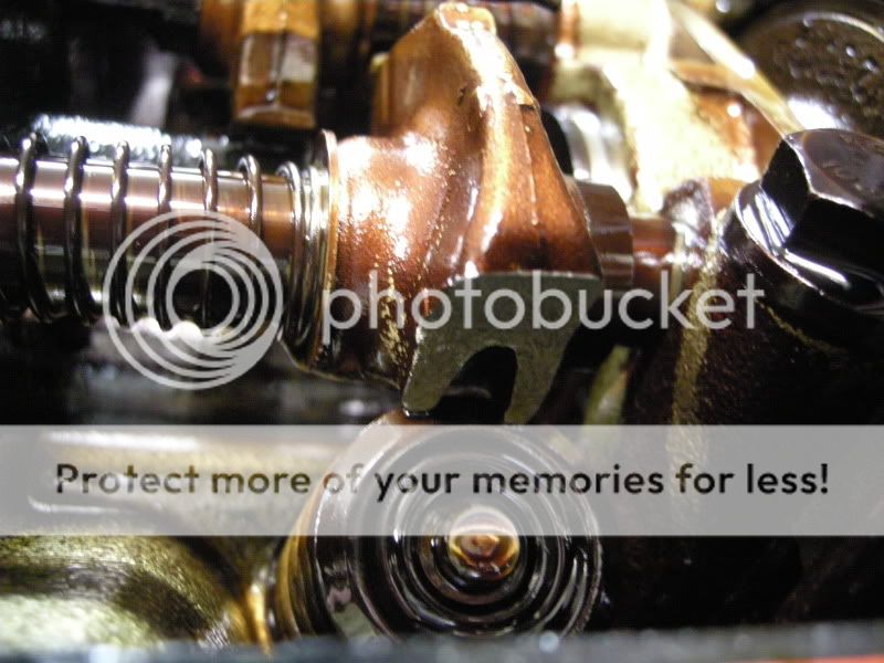

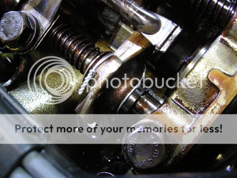

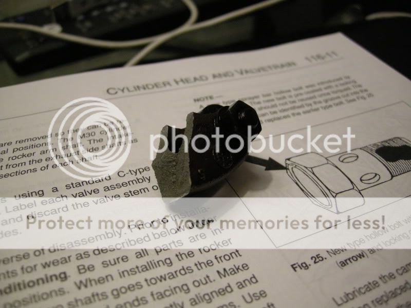

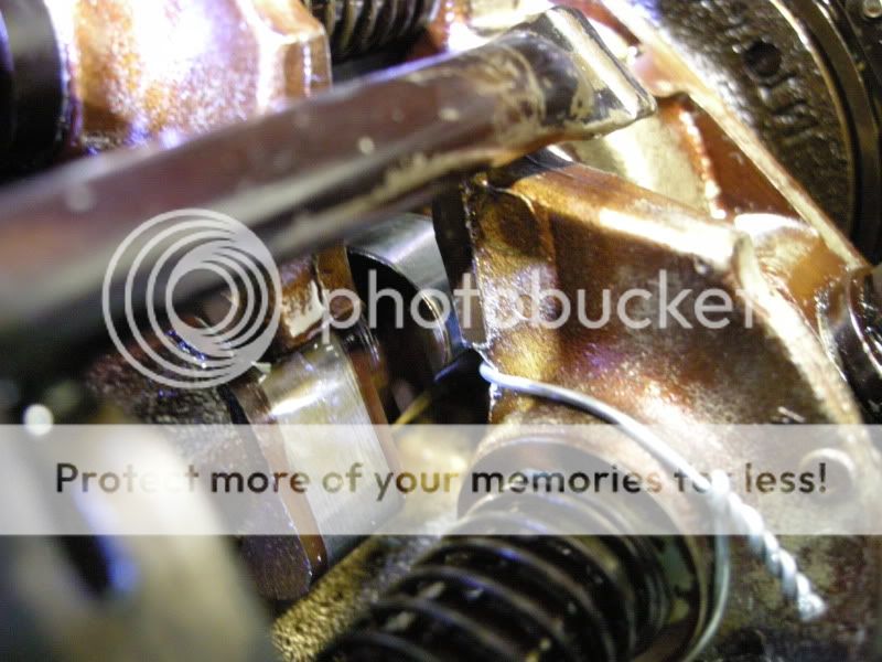

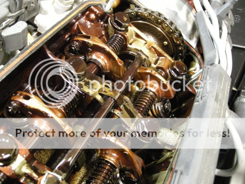

Time to revive this thread! Not a lot has changed since my last update. Since I've been living in an apartment in Halifax I haven't really been able to do anything fun to the car. I did drive it back to Ottawa last week, so now it's parked in the garage for the winter.
About a month ago while I was in Halifax an exhaust rocker arm broke, and my only options were to have a shop rebuild the head (big $$), or drive it back on 5 cylinders and rebuild it this winter. I drove it back :)
In preparation for the 15 hour drive, I disconnected the injector and loosened the spark plug. I also tied the remnants of the rocker arm with safety wire so that it wasn't flopping around on the cam.
The car made the trip without any issues. I kept it above 3k RPM and it was actually pretty smooth. Below that or accelerating and it was a bit rough.

Replace 12 of them part # is 02rarmHD with these $300.00...
http://www.iemotorsport.com/
They are listed in their engine parts in their performance catalog under E9 E12 E23 E24 E28 AND E34 YOUR CAR....
These will definitely be replacing the stock arms! They were already on my radar but thanks for the link!
