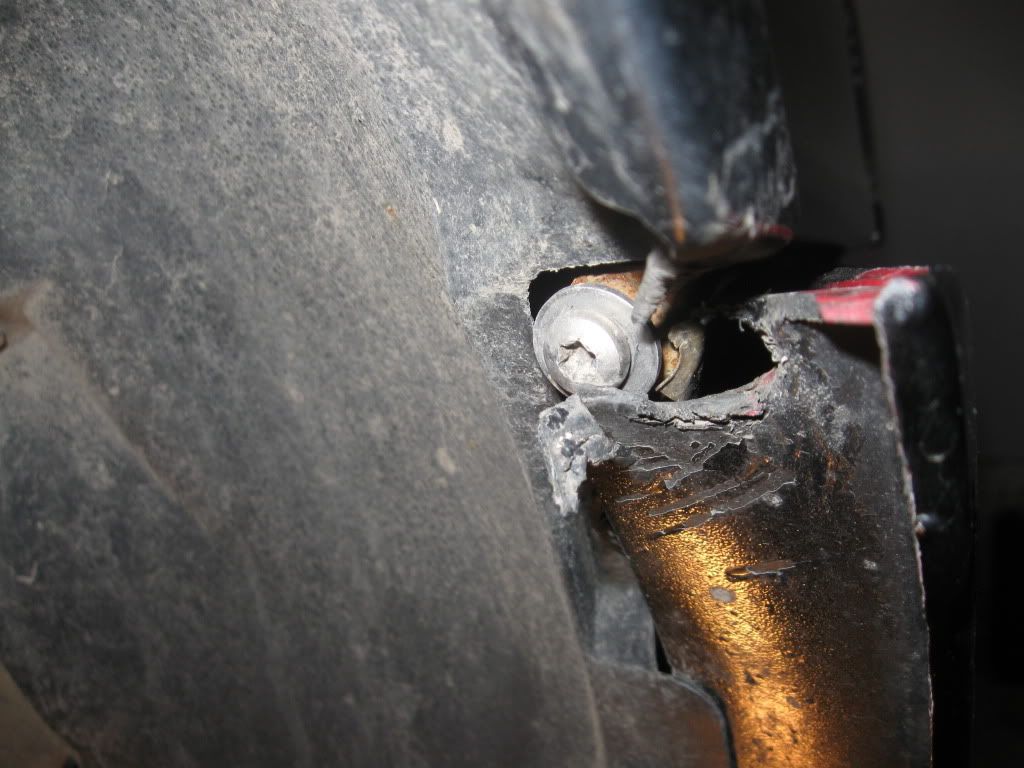

Front bumper mounts have been hard-done-by with the local winters:
This is a fine example of why I no longer trust a shop to replace parts, or what gets overlooked:

Tried making a tool to take the strut top mounts off, but despite our best efforts the nut just wanted to round off. Will try it again later with an impact gun when I move down to the (B) items on my punch list.
DON'T do what I did here; before you attach the lines at the back of the PS rack, install the steering dampener and bracket first. Save the gigantic PITA of redoing everything.
Went to take off the front TB cover, and of course, rounded the inside of the hex-bolt so I'll have to pound a 12-point onto it to get her off.
Not so sure what the deal is here, three wires are terminated with insulating tape. WTF? Could this actually be the cause of my non-functional cruise control? (Just a guess)
Figured this coolant nipple was looking a little rough so, while I'm in there, might as well replace the thing.
And almost on cue, a stud which broke off during IM removal would not take heat and thus be coaxed out. So. Drastic measures ensued. Help, or BTDT advice is especially appreciated!!! Tired using a drill-bit easy-out but just wouldn't bite. So we drilled it out and will tap the hole once I confirm the proper size. I hear I should use a heli-coil... can anyone confirm/deny?
Now all I have to do is convince the stealership to loan me VW/AUDI tool 2084 to lock out the crank and I can do the TB.
Unless you have a better method to do so while the engine's on a stand (no FW installed)?
Find me on Instagram @pry4sno
|| 2010 Golf Sportwagen TDI /// #farmenwagen
|| 2002 Dodge Ram 2500 24v Cummins 4x4 #bertancummins
|| 1992 80 quattro 20v /// Eventual AAN'd Winter Sled
|| 1990 Coupe quattro /// #becauseracecar
|| Spare parts for sale
 Post subject: Re: While I'm In There... Story Of My Cq 20v Restoration Pro
PostPosted: Wed May 25, 2011 3:05 pm
Joined: Thu Oct 02, 2008 12:48 pm
Posts: 1391
Location: Edmonton, AB
Was dreading taking off the crank pulley for replacement and as part of a timing belt replacement, largely because of the amount of torque on the crank bolt and the that I was missing a required tool for the job, VW 2084 (see above ^^^).
Of course the only place in town that had one was Southrape the local stealership. And they flat out refused to loan me the tool even with a $500 deposit. Then they wouldn't even entertain selling me the tool and ordering themselves in another one. Best the shop service manager offered to do was order it for me, at retail :roll: :jerk: , and I'd still be waiting as long as I would if I'd just went through ZDMack via eBay.
Now that it was down to principle, I said screw you I'll just make my own.
Once it was mocked up, only one original hole needed to be notched about 1/16" to fit up nicely.
The only difference was that using this flat bar tool for a crank lock out device meant you needed a person to watch the crank and make sure it doesn't drift while breaking the crank bolt. For whatever reason, this presented no issues for me and came off nice and easy. Score one for the good guys!
What did happen was two of the four smaller hex-head bolts that go around the crank bolt rounded during removal, so we drilled the bolt heads off and turned the studs out nice and smooth.
Same thing happened to the bolts on the outer TB cover, so using the same method to release the others, and... voila! I now have all the access I require for the work I'm about to commence.
