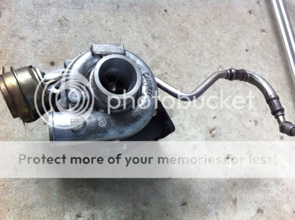

Do an ecu-upgrade to odb flashable edc15vm+ and change to a gtb2260vk.
The ecu can be bought for €20-30 and vw t4 software with vnt-control can be flashed into it.
That was my plan while back, using GT22V,
however with the car being just a daily driver I really don't need to go through the pain.. most of the items you are listing are not available on this continent and would have to be imported in. Wish we had the kind of diesel market you guys have there!

That it is entirely true. You have a quite large 4-cylinder tdi market and the ecu does not have to come from a 5 cyl car.
IF I have understood everything correctly all the ecu's with number 038 906 012 xx is edc15vm+
This sticker doesn't say edc15vm+
http://www.ebay.com/itm/VW-JETTA-GOLF-B ... 60&vxp=mtr"
But this one does:
http://www.ebay.com/itm/2001-02-Volkswa ... 1d&vxp=mtr"
Both are on your side of the pond and the first is even in Canada.
It can also be put into a neat little package:
From this thread: http://forums.tdiclub.com/showthread.php?t=416364"
There is more info on tdiclub.com regarding ael with edc15vm+ ecu.

Oooh, I do like that... looks very neat. Thanks for the pictures, I might have to rethink my reluctance.
So, where does one get vw t4 software with vnt-control?

Pm me i can share from 151hp, 111kw. I use it for project.

My dd should also get this treatment. Awaiting answer from potential seller.
This file should do it:
http://www.chiptuners.org/forums/viewto ... f=6&t=1726

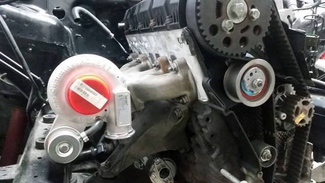

Oh yeah :) here's the boost with the stock WG setting...that's just first and second gear
https://youtu.be/nwbs0xa2zrI
Car goes like a stink right now. ..I've got it boosting to 36psi with no issues

Spool isn't very impressive.
