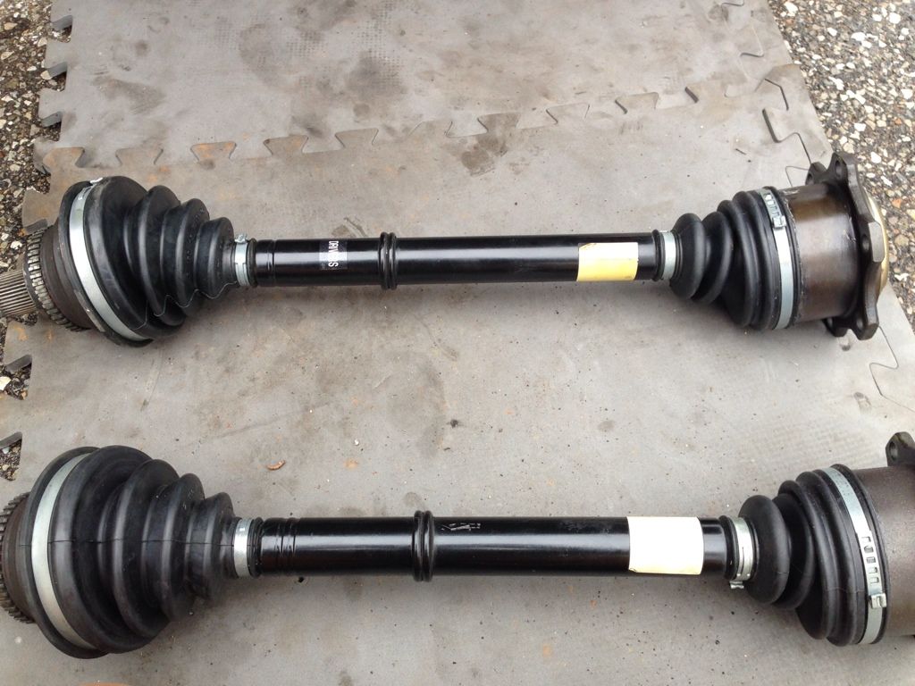

The transmission went in pretty easily but I had my retired dad come by to help align from the other side. Once that was in input in the axles (new boots and repacked)
The drivers side is the one with one indented ring, (to the left of my label) the PS has 2 indented rings

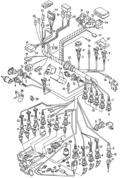

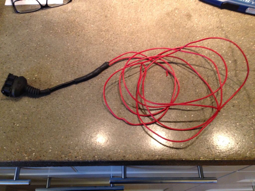

Back up lights - I don't seem to have the harness to connect to the back-up light switch here...
I need #13 here but I don't see it in my harness...

Thanks for the help, I got a couple of these things figured out today. I pulled the code for the no start issue and it was a "no signal" from the engine speed sensor. First thing I did this morning was to uninstall and reinstall that in the hopes that I just had it in there wrong before. Whatever I did fixed the issue because it started right up!.
The reverse lights issue is going to be an easy fix now that I know what to do. I checked the continuity of the 2 pins on that back-up light socket on the trans this morning and was able to confirm that there is continuity only when the trans is in reverse. So I went to the junkyard and found a 5 pin harness pigtail to use. Only pins 2 & 3 are used so I have a harness I made ready to install once I figure out where I want to come though the firewall.
I used this image to jumper the starter lockout and will use the two marked wires for the reverse lights....

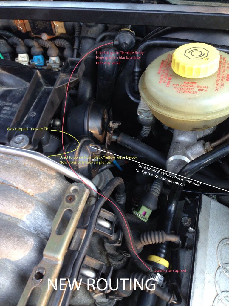

Here's the way I re-routed the Vacuum lines.
I had a 93 90Q so I had a few pics and some memory of how the lines should be routed. the biggest difference in the automatic is that it has a second large vacuum line that joins up with the brake booster's line on the way to the Intake Manifold. It tee's off from the DS valve cover breather. The Auto does not have that.
Also, the Auto has two hole that are plugged up. One is on the air intake on the "Snorkel" or intake silencer and the other is on the black/yellow one-way valve that is between the brake booster and the IM
here's what you are eliminating from the Auto routing
and the changes you make are as follows....
Remove the line that goes from the black/yellow one way valve up above the brake booster to the Throttle Body. That will be re-run to the other Black/Yellow one way valve that was capped. Eliminate all the mess from that black/yellow valve to the IM inlet. That means you need to make a single piece valve cover breather too.
Uncap the intake silencer's plug and run a short length from there to the throttle body.
