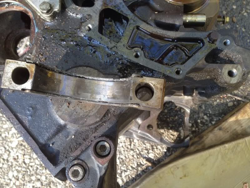

Lots of progress today...

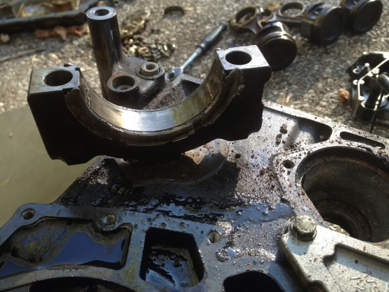

Got the old engine out and the new block in.

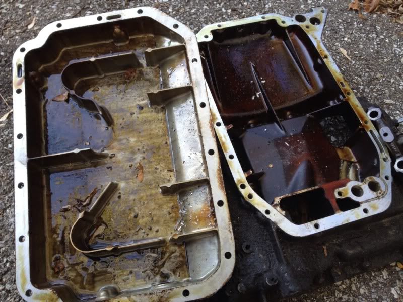

Found more damage in the old motor. The thrust bearing at the rear of the engine was toast...
You can see all the shavings in the oil pans...
All that's left is to put the heads back on and put it all back together. Hopefully I'll be done in time for a drive!

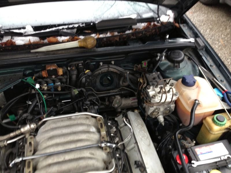

I got everything back together last Monday and I was delighted that it started! I drove it all last week and put about 100 miles on the new engine.
A couple tweaks and mistakes I made were made clear...
I had a CEL flash a couple times for a second or two at a time. I had forgotten to connect the DS O2 sensor.
I had a horrible burning rubber smell coming from under the hood. I hadn't reconnected the vac hose from the firewall to the cruise control. It was resting on the DS exhaust manifold and was about an inch shorter than it used to be. Duh!
Lastly, the TB was on too tight causing a whirring sound that was a little alarming. I took the belt back off This morning and fixed it. I had a hell of a time breaking the sprockets free but it's kinda useless to change the tension without breaking them free.
I put 8 oz of Marvel Mystery oil in the crankcase and a bottle of Seafoam in the gas tank today to help clean out the engine.
The only mystery that remains is that the odometer/speedometer cut out sometimes. At least twice they've stopped working while I was driving. I would think it has to do with the sensor on the drive plate - it may be bad or it may be installed just barely off. Or could be not plugged in right.

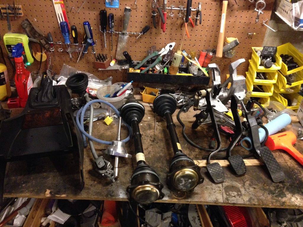

This stuff arrived today....
Thanks barfbasket!
Now I need the transmission and I'm off!
I have a 99 passat 1.8T transmission with 61k miles near me that ill be getting shortly...

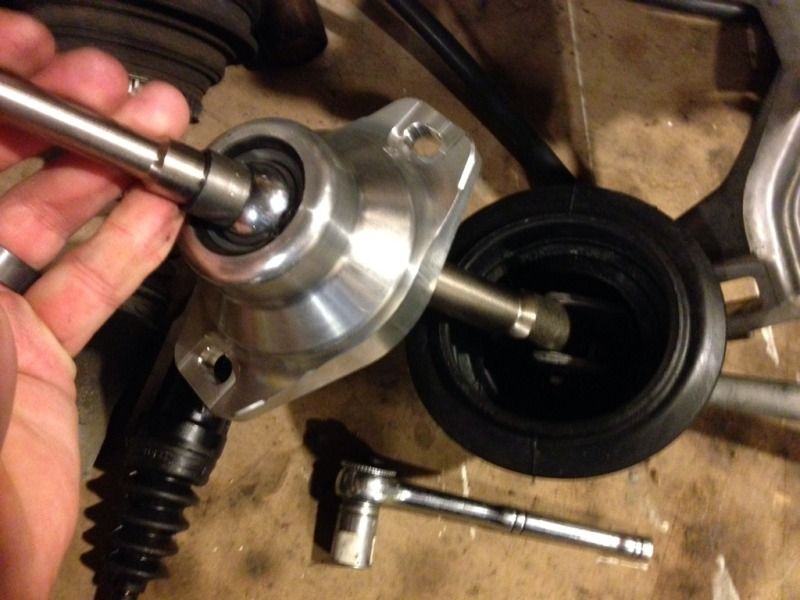

And my solid 034 short shift kit will be here in a couple days.

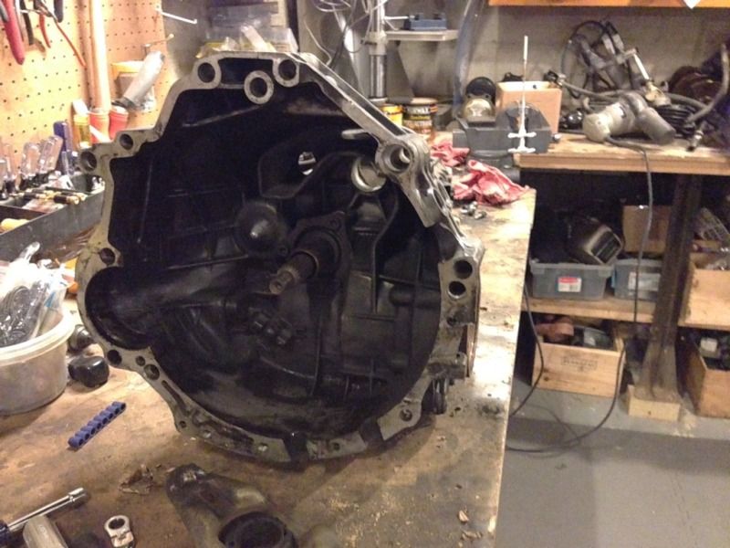

It's on.

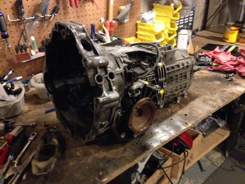

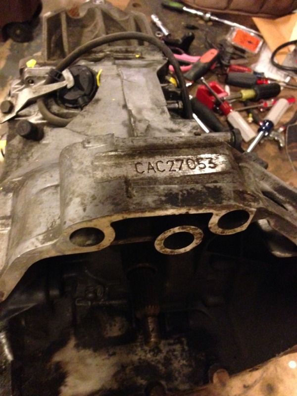

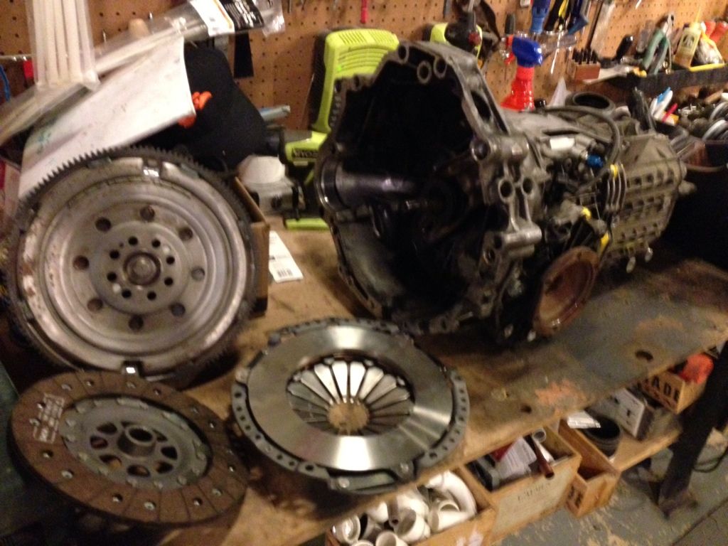

I picked up this CAC code 012 Transmission from a 1993 90S with 53,000 miles today.
I still need a Flywheel but I have a line on a lightweight Aluminum version and on an OEM version as well.
I need advise on the "new" transmission as far as what I should do before the install. What other than the Clutch and Flywheel should I be doing to this? What is the recommended trans fluid?

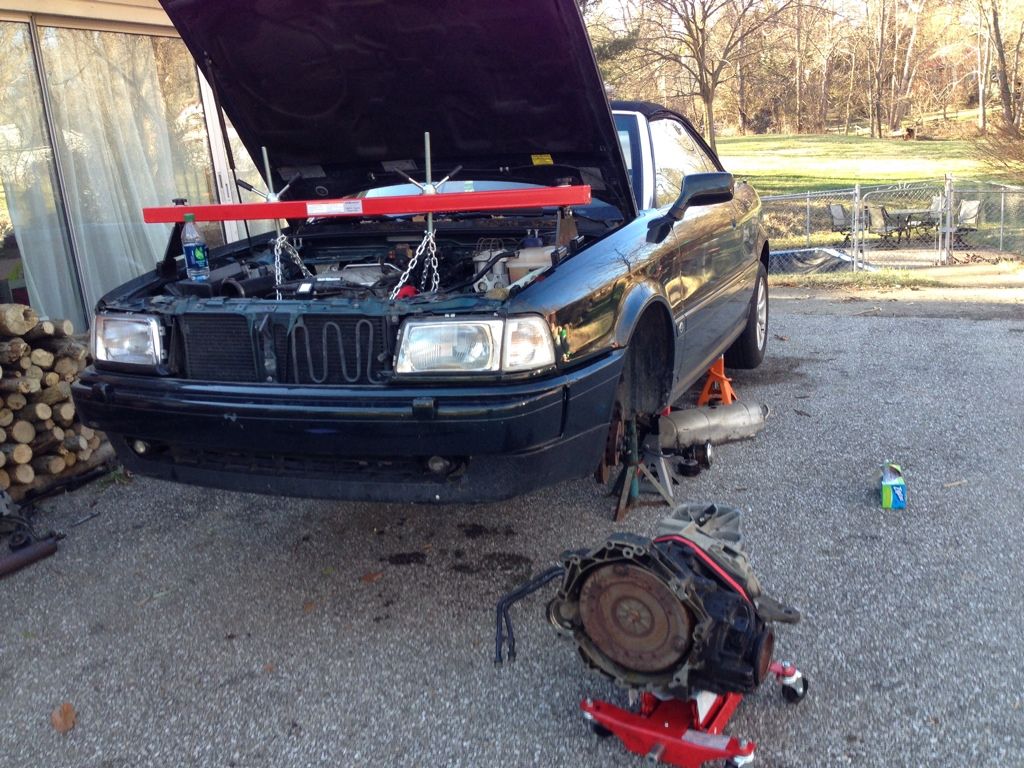

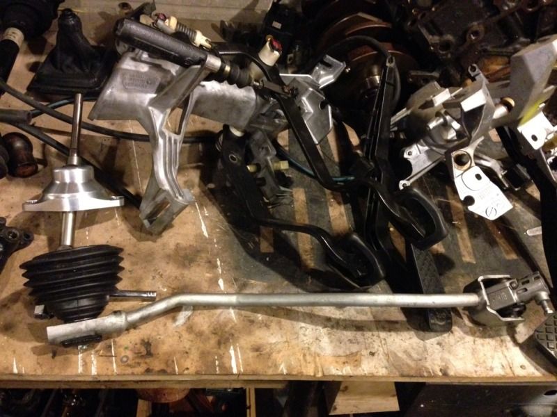

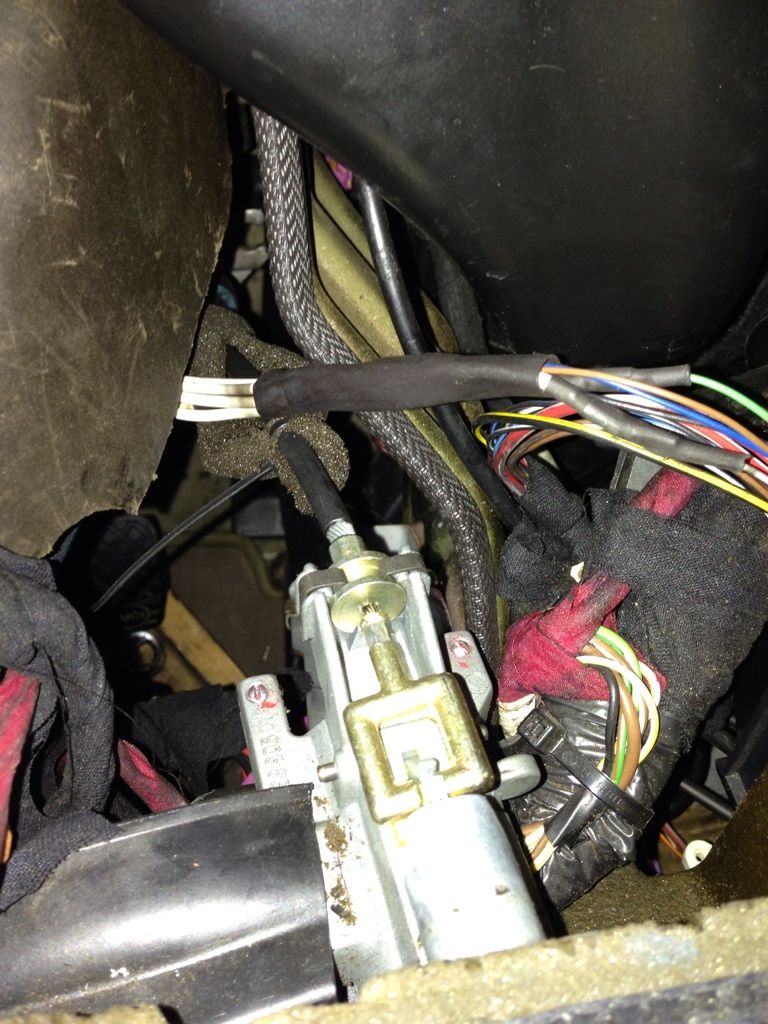

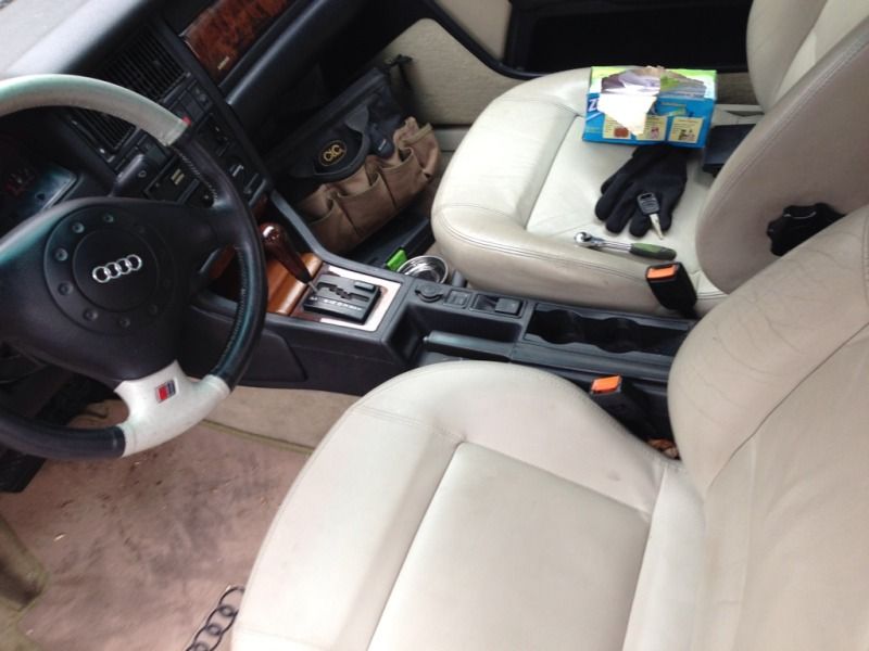

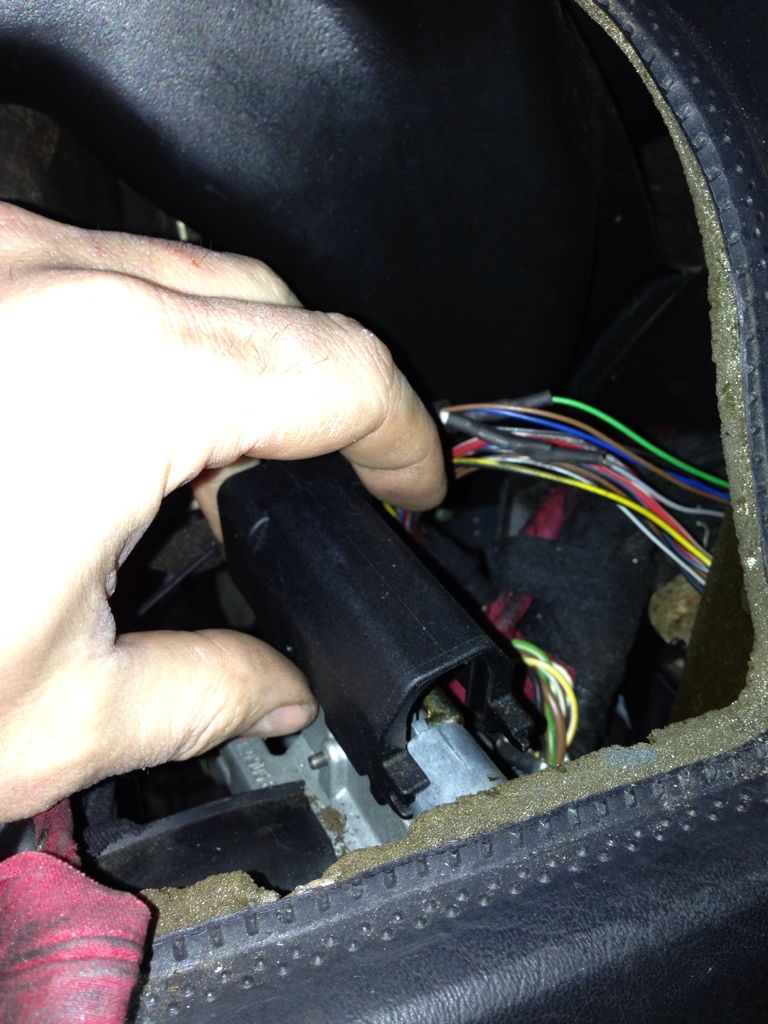

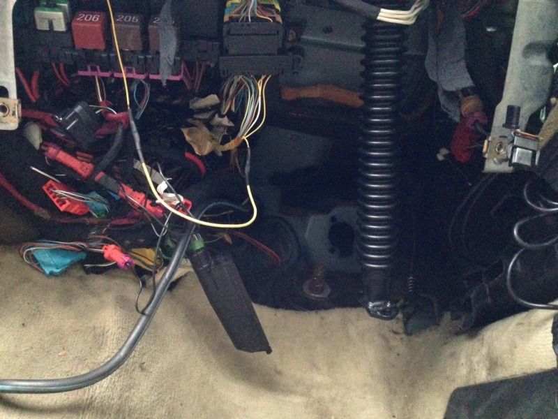

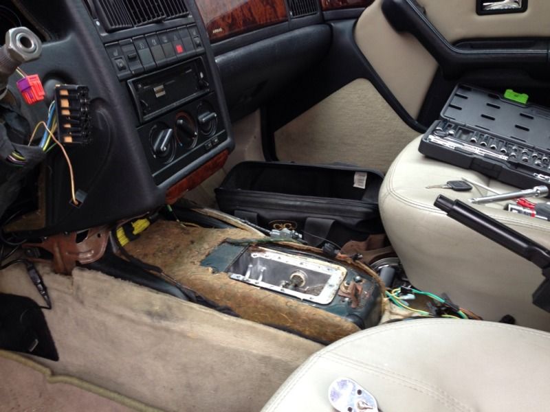

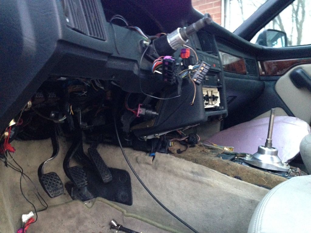

I started digging in today and made some progress on the disassembly.
Before...
Got the TCU disconnected and removed...

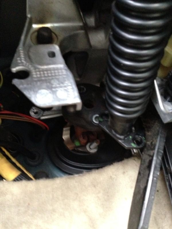

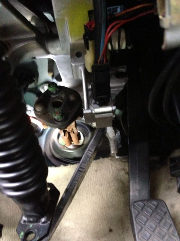

Disconnected the Steering Column and removed the rear section of it...
Removed the auto Shifter and took out the center console

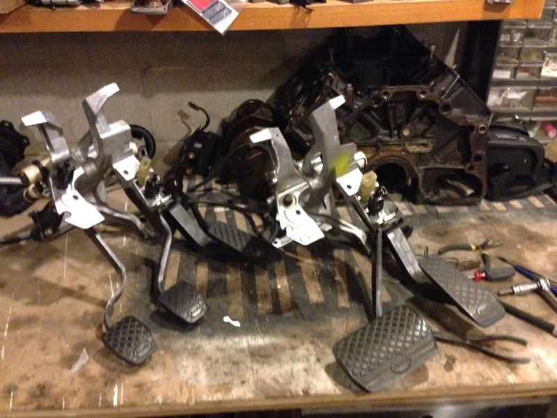

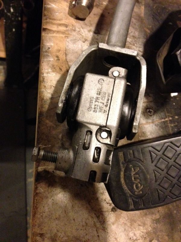

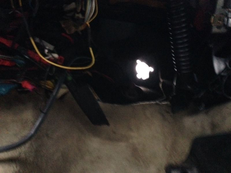

When I did the Clutch Master Cylinder on my old Audi 90 I had a hell of a time getting the hydraulic lines detached from the MC and then reattached. I ended up taking out the Brake Vacuum Booster and it revealed the back side of everything. With that in mind I did that here too.
I had to take the front two ABS lines off to get it out and I'll have to bleed the brakes when I'm done but I would likely do that anyway since I am adding the clutch into the hydraulic system of the car.
I think I'll appreciate the top view of the transmission once I get into the replacement too...

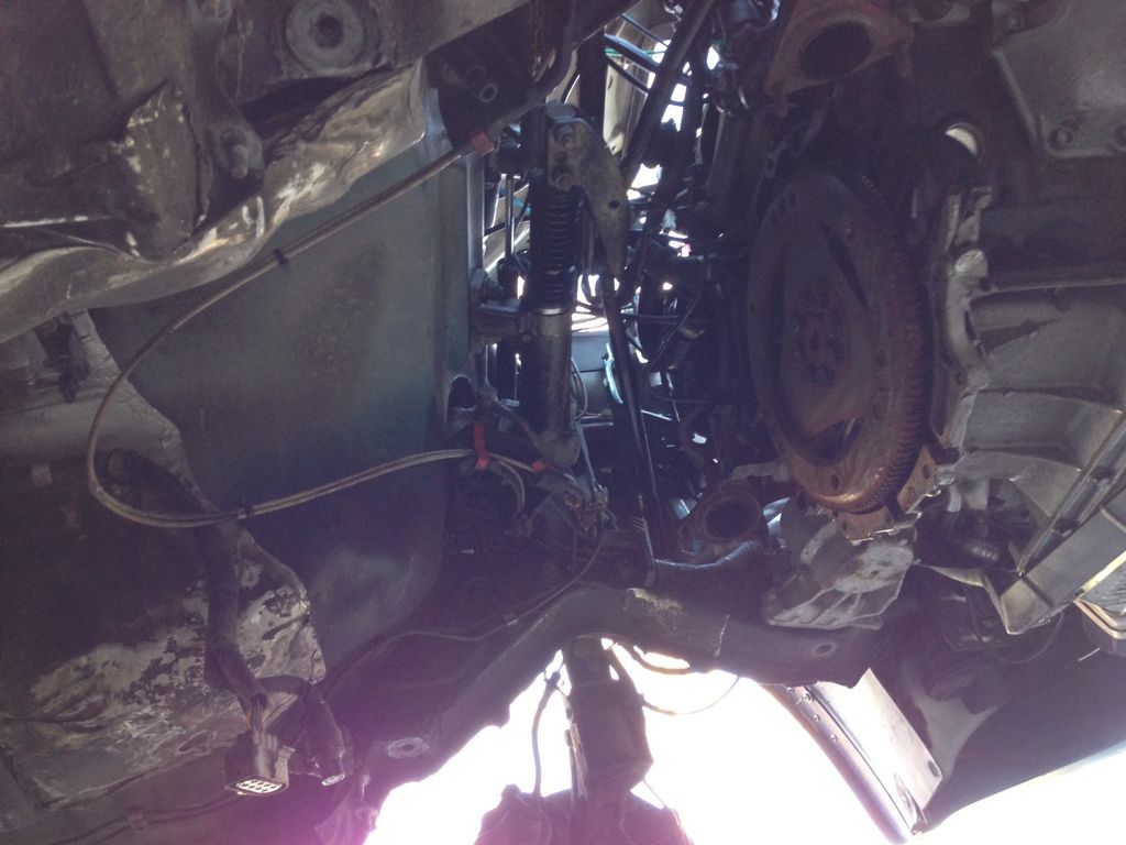

Now with that out and the pedal assembly removed, I have a lot of room underneath...

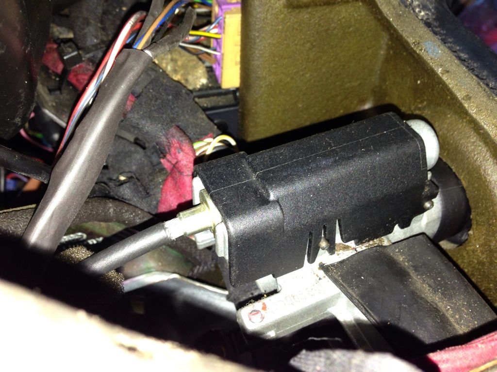

I replaced the O-rings in the cruise control vac switches on the "new" brake/clutch assembly while I had it on the workbench. Also got the MC installed
They appear to be the same assembly although I have always read I needed a manual specific one.

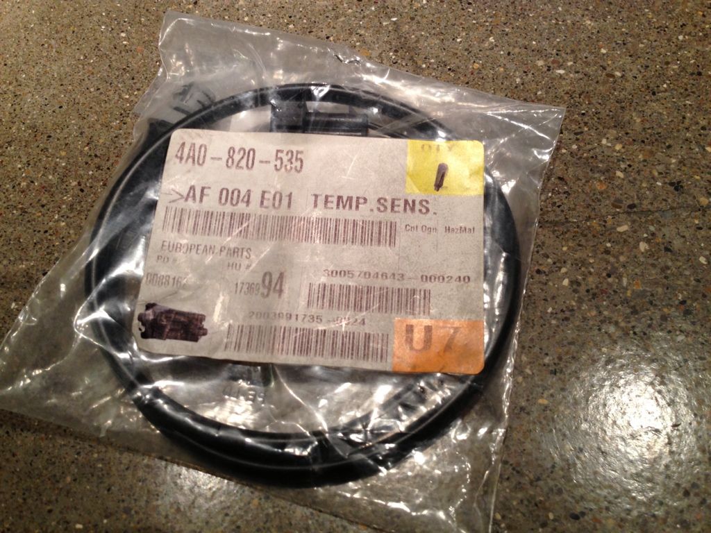

I just placed orders for everything else I need. All the seals I could find on the drawings from ETKA and the Bentley, new bolts for the flywheel and the transmission housing (they're different Auto to Manual) and the clutch Kit. I'm sure I'll find stuff I am missing as I go but I have plenty of time.
The next steps are to jack it up and actually remove the old transmission. then start putting everything back together.
if anyone has any BTDT advise on what I should do to the transmission itself before install I'd appreciate it.

Happy birthday to me! The short throw kit from 034/JHM came today. I have an 034 kit on my S6 and wanted this for the cabriolet.
How much grease (and what sort) should go inside the boot here?
Also, the linkage itself, is there any adjustment or replacement for the bushing here?
Oh yeah, also how is this adjustable?

No grease in the boot. See this for the linkage rebuild
http://forums.audiworld.com/showthread.php?p=18597498
EFI express also sells a solid linkage bushing upgrade.

This was super helpful. Thanks!

It's out!
I was able to get the auto trans out today after quite a bit of work.
Now I realize that I need both mounting brackets
8A0399114
8A0399113B
The ones from the auto are clearly different. Anyone happen to have these lying around?
I got the u joint refreshed thanks to yodasfro and the above link, and all the cv boots replaced and repacked.
The clutch kit showed up this week and I ended up finding a new audi oem dual mass flywheel on Craigslist for $100
Here's what is going back in:

Made some progress today...
The new pedal cluster is in, as is the clutch MC and 034 short shift kit
I learned a couple years ago that the easiest way to get to the lunch MC is to take out the brake booster. It's now back in too.

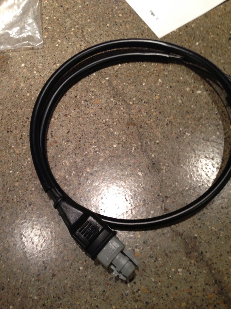

Got the right grommet for the firewall and put the wires from the outside temp sensor through it too...
Also got rid of the lock cable tha makes you be in "Park" before you can take the key out...
This side is attached to the shift lever on the auto
The other end attaches right above the ignition switch (seen here from an angle only an iPhone can see)
The top pops off...
To reveal this...
Which pops straight up once the clips are taken off.
Now the key comes right out!
