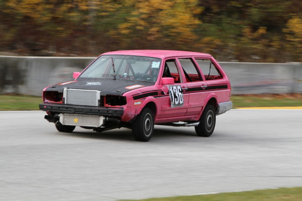

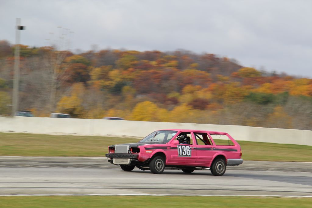

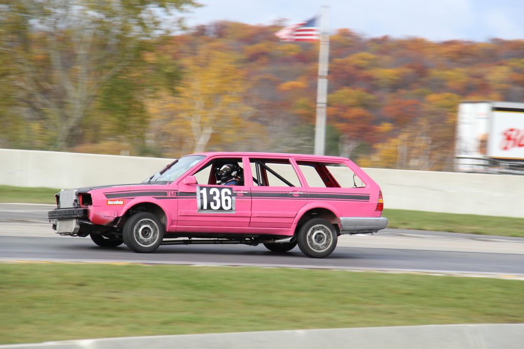

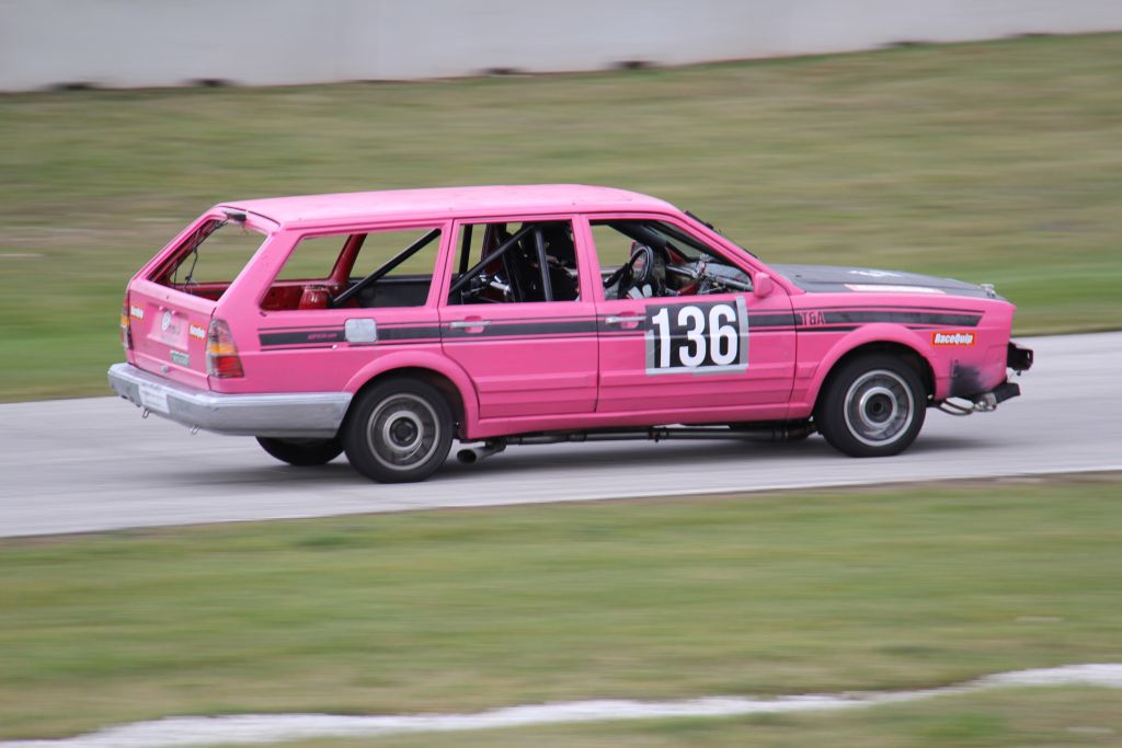

Alright kids, its been about a week since the race and I promised I would circle back and give some updates!
The good:
-We finished! Not only did we finish without blowing up, but we managed P16 overall and P4 in class (out of 75 cars)
-Our best lap time around Road America was 3:12:xx. Easily one of the top 10 fastest cars. Based on my internet research, this is about the time a stock Subaru STI would run.
-226 laps completed in 14.5 hours, for a grand total of over 915 race miles
-diff locks!! OMG!! more on this in a minute
-034 street density motor and trans mounts worked GREAT! we ran without a snub mount (mostly due to huge radiator and intercooler) and had about 1/2" of clearance between the crank pulley and intercooler. Engine didn't budge at all.
The bad:
-I put the car 4 wheels off on the first lap. I blame wet track, cold tires, and all the other lame excuses you can think of.
-We use a lot more fuel with the AAN than the JT. 18.5 gallons used to last us 3h15m (LONG stints) and now we are refueling every 2h-2h15m
-Invisible wall of power loss at high RPM. What RPM? I have no clue- the only instruments we had working were the alternator indicator light and hazard lights (-: Speedo? Nah. Tach? Unlikely. Fuel gauge? Who needs one. Oil & water temp? What kind of luxurious world do YOU live in. Boost gauge? YEAH RIGHT!
-This car DESTROYS the front driver's tire in about 7 hours. Worn to the belts from new kind of destruction. We're running about -3/4* negative camber on each side and neutral-ish toe. NEED MOAR CAMBER
-034 LWFW didn't arrive on time to make it onto the car
The ugly:
-That exhaust I fabbed up in the last 24h before the race hung hella low. Thankfully, it only fell off once during the race, costing us about 15 minutes of track time

Nice pics, car looks good. I like the theme! Bummer to hear your race was canceled; our COTA race is scheduled for late June and we are currently holding out hope that it will continue.
Do you run 4x100 or 4x108 wheels? I like those rims; we've struggled keeping good sets of 15x7" 4x108 rims.
Cheers, Eric

love the rear plate area message

@ejfluhr - thanks! not bad for having sat outside for 2 years, eh?? :) we run 4x100 since that's what the QSW came with stock. these are Kosei K1s in +25 offset (BMW E30 fitment)- they're relatively light, strong, & "cheap" plus they're readily available from tire rack !
@88a5tq - thanks! I can't take credit for any of the decorations, but the first time this car raced under its new owner (Oct 2016) is when the car's theme (Quantum Leap + Idiocracy) involved an alternative parallel universe where Trump became president.... if only we had known then! :frustrated: I plan on adding some Hardees and Brawndo decals before it is raced again.
other thoughts: car drives well, but as I mentioned the gearing is wayyy too short. car is gear limited to 118mph at approximately 7500 RPM. while 118mph is plenty fast, you're literally driving between 4000RPM-8K all the time. I have an 01e out of a UrS4 but that's not a bolt in affair by any means, and think I would be best sourcing a 200 Avant 016. anyone have any thoughts?
