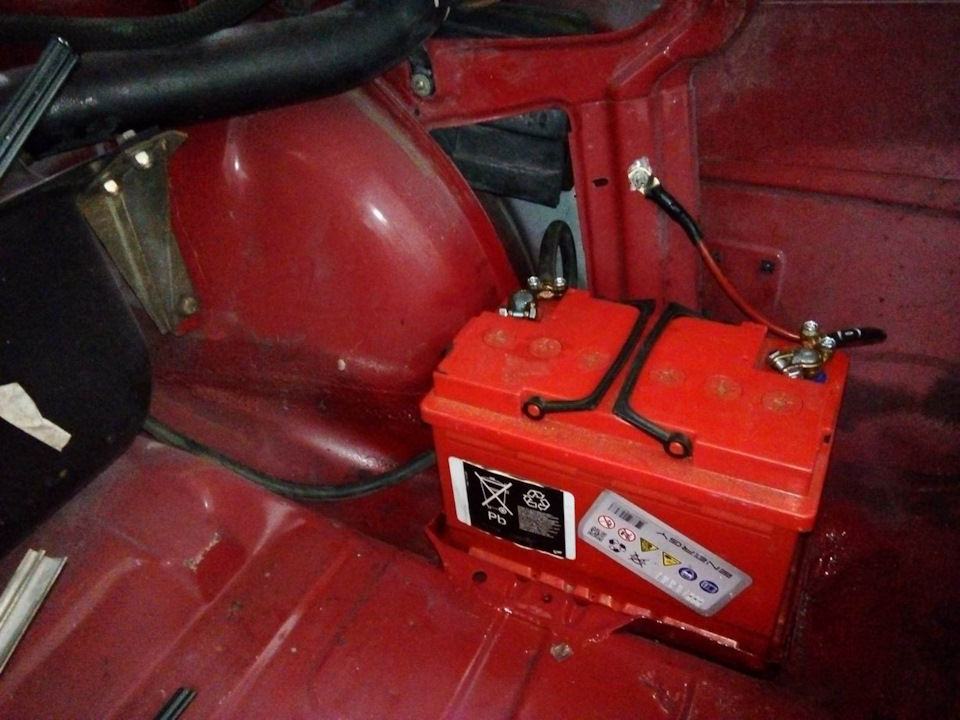

the battery was transferred to the trunk

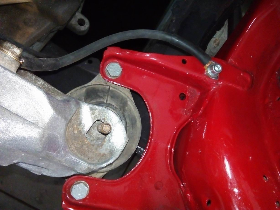

After the bottom I took up the suspension, everything was disassembled and sent for sandblasting and painting
All consumables are new, the body is on wheels

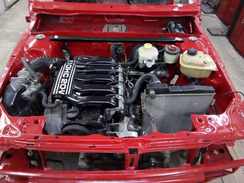

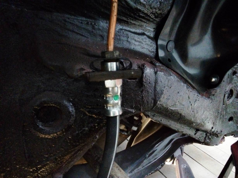

The assembly began with the laying of fuel and brake lines
The pump suspension with filter is used from b3, because there was no native as well as fasteners on the body
Everything is ready to put the motor.
The state looks so-so, I decided to disassemble it before installation, and for good reason
inside the oil turned into something incomprehensible
As a result, I completely disassembled
New liners ring gaskets
Collected and installed under the hood

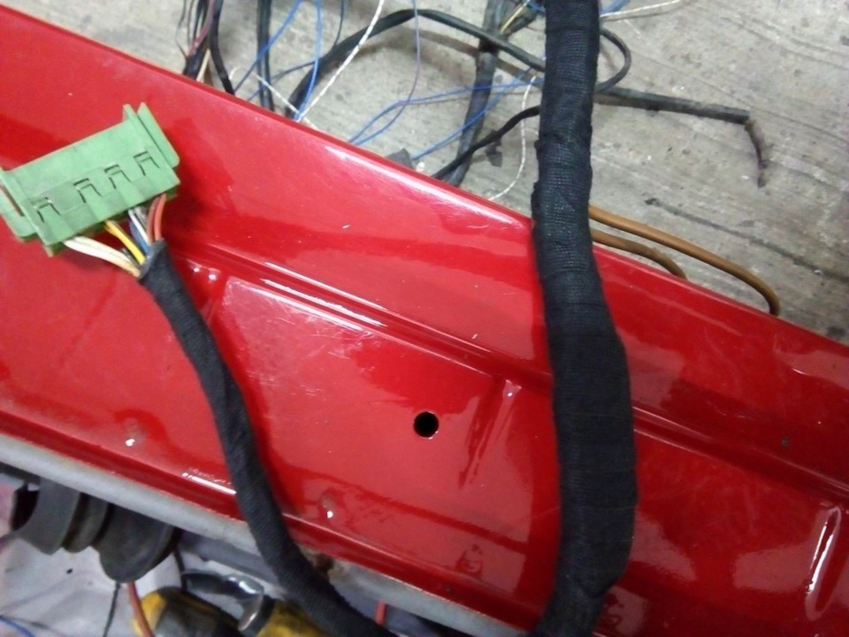

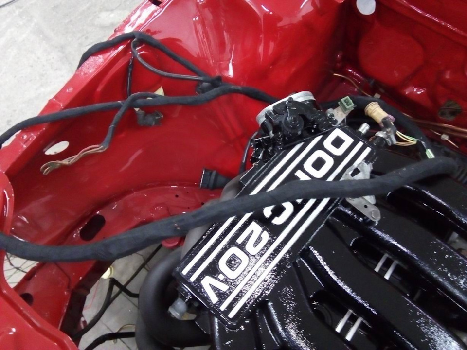

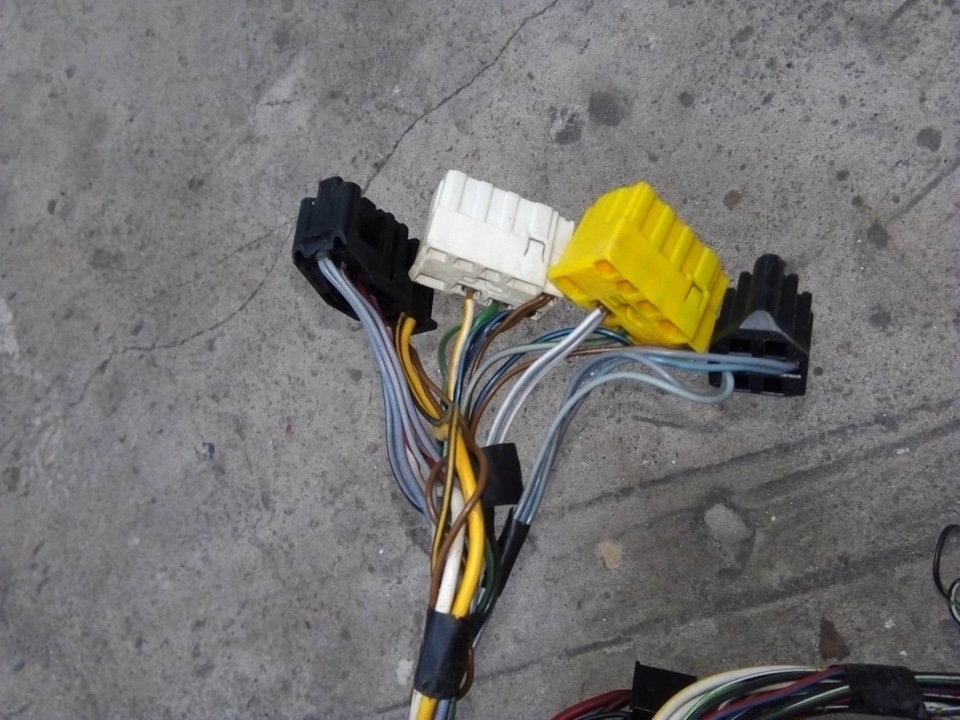

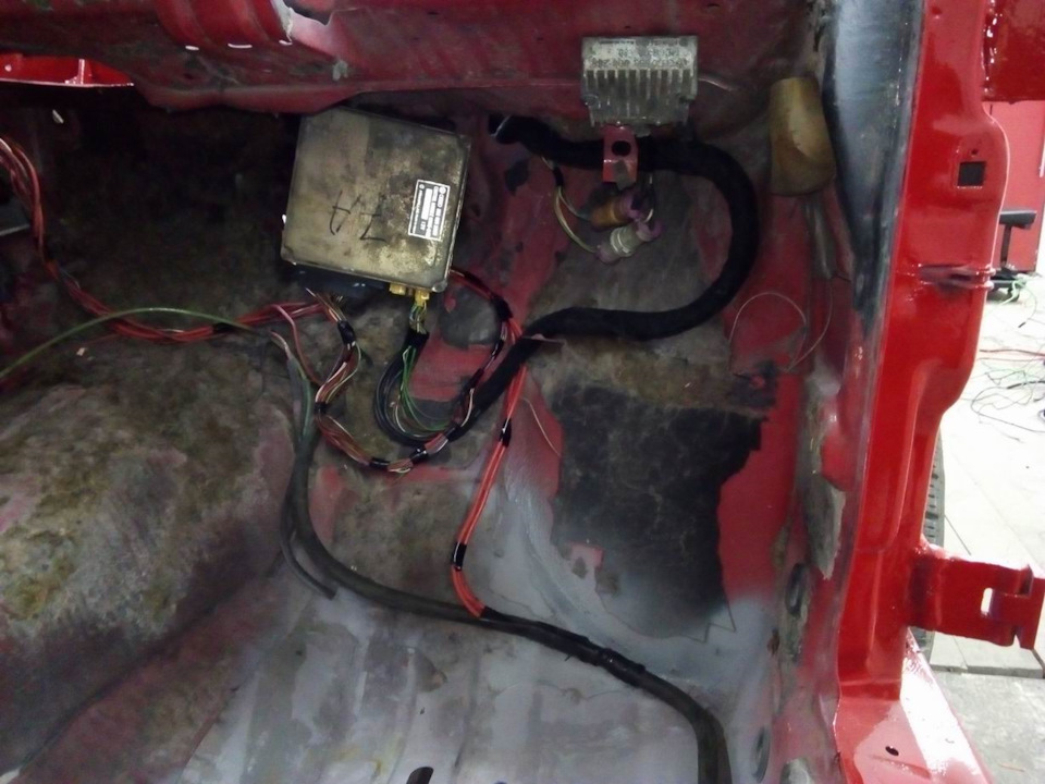

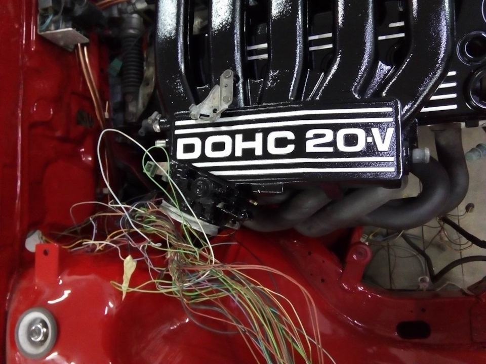

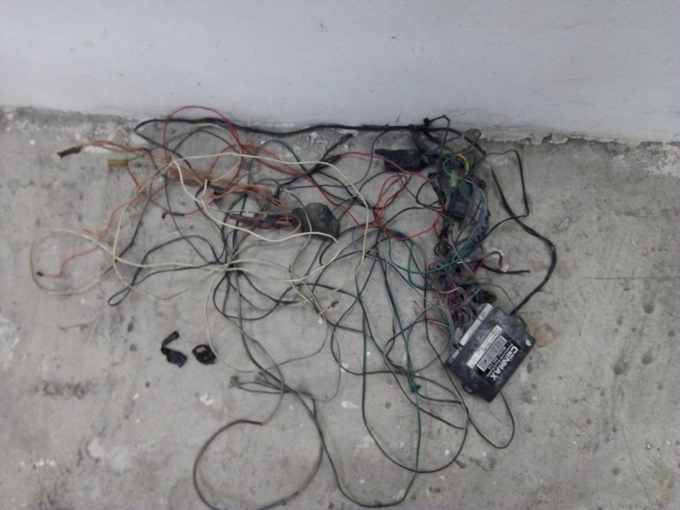

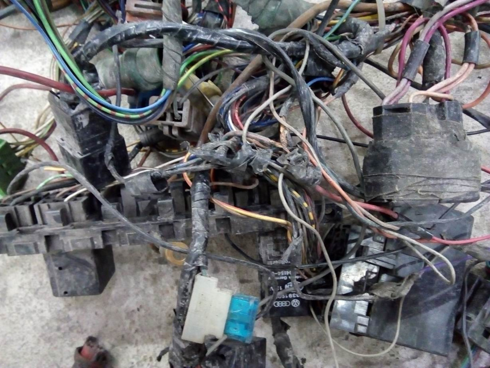

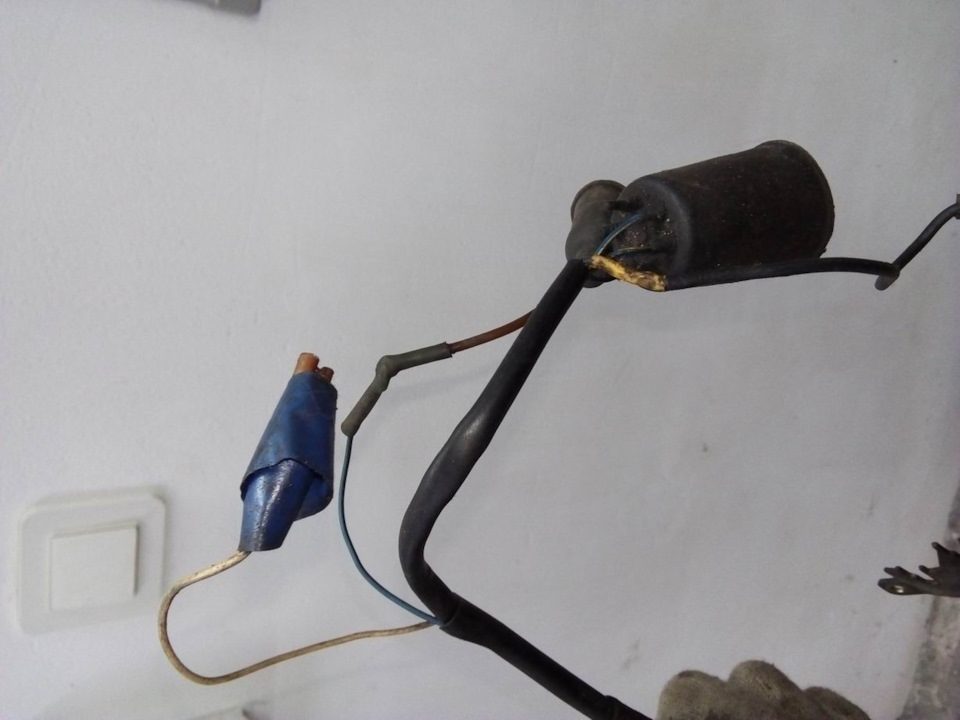

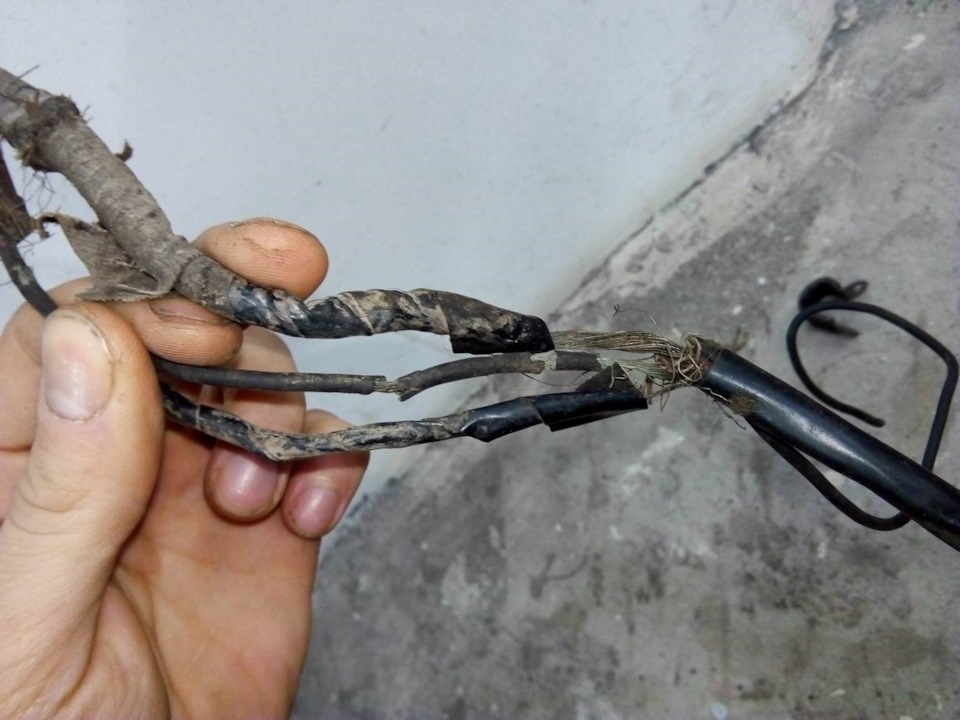

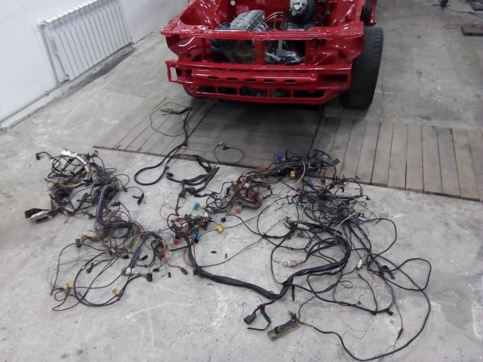

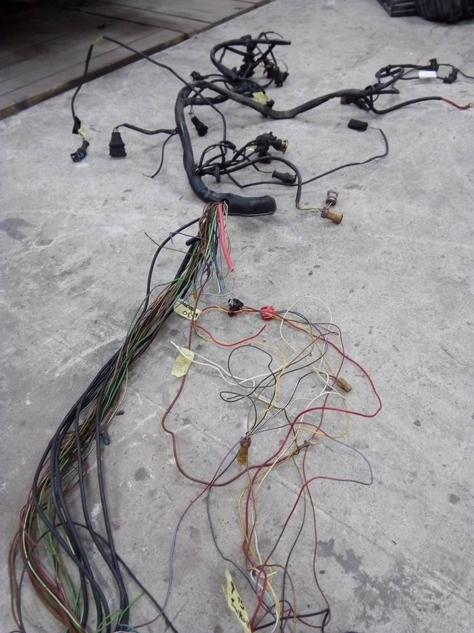

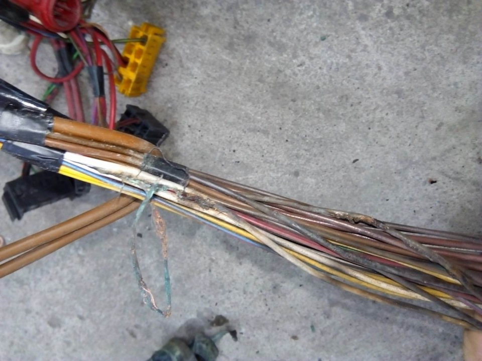

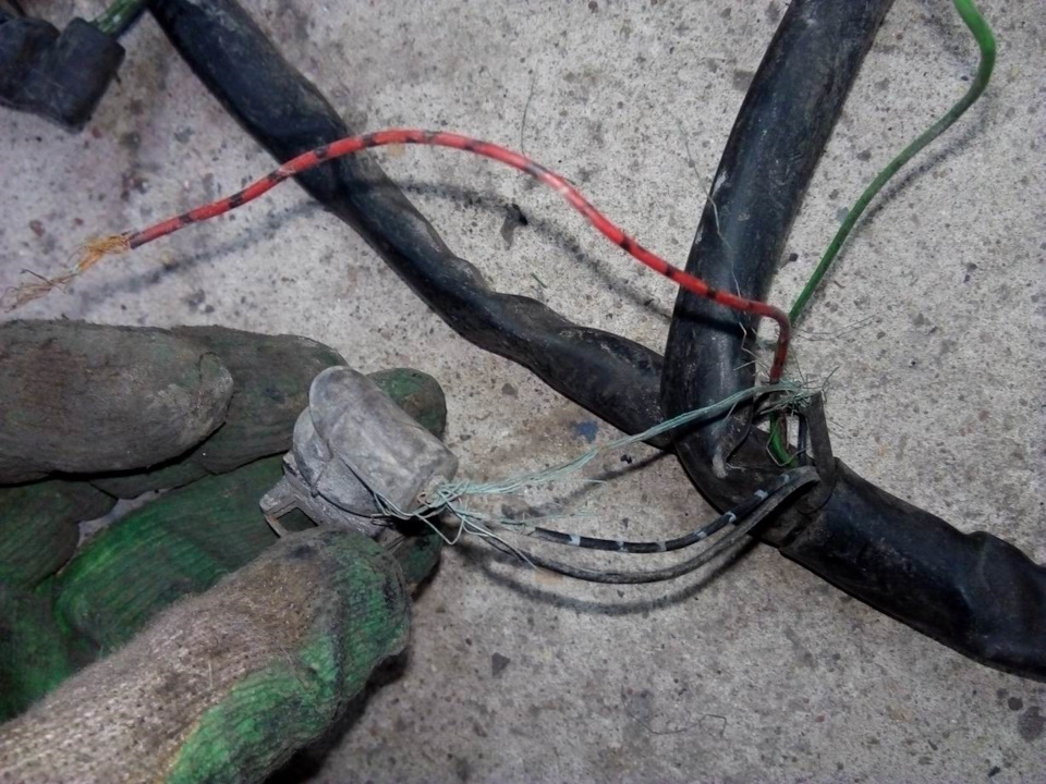

Today we will talk about wiring.

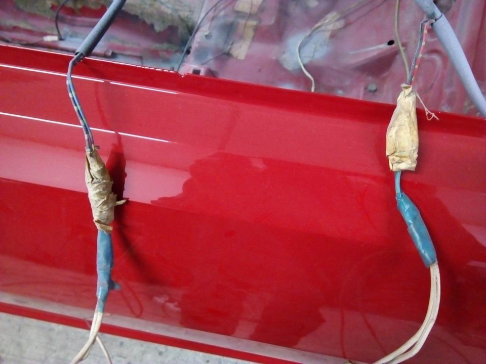

In 90% of cases in old cars, it requires repair, after the intervention of music installers, alarms, under the hood, the wires crack from temperature and the ends break off.
Now there will be photos not for the faint of heart)
We managed to get the harness on the buttons in good condition
This heap of wires, extra, from alarms, music and other incomprehensible things

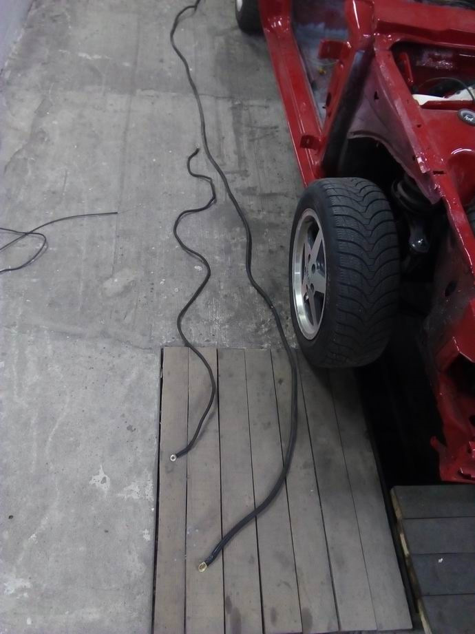

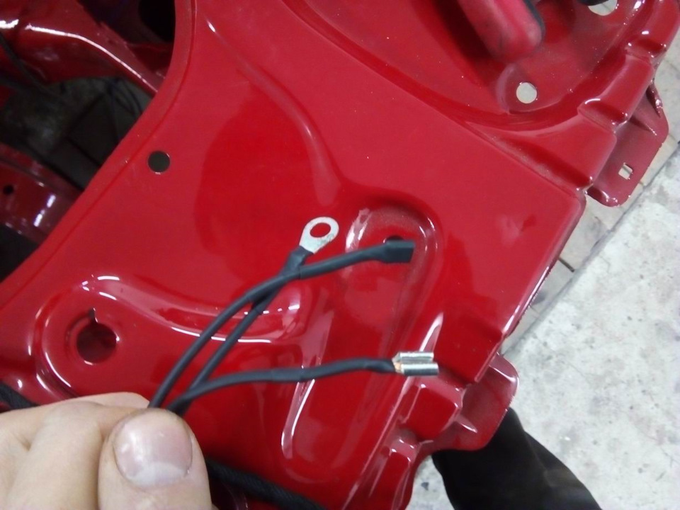

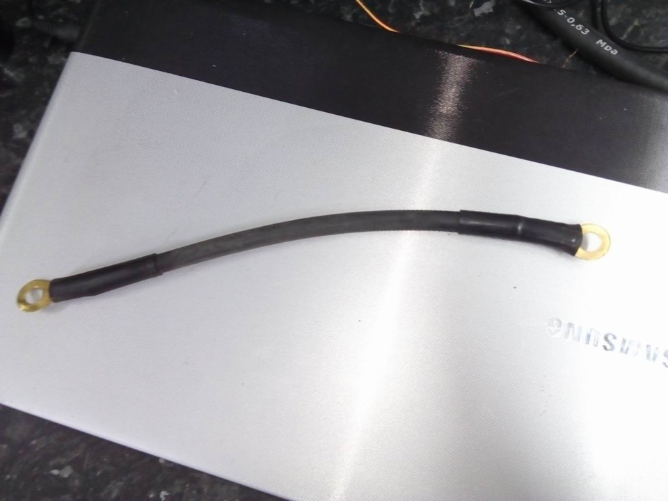

First of all, power wires are laid on the battery in the trunk, starter and generator
grounding

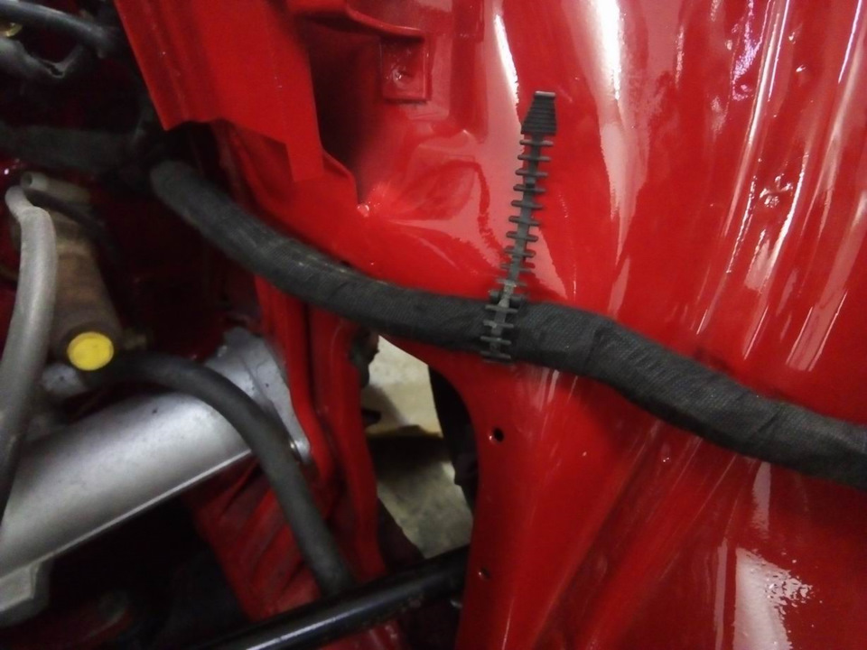

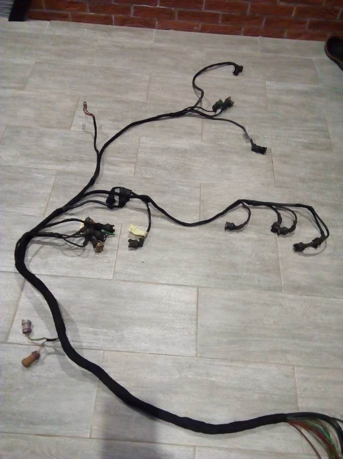

Made a new harness for sensors for tidy, and Headlights, gearbox
Further wiring to the engine. since it is from an audi 90 b3, then I had to unwind the harness, remove or add wires and rewind
ECU installed under the feet of the passenger
After I collected the engine compartment

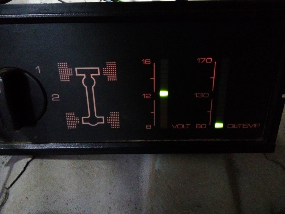

Checking all systems

 Post subject: Re: Audi Coupe Quattro 1985 real_customs build
PostPosted: Wed Dec 23, 2020 6:11 pm
Joined: Wed Jan 07, 2004 2:26 pm
Posts: 11658
Location: Findlay, Ohio
I take it you re-wrapped the harnesses after you stripped them down with the cloth/friction tape? Looks nice and factory.
http://coupe.gofergusons.org
'13 Q7 TDI
'07 Q7 3.6
'90 CQ 32v
'90 CQ 0v
PostPosted: Thu Dec 24, 2020 8:55 am
Joined: Thu Aug 27, 2020 10:14 am
Posts: 38
yes, I removed the factory braid, I had to take out extra wires or add somewhere, and then I rewound everything

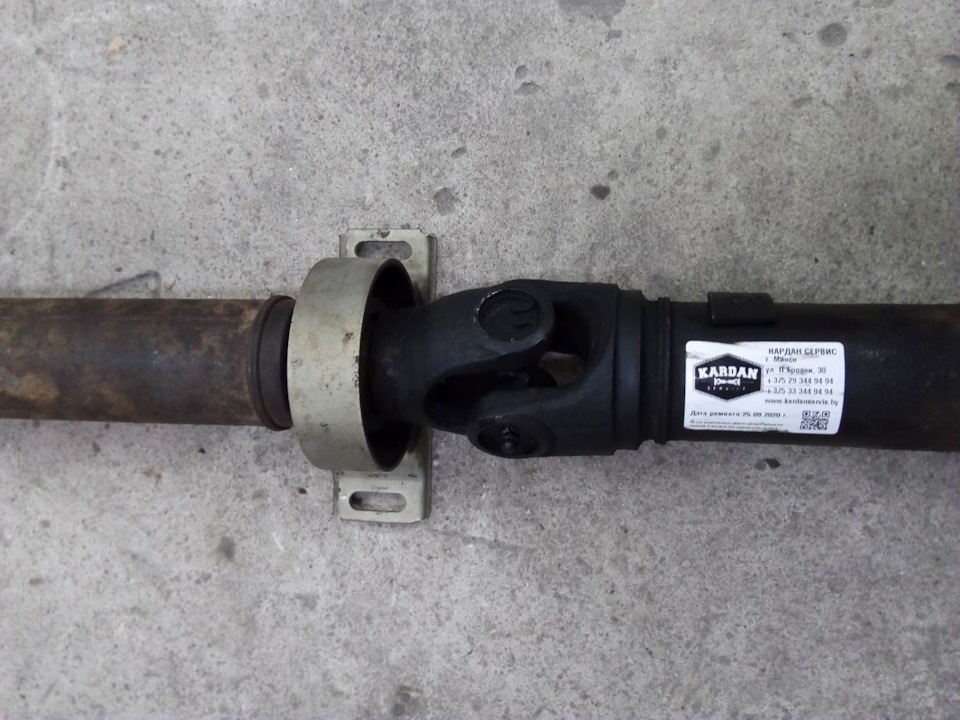

The longest part of the work is assembly, search or manufacture of fasteners, spare parts, etc.

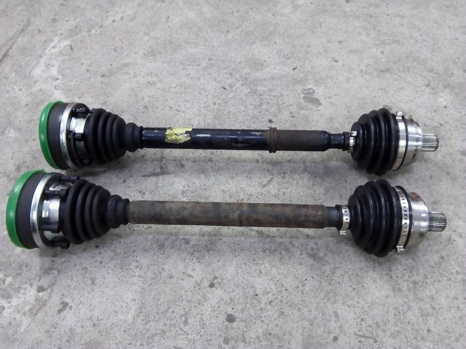

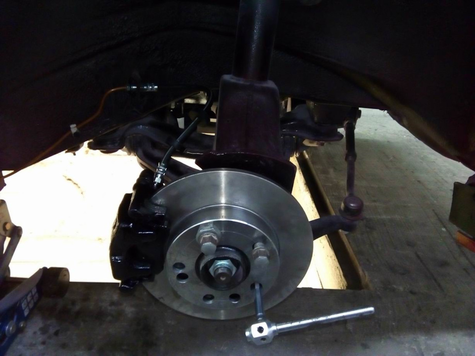

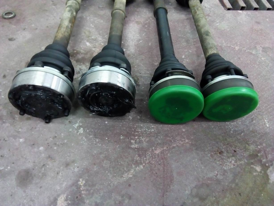

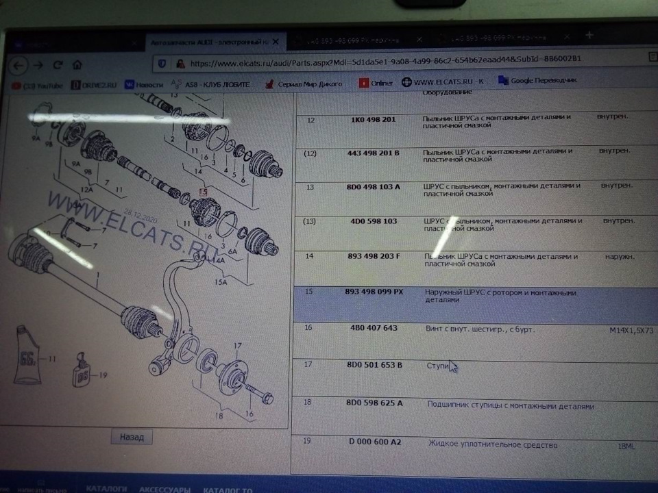

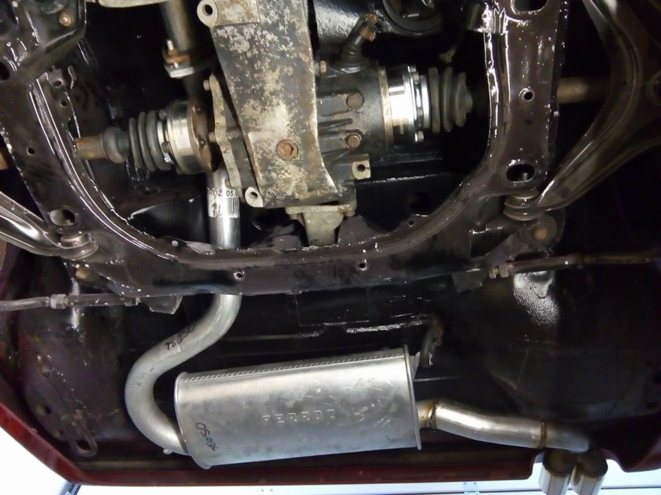

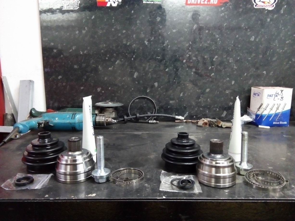

Drive, there was a replacement of all CV joints and cardan repair
Everything went smoothly at the back, but the front hubs from a4b5 and the shruz ordered from a4b5 did not climb there for some reason, just like the front one from b3 5cyl, as a result, it was possible to pick up by typing, the front one came from b3 4cyl without abs.
Along the way, the oil in the gearbox and gearbox was changed to GL-5 synthetics

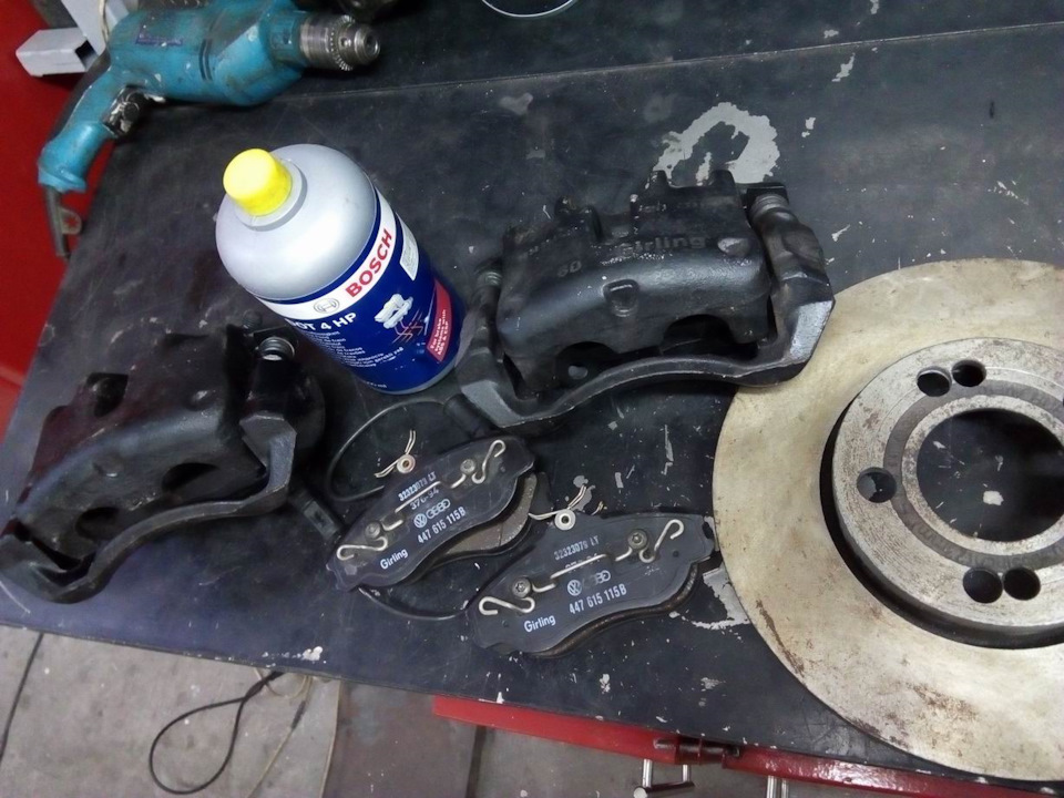

Set the brakes by re-drilling the stock discs for 5 bolts

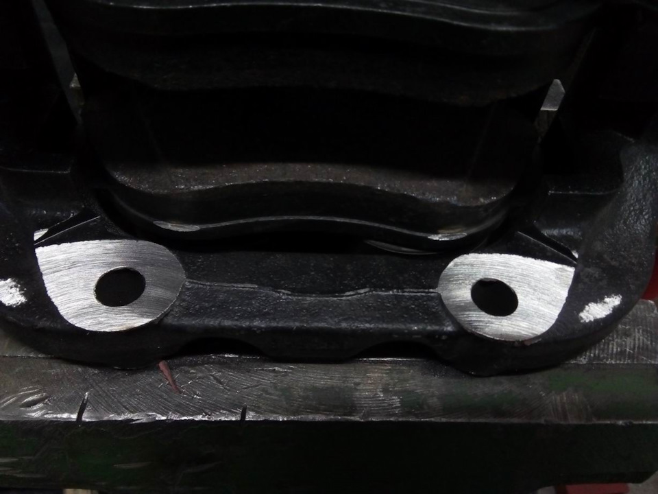

the caliper had to be sharpened in front, so that it would become exactly on the disk, perhaps because of a non-native hub
New hoses and boots for steering rods

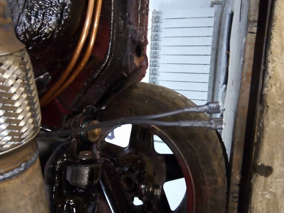

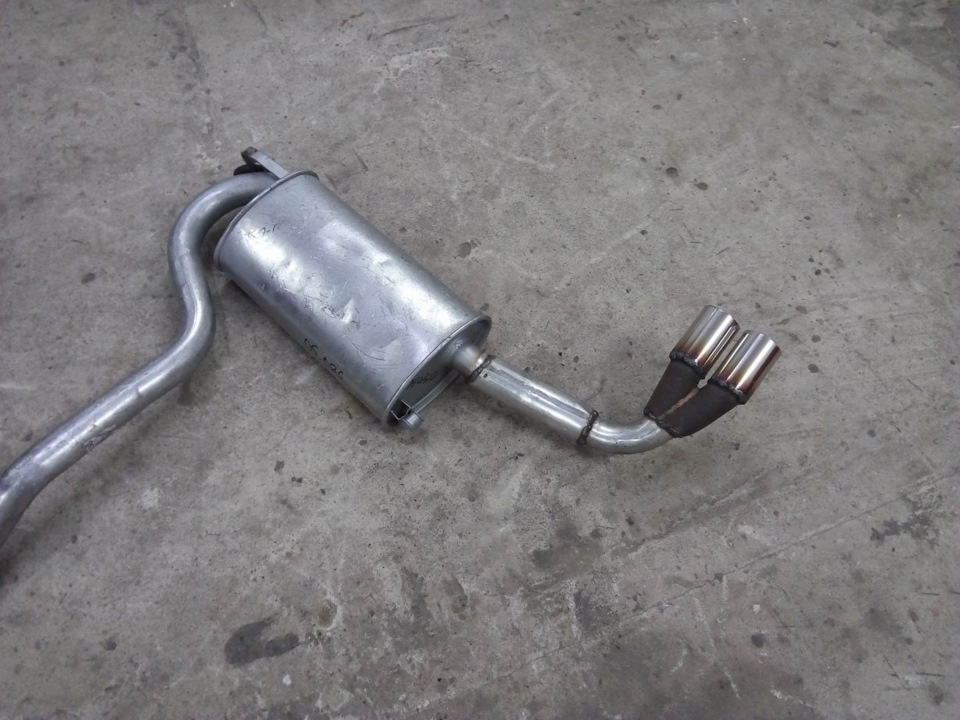

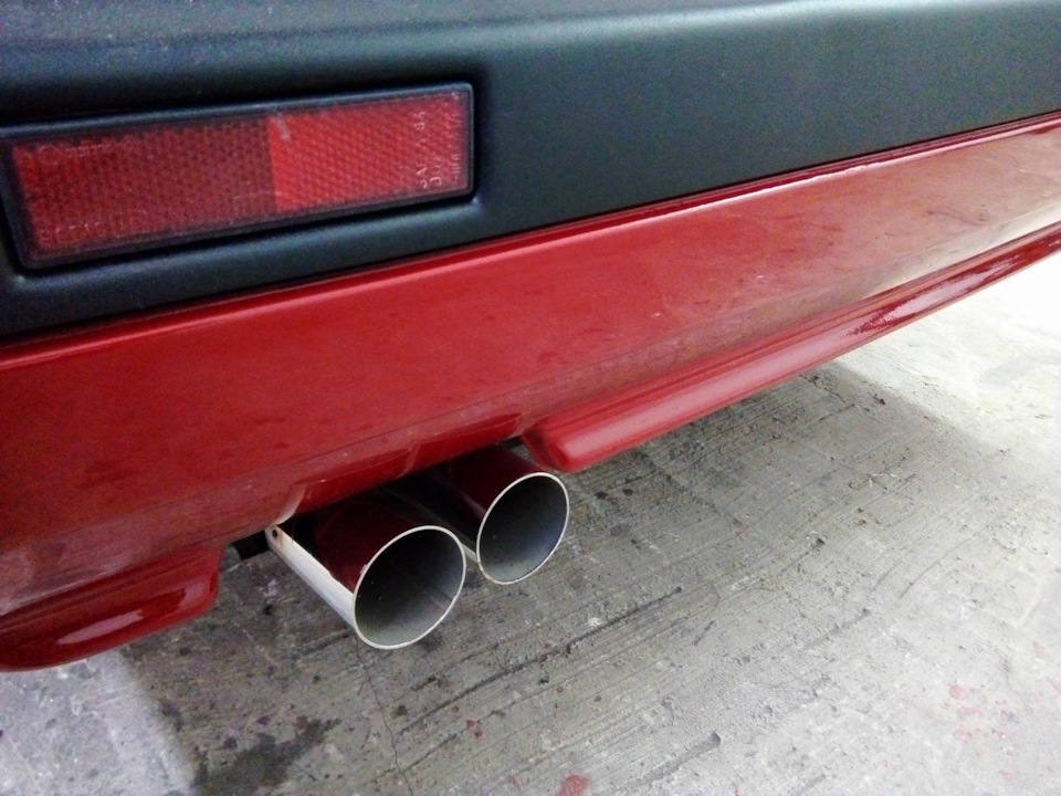

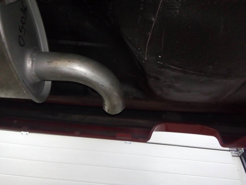

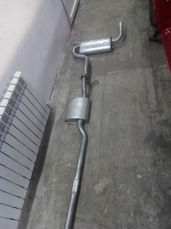

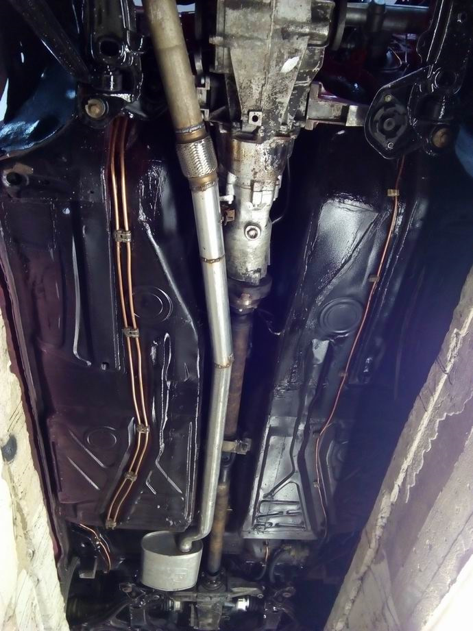

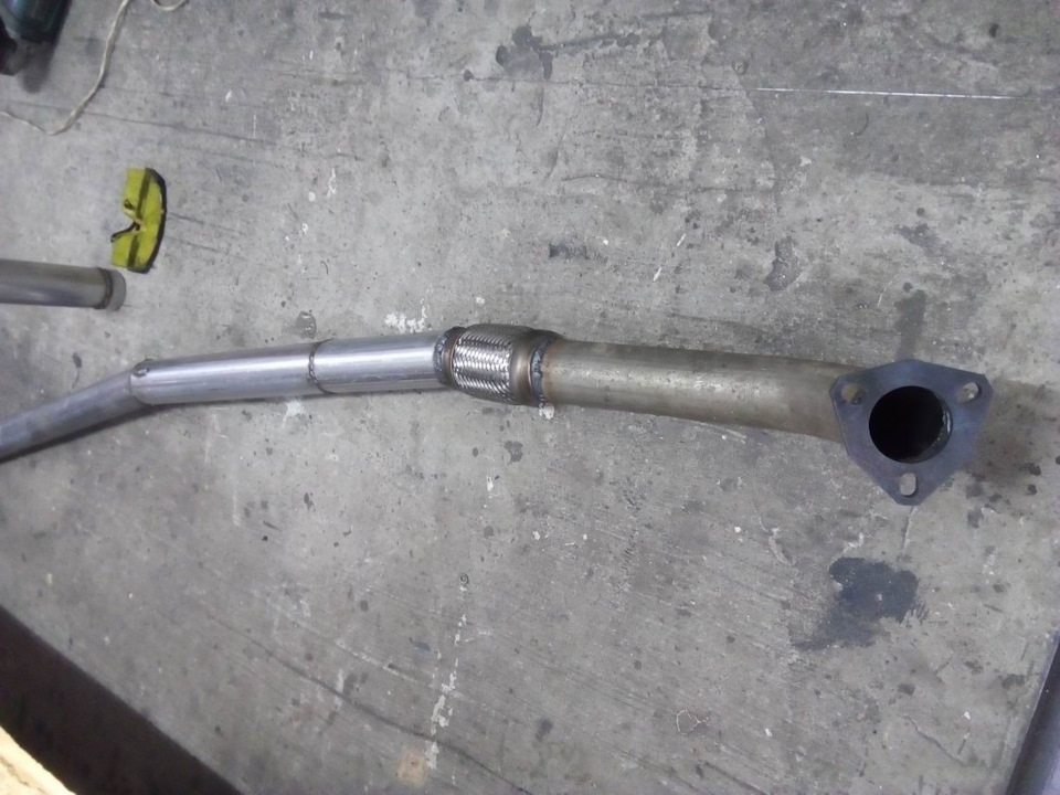

The exhaust for the 80 quattro is only from the b3 body, so I had to modify
at the end I welded stainless steel nozzles, made a swing like a drain

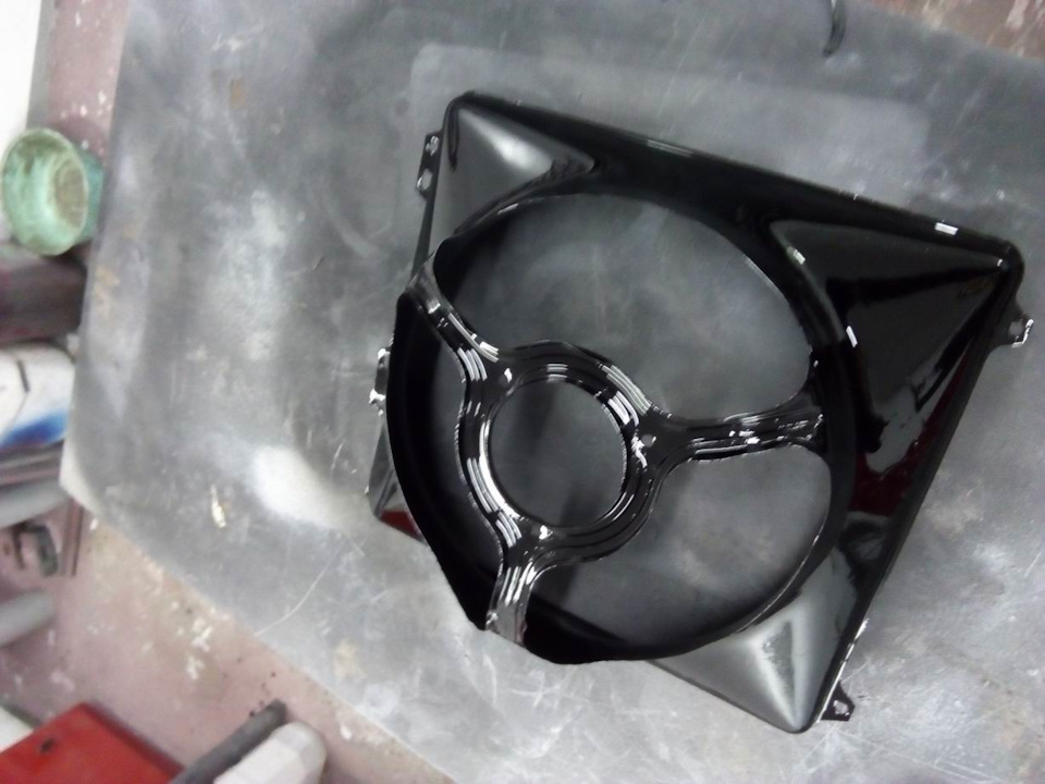

Painting of installed elements

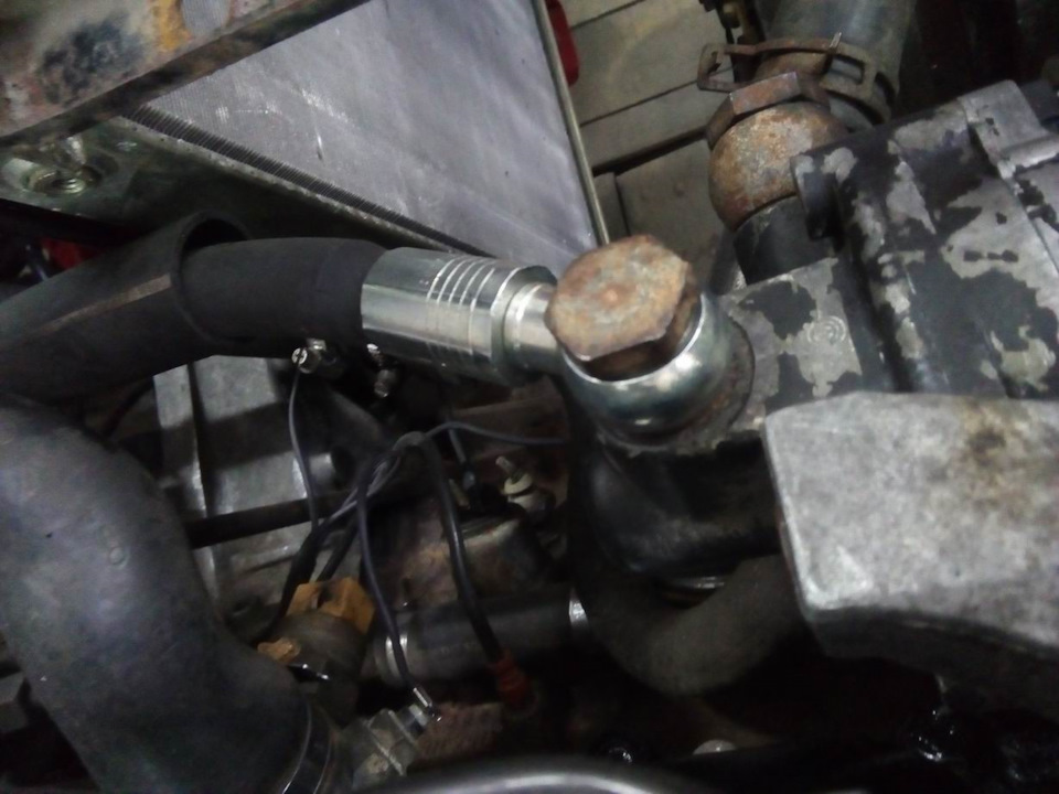

The power steering from the 7a motor has a circuit for the brakes, so I took out a plunger and made a new hose to the rail

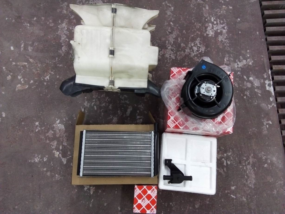

Stove, all elements are new, on top and inside, new seals
