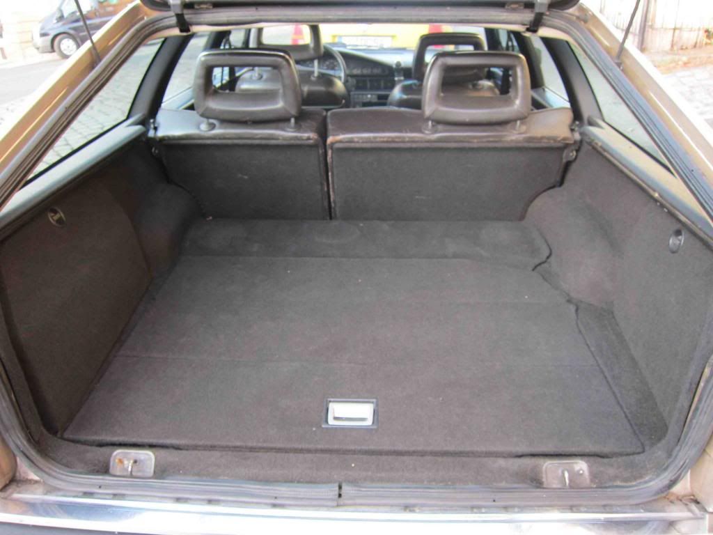

In addition to my 1984 4000 S turbo quattro I bought a 1985 5000 S Avant in very good condition. It should become my daily driver...just for fun. For reaching my daily driver specs it has a quite cool option...the TDI conversion.
Engine is based on an Audi 80 B4 TDI - 1Z - 66kW/90HP...and its equipped with another Bosch fuel pump (P/N: 0460424124). It runs very good. Have to go on a dyno in near future. These days I´m into re-installing US-lights at the golden beauty. Taillights are installed...sidemarkers arrived from California. :)
Some impressions...

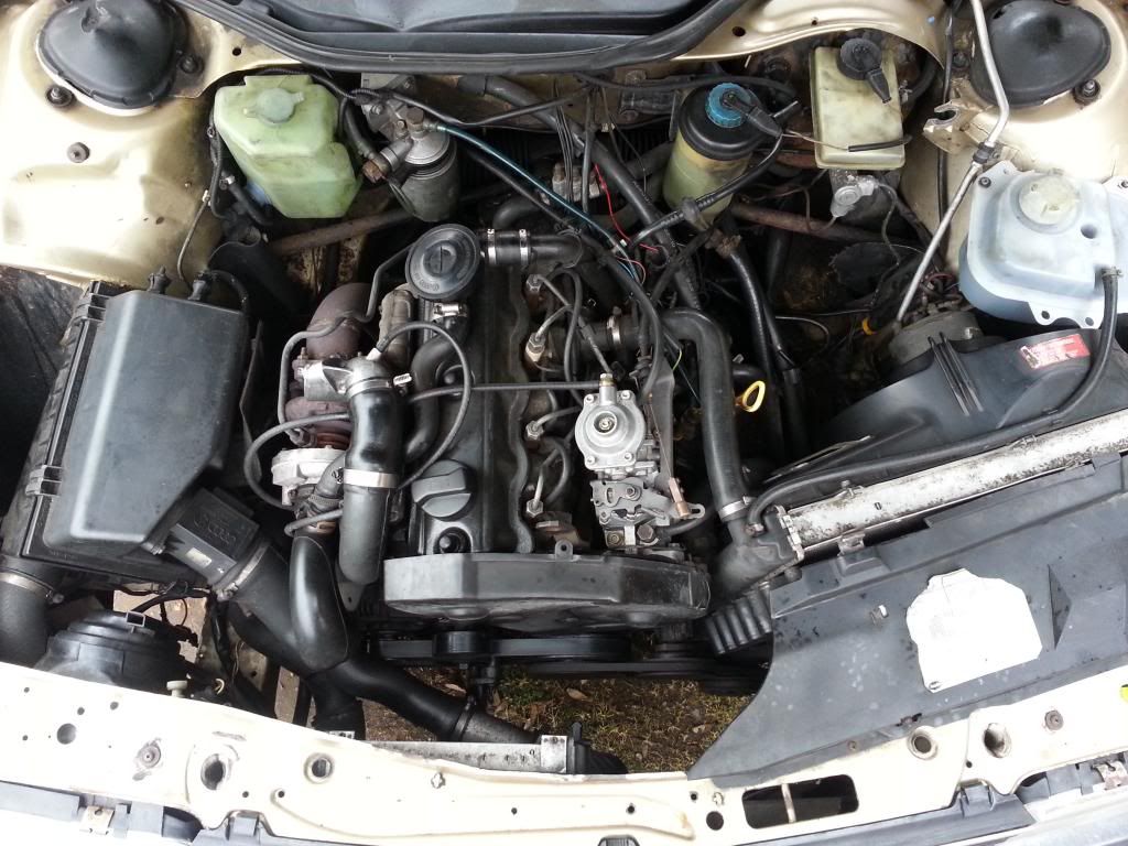

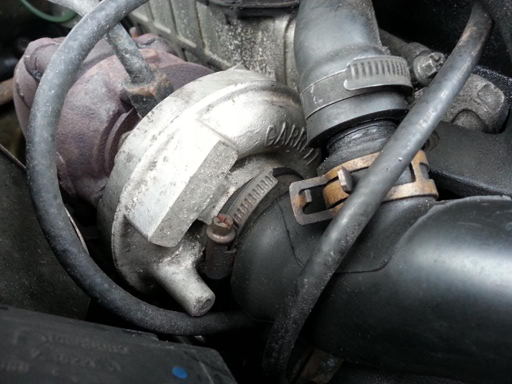

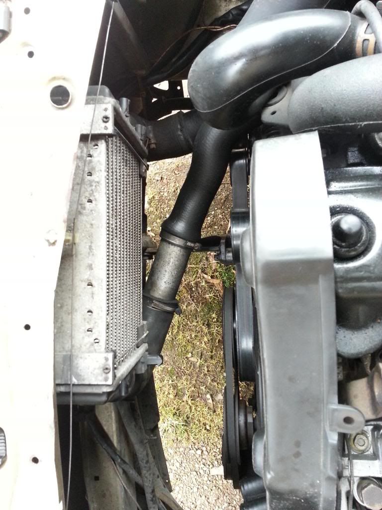

Some additional pics of the golden engine bay...
Intercooler should be from a Passat/A4/A6-installation...turbocharger seems to be the original one.
I´ll arrange some instruments like boost gauge and manifold air temperature, etc and then I´ll decide for possible improvement with some other parts.

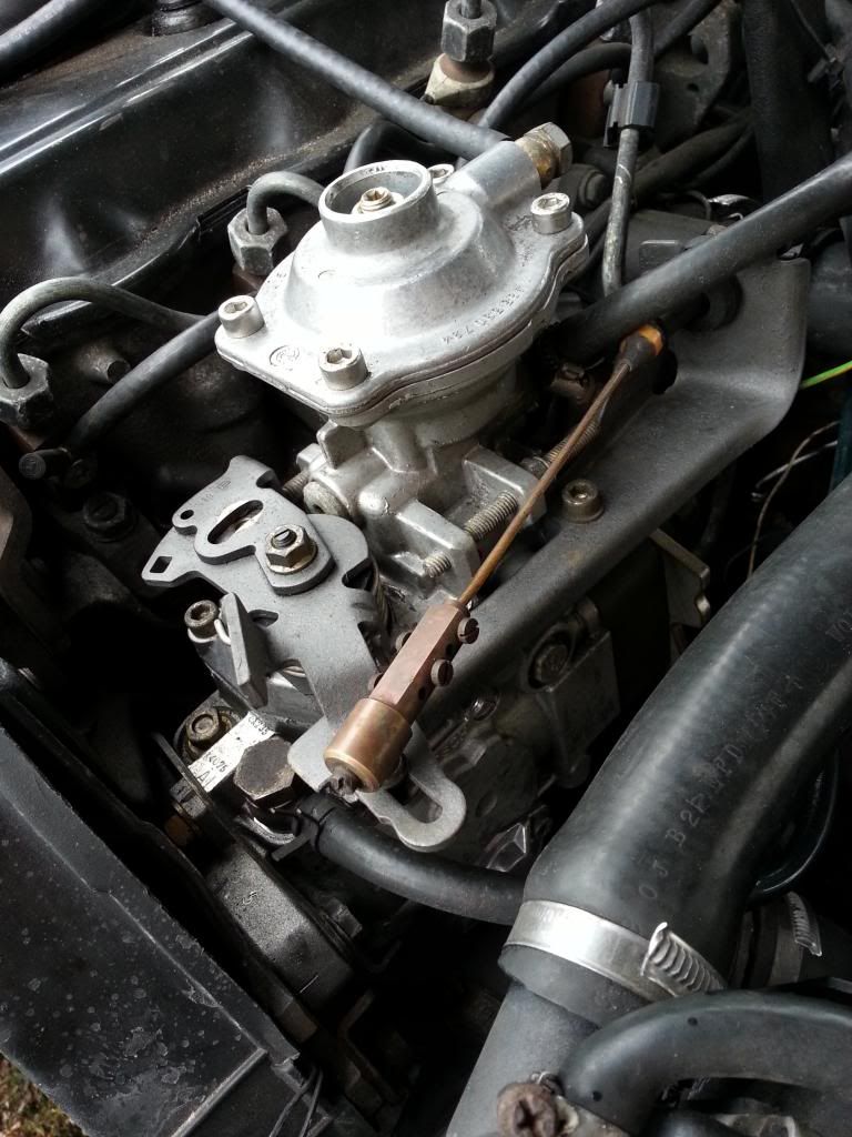

I´ve had some free time at the weekend and got a bit more into rear axle issues. During buying the 5000 I recognized the new suspension at the rear axle. With a bit more investigation I found out that the shocks are adjustable in height. I chose the lowest setup... ;-)
Does anybody know those spacers above the springs? Are they original or some aftermarket stuff?

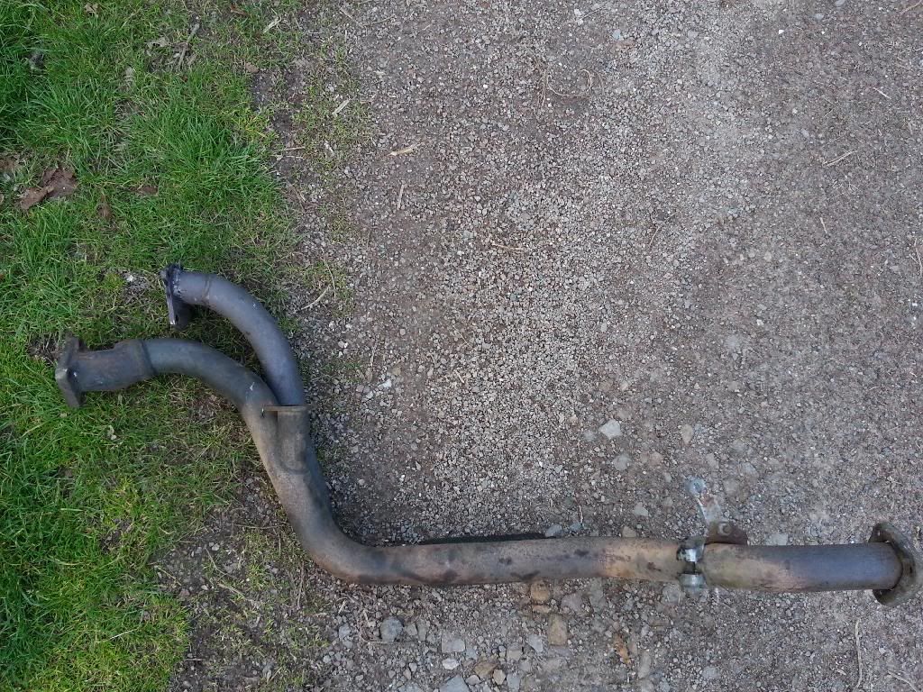

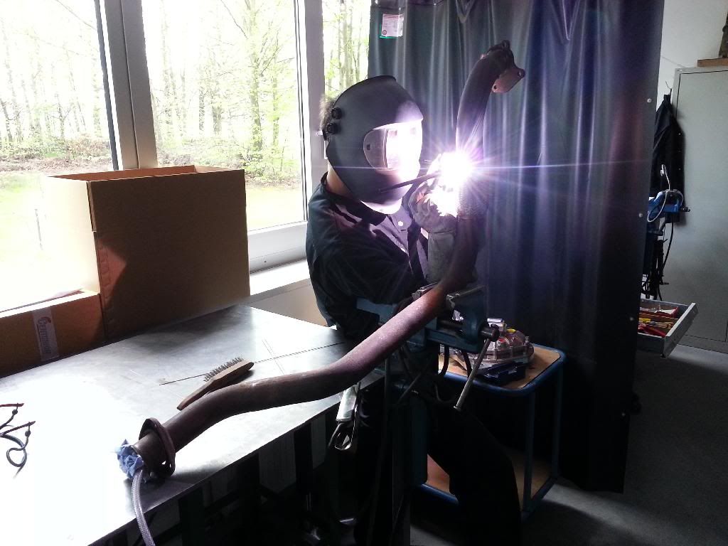

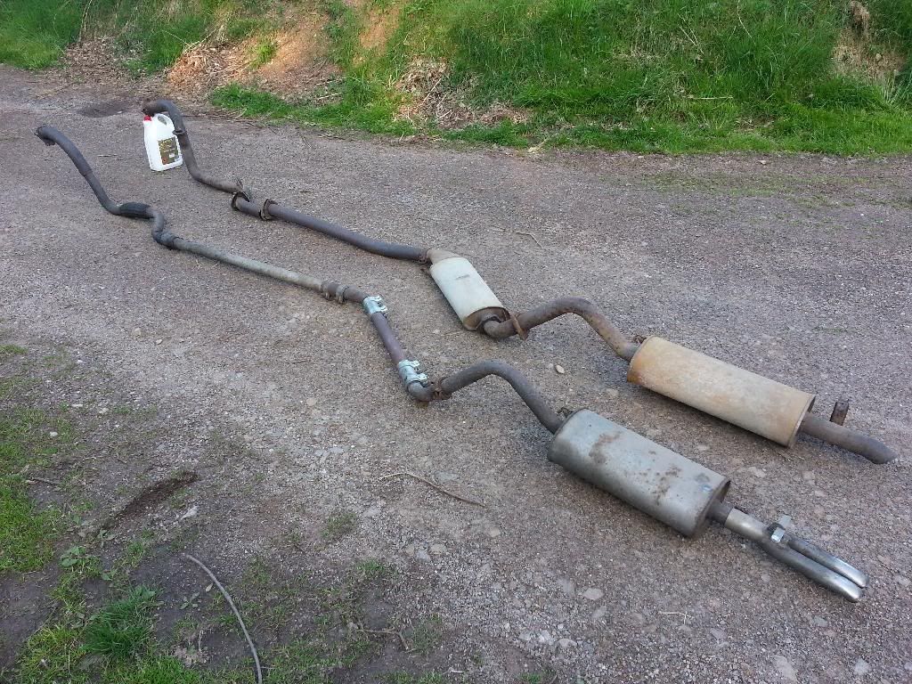

I enjoy cruising with the golden Lady. Did some calculations regarding the fuel consumption. I´m at approximately 5.9l/100km which is 50mpg. This value includes absolutely no "driving carefully"...but it includes rather "having a lot of fun - leaving smoke at the streets". :)

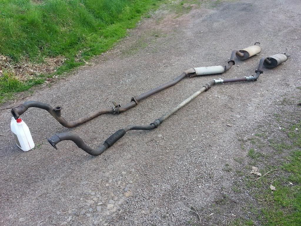

Improving the System is always the main issue and therefore i exchanged the exhaust System.
Left one is the old 50mm suuuper-custom-exhaust-whatever ;)
Right one is the good old 60mm exhaust-system from my 10VT-donator...a 1984 Audi 200 Turbo. We just modified the downpipe in that way, that the exhaust gases will be guided from TDI-Turbo straight to the lower part of the old 10VT-downpipe. I´m looking forward hearing it. If there is some spare time, I´ll modify or remove the last muffler. We´ll see...
In Addition I installed a proper air filter. The unused space will be used by the new full-aluminium-intercooler which ensures a very short piping.
