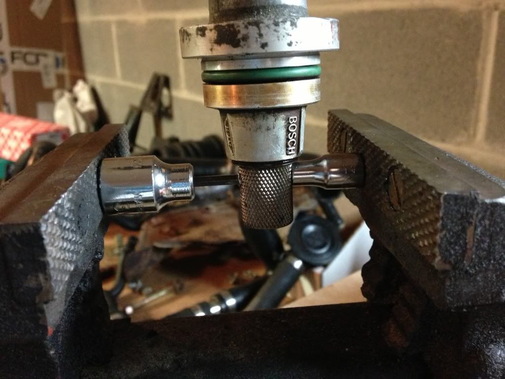

I went through the same shenanigans last summer. I ended up grinding the pin down as suggested, and pressing the pin out with a vice and a couple junk sockets. (3 mm allen on the pressing side, and a 5 mm 1/4 drive on the opposite side). I too used a hardware store roll pin, which I ground to the same length as the gear diameter. Worked great!
